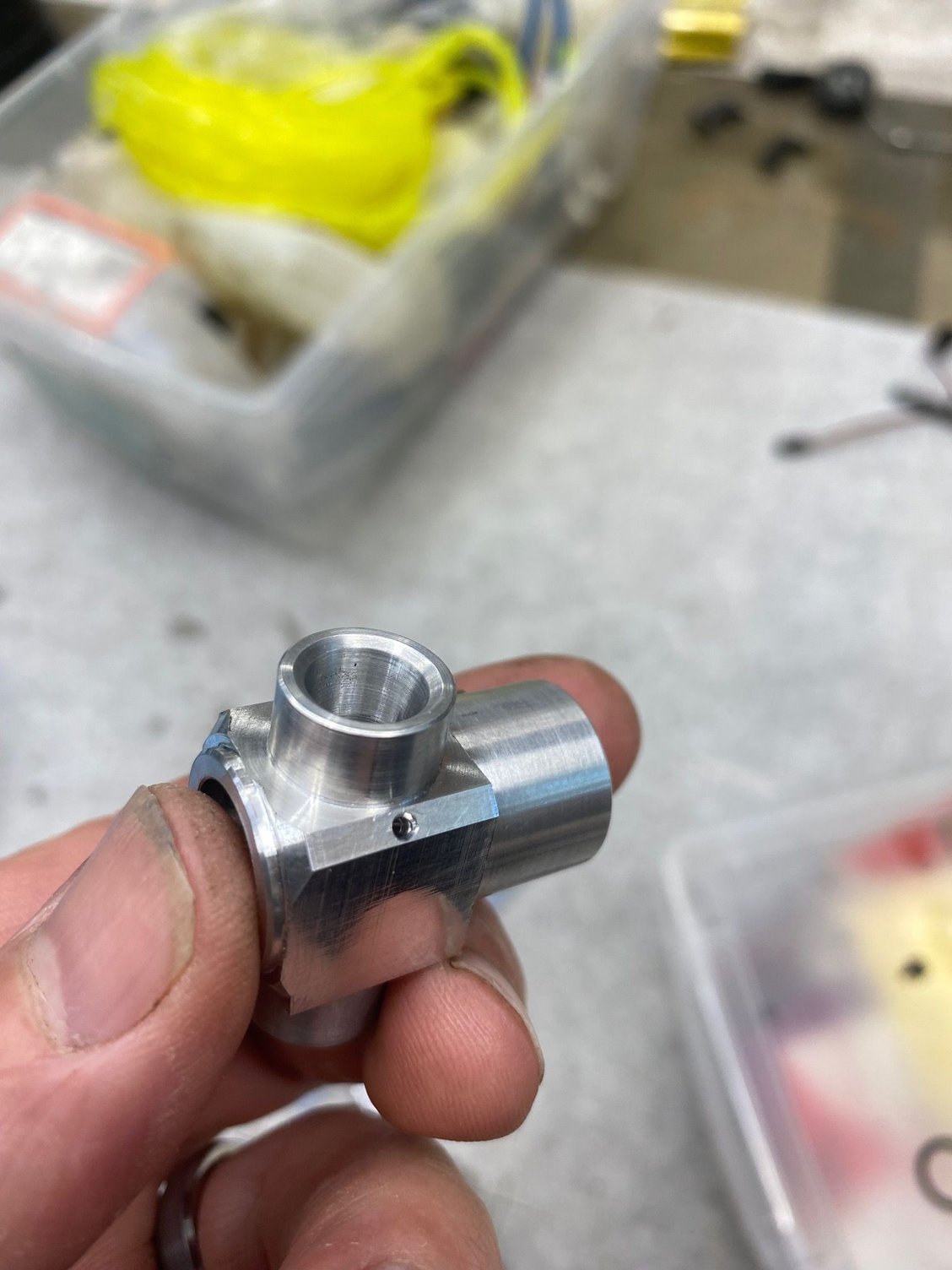

Originally Posted by Rob.m
Cat 1 am currently your solenoid carb an making the drawing. Have you made any changes to this in the meantime to make the engine run better?
Rob
Rob,
the only changes I have made are I added an air bleed to get the idle solenoid setting a bit higher up on the curve. And I also added a "heat isolator" made out of Delrin (acetal). Both made the engine run slightly better.
Will document then with a few pics and get you measurements..

Rob... found the pics - #55 (0.052" or 1.3mm) hole drilled as in pics for idle improvement - And the heat isolator as shown - Helped hot starting and a bit at idle too I believe.

the os max fx 46 ran with the home made carb. small success. at full throttle the jet needle was 0.2mm too small and the engine ran too lean full throttle. the only drill I had on hand was a 0.4mm. the nozzle was drilled to 0.4mm and this was much too rich idle mixture could not be adjusted well enough at -97 in the fuel curve was still too rich. After checking a standard 0.2mm print nozzle under a microscope I saw that there was a burr in front of the hole. which was drilled only 0.25mm and further processed into a nozzle needle. Will test again soon to see if it runs better.

Posting this for Rob.M, because he does not yet have the possibility to link pics or vids:
https://uploads.tapatalk-cdn.com/202...4f54e02515.jpg
https://uploads.tapatalk-cdn.com/202...1bdd0396a6.jpg
If the links won't work, I'll figure something out...
This is yet without airbleed. Rob has flown it, and reports excellent behaviour in the air, and good adjustability of the fuel curve, BUT, same like Chris, a slight irregular idle, so his next step will be a tiny airbleed hole to see what happens.
Having given this a bit of thought, I think, that this irregular idle is caused by the pretty low fuel opening values of the curve: the solenoid is open for a very short amount of the total time, and due to its fixed frequency while the engine runs "whatever it likes to run" some valve openings are in the middle of the induction stroke, others are while the induction port is closed, and some induction strokes occur with fuel supply, others without, resulting in a varying mixture strength in the buffered mixture in the crankcase (at idle, it is my estimate that the total refreshment rate of the crankcase volume is less than once per 10 revolutions so when supply is intermittent, that leads to varying average mixture strength).
The use of either an LS needle OR an airbleed will force the fuel curve upwards, which causes the solenoid to be open for a larger percentage of time, reducing this effect.
Anyway, whenever Rob has time, I think I'll have a few 2-strokes that could do with a new carburettor
What is nice to see, is that also THIS idea, is repeatable by others, and for that, a big thumbs up to Chris, and just as big to Rob for proving that.
I love seeing these developments, and I an sentenced to spending a month on a ship in the gnawing knowledge that when I come home, there will be a plane at the clubfield that I am going to be "slightly jealous" of...
