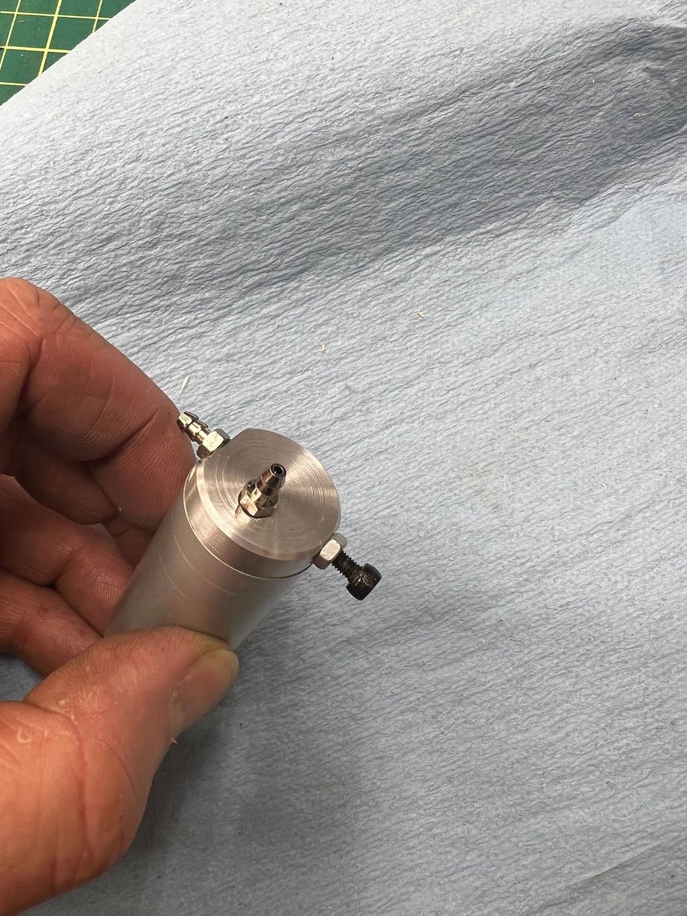

Ya they need a little work but sure look nice with the Gemini Logo on them....
Three Guesses!!!!!!

I would guess that is a craptrap intended to go between the mufflers...

Barf trap? i.e. vent regurgitation tank.

Sorry Guys... Forgot I had asked this question... . Lonnie got it - Its the "Barf Trap" but it incorporates the adjustable bleed I need for the Air pump setup.. Thats what the "needle" is for.
Will have to draw it but I have the plumbing figured out to be pretty simple.... i'm going to try the uniflow setup as I think the tank might siphon still at full - no check valve though.. This little barf tank has a shallow funnel in the bottom so any fuel pushed back should drain back As soon as pressure returns - it will have an overboard dump (Needle outlet) in case it fills up. Doing this as a bit of an experiment - Easily changes back to normal operation if required.
Simply LOVE the nomenclature
Am I close in thinking it will be mounted vertical in the plane, pump line, needle and dump up and, connection to tank at the bottom? So any regurgitation would fill up the barftrap from the bottom, and any regurgitation gets pushed back eventually, regardless of that being because of fuel consumption or pump pressure?
You got it Bert…. Tank has three lines. Feed clunk, vent clunk and a top vent. Top vent is plugged except when filling. Feed clunk is right to carb. Vent clunk goes to the bottom of the BT but will loop outside the fuse for filling. ( through the vent clunk)
