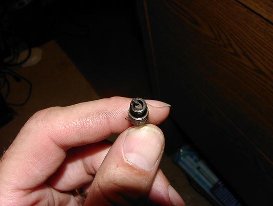

I checked the plug today after flying. It's the same plug that spent 30 hrs in the SuperTigre 51 and it was only changed because I had a Hall effect sensor going bad and I thought it was the plug. When I discovered the sensor I had already changed plugs and realizing there was nothing wrong with the old plug I put it back in service in the Saito. It now has just shy of 7 hrs in the Saito for a total of 37 hrs and it's still running good as new.
The Saito is running superbly and I am having a blast flying the Gasser Big Stick. Pic to follow.

Those little baby plugs sure are cute. Looks like your mixture is about perfect.
Pics! We like pics!
AV8TOR

If I cut the ign. right after I land it looks even better. In this pic the plug is a little darker than normal because no one was at the field but me and I had taxied all the way back in to the spectator area which kept it at idle for a considerable time. Of course you already knew the plug darkens when idled for a time. Have a fine one av8tor.
