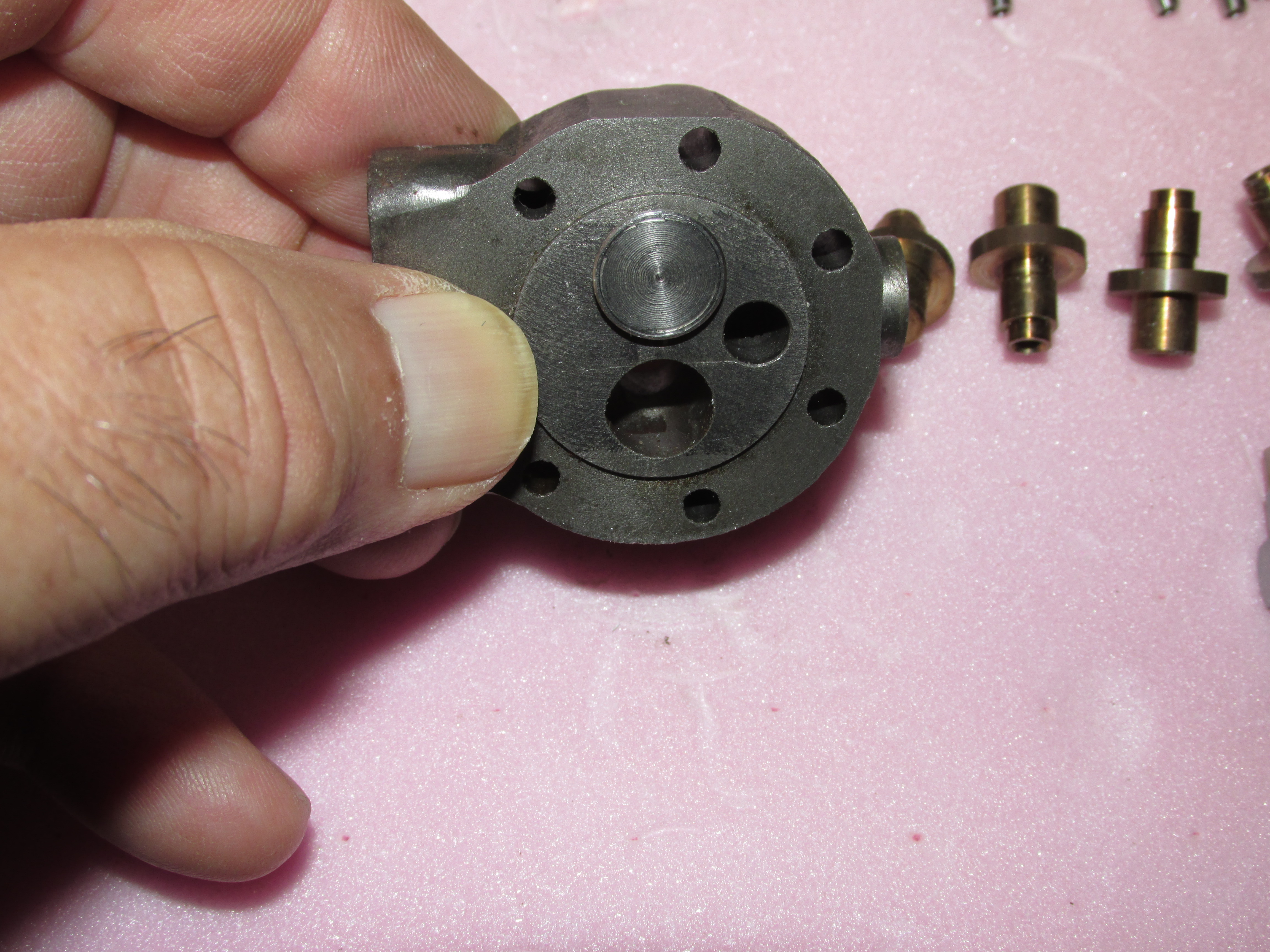

I built a test piston for the Holt 75. The clearance from top of piston to top edge of the bore is .201. The head button protrudes in the cylinder .030. Add a .010 thick head gasket & that leaves about .1.81 for the combustion space. The bore is 1.00 & the stroke is 1.250. How would I calculate the compression ratio? Thanks, C

If the head button is flat on the combustion end, (no dome nor dish), and I understand your measurements correctly, I get 7.91:1 compression ratio.

av8tor, the data you gave me is really neat. I had a good idea that you could answer the question because I know you have had extenisive experience with engine building & racing cars. The head button does have a short passage to the sparkplug that comes with a 90 degree bend. Old style engine ! I will try to post a photo of the head...it may not work...it seems very hard to post any photos. Thanks, Your friend John
The photo did upload...but is on post number 1 I can see why not many photos are uploaded...it is a nite=mare to do!!!!!!!
