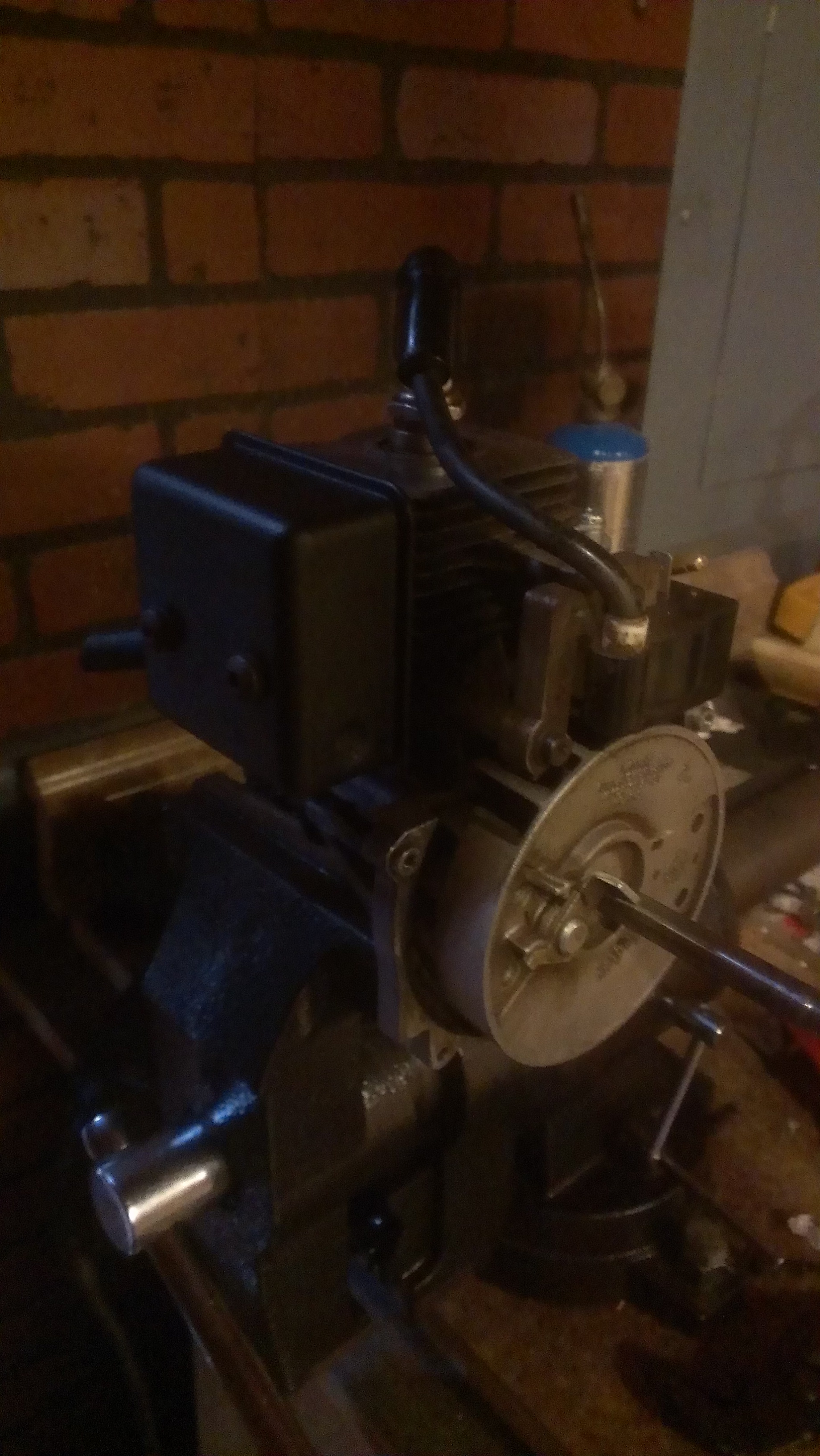

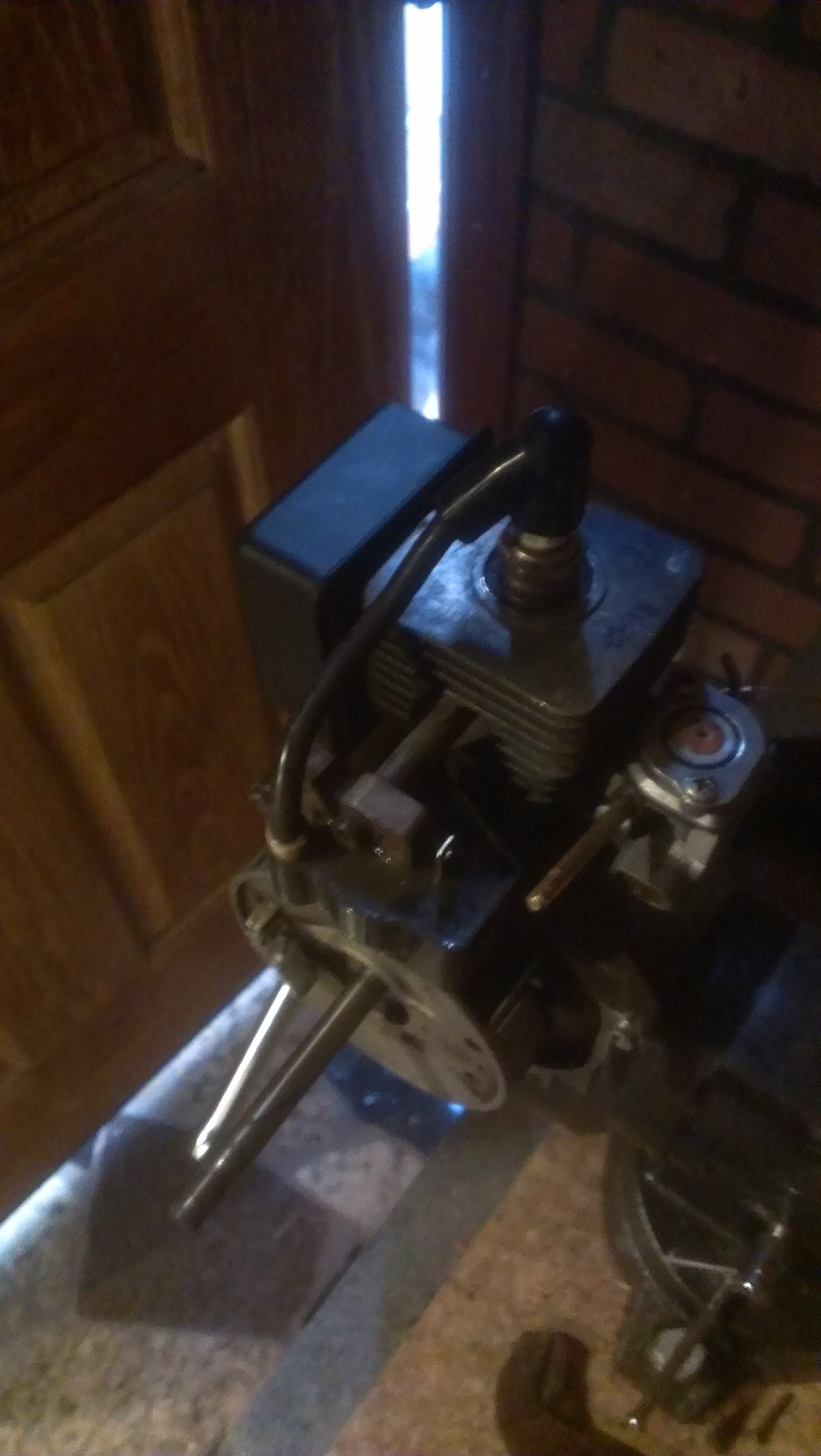

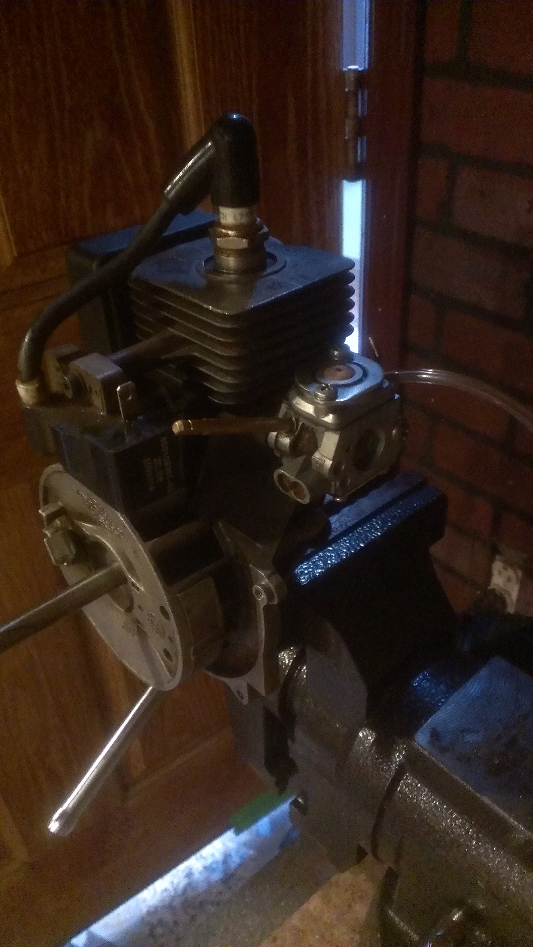

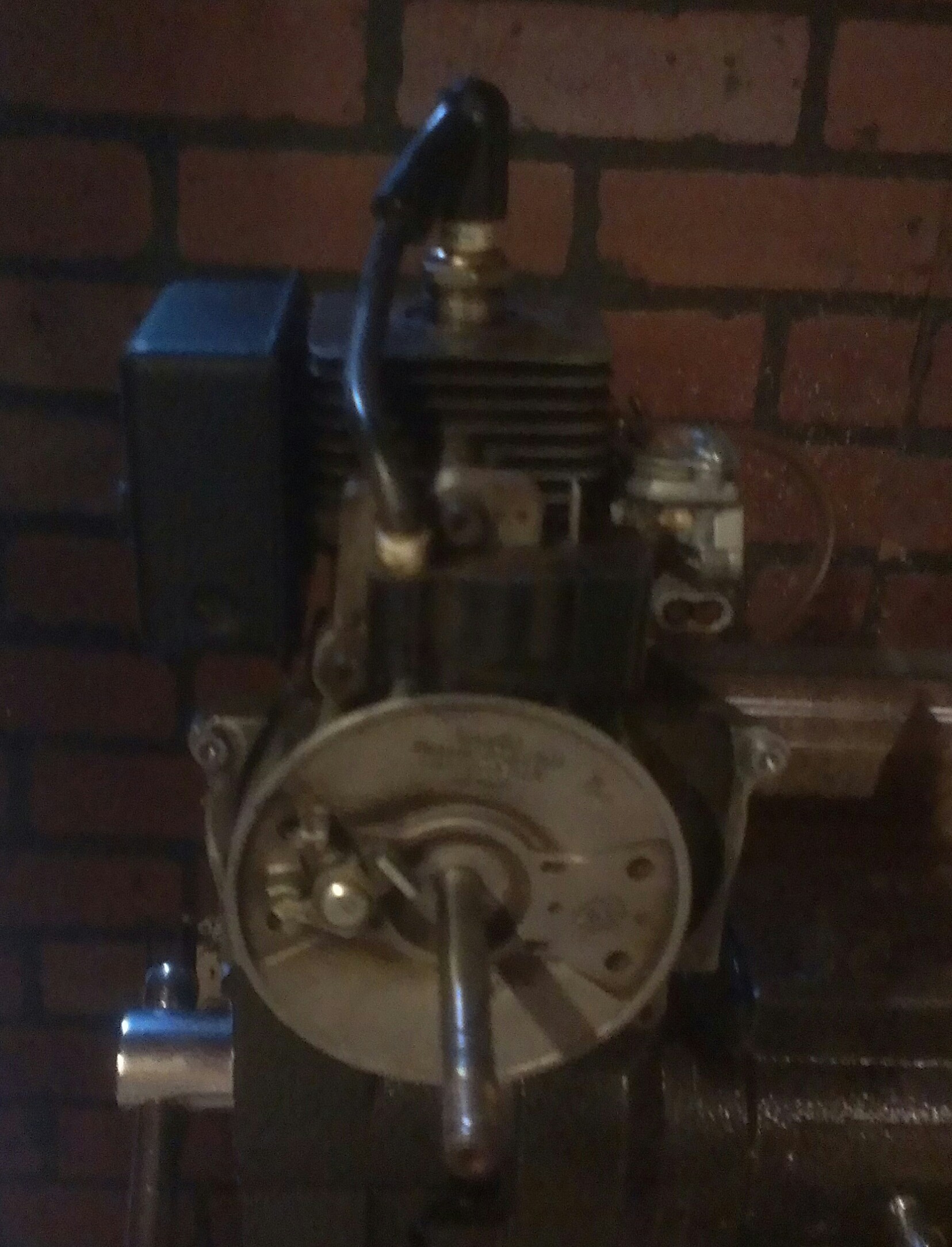

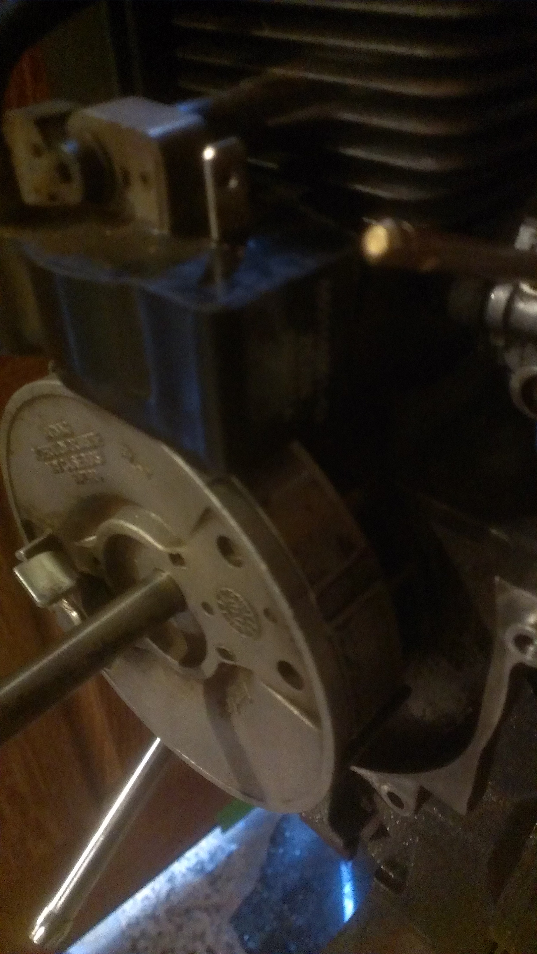

Well I was looking in my shed for some metal rods for a landing gear and in a corner of the shed I see a gas Home-lite leaf blower with a 26CC engine. I didn't test the engine because the only thing going threw my head was "well got to take this engine out of it's plastic cage" and so I did pull it out and cleaned it up a bit and also repainted the muffler but I dont know if it will run. I tested the spark plug and it does work. The rubber part of the primer bulb broke so I know I have to replace that and was thinking about this kit to replace the bulb and some of the fuel line. The carburetor will open and close smoothly but I dont think it will work for a RC engine since i dont think i can hook up a servo. I dont know alot about small gas engines but I am pretty sure the piston has compression. The gasket for the crank shaft has to be replaced and the spinning part (which I think is called the fly wheel) spins smoothly. My goal with engine is to get it working to put in a SPAD 1/5 scale piper J-3 cub and to take it to a AMA event at my field. The event is August 15th which gives me around 50 days to get the motor running, build the plane, and get it to fly.
So since I'm 13 and dont have alot of experience with gas engines I need some help on what I should do to get this motor running. My first question is how can I test if the engine will run. Should I just reconnect the fuel tank fill it with some gas and try it that way or it there some other way.
-sam
sierra_bravo 06-24-2015 01:16 AM
5 Attachment(s)
Here are some photos of the motor.
http://www.rcuniverse.com/forum/atta...mentid=2105455
http://www.rcuniverse.com/forum/atta...mentid=2105456
http://www.rcuniverse.com/forum/atta...mentid=2105457
http://www.rcuniverse.com/forum/atta...mentid=2105458
http://www.rcuniverse.com/forum/atta...mentid=2105459

Since I dont have the machines to make the parts to convert the engine I was think of buying parts from Jag engines to convert it. So I would need a new muffler and the prop adapter also possible a 11mm carburetor to convert the engine to RC airplane use along making the engine lighter by removing unnecessary parts?
-sam:cool:
av8tor1977 06-25-2015 10:32 AM
Yes, though a muffler is easy to make from the original and save the money on that. You just pry apart the muffler, take out all the guts, and then drill the holes and weld in outlet tubes. If you got it all ready to weld, a welding shop would probably weld or braze the outlet tubes in for you quite cheaply. I make most of my mufflers this way, and if anything, they actually weigh less than the aluminum ones you buy.
AV8TOR
sierra_bravo 06-25-2015 01:11 PM
Thanks for the tip. I still have the muffler from the 26cc engine that I was thinking of using but I cant get the back cover off. Does anyone have any tips on how to do this?
-sam:cool:
av8tor1977 06-25-2015 01:23 PM
I'll be sending you a muffler that works great for converting along with the Homelite 30cc. It's a nice little square one and fits the Homelite 30cc. You should wait for it to arrive. I carefully clamp them in a vice, and then using a sharp screw driver, I bit by bit open up the crimp that holds the muffler halves together. When you have worked your way around and gotten the crimp open enough, the muffler will come apart. Do it a little at a time so that you don't damage the muffler. Then when you take everything out from inside the muffler except the two bolt spacers that keep the muffler from crushing when the bolts are tightened, you can put it back together. Put it back in a vise, and use a hammer and a punch to little by little re-close that crimp. I usually coat the halves with JB Weld before crimping them back together to assure they don't leak and make a mess on the front of the airplane. Then you can make your outlet holes, prepare your outlet tubes, and weld them in. Done deal...
AV8TOR
sierra_bravo 06-25-2015 01:31 PM
Thank you.
-sam:cool:
sierra_bravo 06-25-2015 07:01 PM
I forgot to ask but does your 30cc homelite engine have a low and high speed needel on the carb.
-sam:cool:
av8tor1977 06-26-2015 06:42 PM
Yes, it does, and I will provide you with a good carb to use with the engine, so no need to buy another. Perhaps just a rebuild kit for the one I send you.
