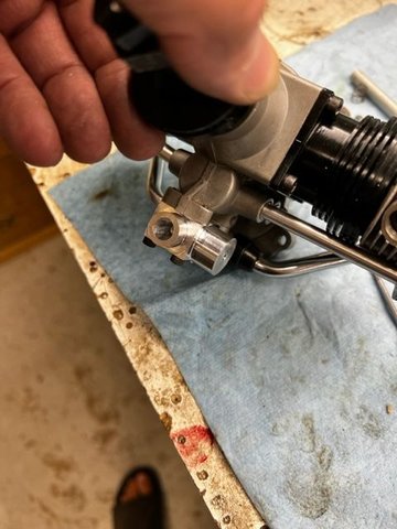

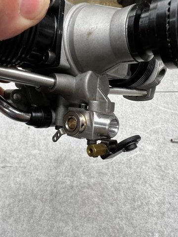

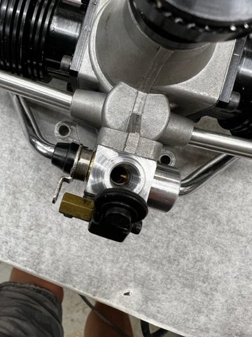

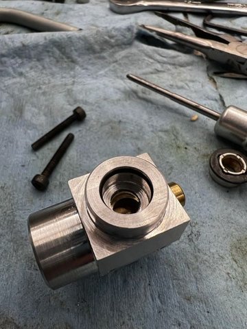

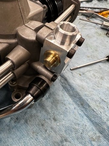

Cat 1 09-04-2022 09:05 PM
Got the Twin TBI mostly finished today.. Everything went well and can't wait to try this one out...
Thanks John for the reminder on heat isolation - I am planning an isolator shim between the body and the case - Wont do anything with the fasteners yet unless there are issues.
Questions:
1) What do you think the fuel needs of the 160 will be in comparison to previous "TBI's". Im considering a 0.3MM jet as starters as the .40 two stroke uses a .2MM and the ST23cc a .4mm.
2) choke ? - The choke does fit and the geometry is right but is it needed . I can do the electronic choke if needed also.
3) I have built replacement stacks (as stock) as the Keleo Exhaust has terrible corners that are flat and the tube it thick aluminum with a small ID. Where should the Pressure tap be located? 2 or just 1?

Back when I converted my Twin, I noticed to my amazement that this engine is the exeption to the rule.
The cambox remains cool enough for the carb to go without isolating the carb, in fact when I did in summer no real problem but in winter the carb started to freeze up.

The choke is convenient ro have. Sometimes after longer standstill, the gasoline evaporates and the straight oil remains, and the engine is reluctant to pull that viscous oil through.
Engines with muffler pressure are easy to pop through by closing off the exhaust and turning it over, the pressure build up in the fuel tank will push fuel to the carb.
But with the boxer, closing off two exhausts is a bit of a hassle, and putting a finger over the intake, the intake is at an inconvenient location for that.
It won't hurt being there if you don't need it, but it's a nuisance if you turn out to need it and it isn't there.
I am above all wildly curious if this TBI will cure the uneven fuel distribution at part throttle.
Pressure tap: My twin has both exhausts tapped, connected with a T-fitting (NOT an Y-shaped one but really a T-shape). That makes the crud basically shoot back and forth between the two exhausts leaving a much cleaner pressure supply to the tank. I still use a craptrap, but I barely ever need to empty it, significantly less than the singles or the radial.
A single tap probably works just as well, and I have never done any measurements WRT what results in the highest tank pressure, but the reduction in crud (A "reduced craptrap load", how's that for a technical parameter? :D ) is always a nice thing.

Raleighcopter 09-05-2022 04:02 AM
1.my math says .25. remember, this is like two .13cc engines with intakes at differing times so you need a carb for a 13cc engine.
2. Choke is not needed. Place finger over exhaust pipe with pressure tap and flip to prime. In fact, the choke on mine got them bed rather than cut the cowl.
3. Not sure on this one. Mine is tapped right after the bend but I have stock pipes.
4. Make extras (if you want). Bert and I will pay you.

Raleighcopter 09-05-2022 06:36 AM
Mounting is the same for the 120 as the 160 but I would assume if the .25 orifice works for the 160, you would want an orifice closer to .21-.22 for the 120
