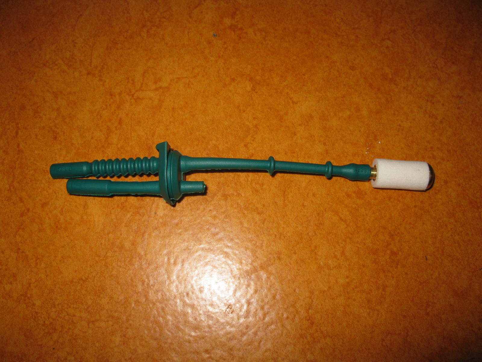

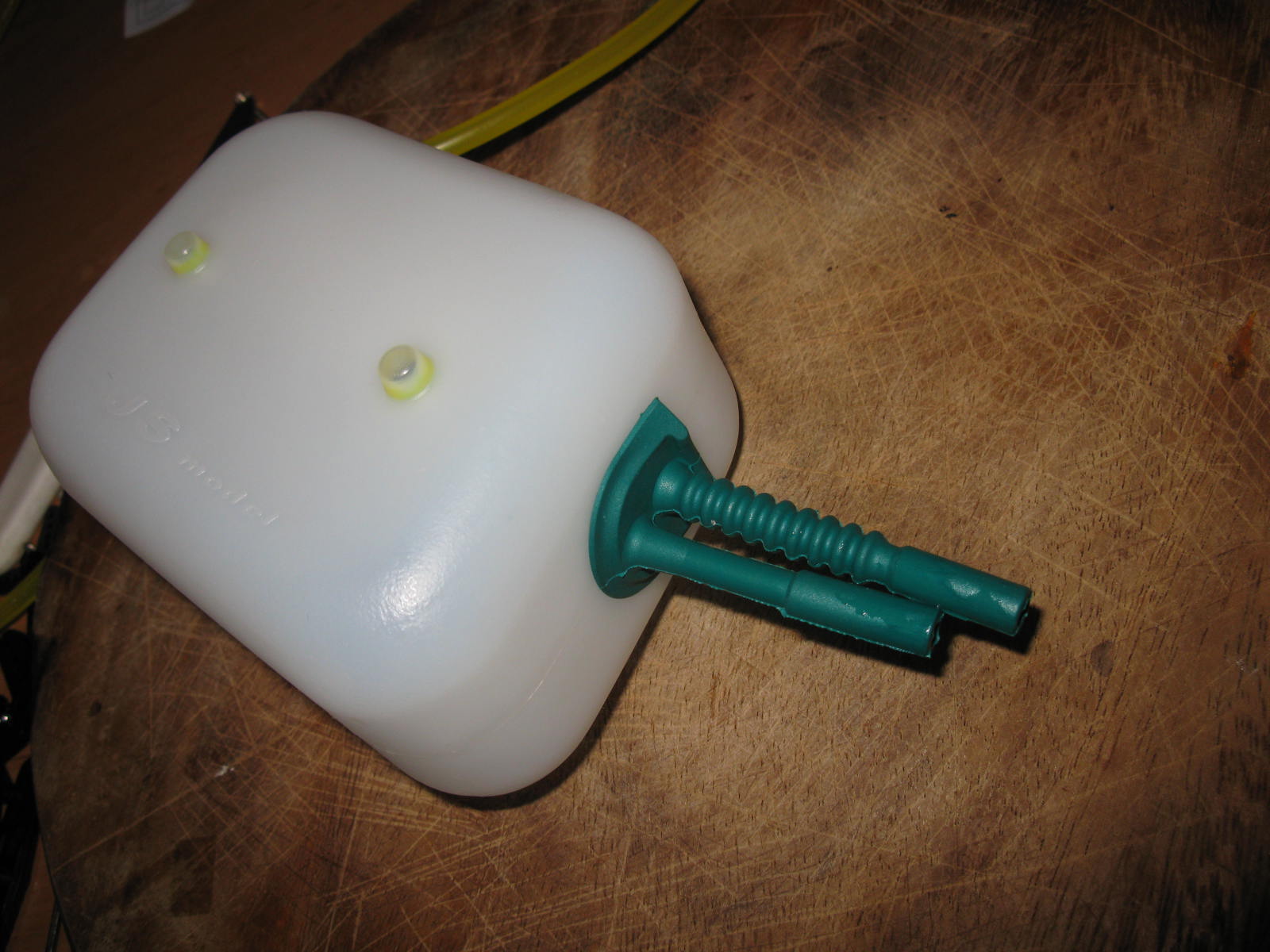

I like to (once more) refer to the Stihl Fuel tubing part no 42293587702 in combination with a slightly modified DuBro fuel tank. My oldest tank is in use since 2014 and still absolutely 100% maintenance and trouble free.
I have never had a glow fuel tank last that long without trouble, and using Tygon, a gasoline tank needs a refresher every 2 or 3 years (the Tygon hardens over time). True, Tygon ALSO hardens outside the tank but there it is no problem as long as you leave it in place.
The Stihl part is reported to survive up to 20 years according to one of my neighbours using Stihl garden equipment.
Attachment 2273371

there's also this single tube bung that stihl makes which i've used and can confirm it does not harden with use. great for tank overflows and fuel cans too.
https://www.google.com/search?q=stihl+1123+358+7701
John_M_ 09-19-2023 11:07 AM
Right, I've seen those STIHL fuel tank bungs before when Bert first started his gas conversion project... a clear mylar film liner would work.
It was just a thought, it would get rid of either barf / crap traps, but tank accessibility would have to be made easier for maintenance for cleaning out between the bladder with the muffler pressure setup... not something I could do on the cub easily, thats why that AC will remain glow fuel... but there will always be variations in the design that create hurdels to overcome when you start increasing the complexity... stay with what works, and don't overcomplicate things, don't scratch Murphys back in other words.:)
