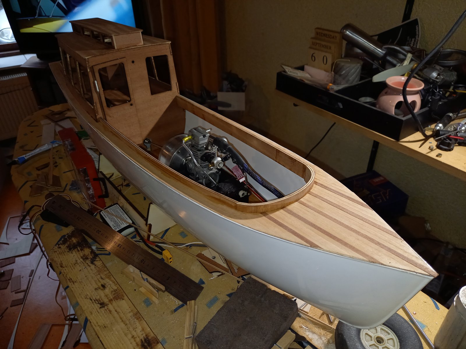

3 Attachment(s)
Sorry for having been gone for a while, guys... But life dealt me a rotten hand (better said, my employer did the dealing) and life has been a bit helter skelter lately.
Haven't been sitting idle (in fact, buried myself a bit in hobby projects to not have to think about the misery in life) and it just so happens that where last leave period it was a steam powered boat, this time it's a bit closer to this topic. Still a boat, but at least powered by a converted-to-gasoline ex glow engine.
Attachment 2273551
No solenoid system however, but that has a reason: The RPM (1500 approx, or 25 revs/sec) and the control frequency of the solenoid (30 Hz) are too close to each other, and I cannot be bothered to start messing with synchronized solenoid operation.
It's a continution of a project I did about 7 years ago, but for which back then I had a very unsuitable hull...
Did not feel like "engineering" lately, just wanted something to keep my ands busy and my brain disconnected from reality.
Haven't flown an RC plane in about 4 months, didn't trust myself with that kind of stuff...
Slowly getting back to where I am supposed to function, so...
And I'm not the only one that is slowly getting back to life:
Hasn't run in about 6 or 7 years...

To be honest: I don't know what direction to take... This is really completely different than anything else out there. Imagine this: The carb is taken from a .06 cu.in engine. That is tiny.
This engine (the fourstroke, not the donor engine) runs with throttle openings so small that that .06 would not even consider turning over, let alone run...
I have no idea about air velocities, intake manifold pressures and what not. Looking at fuel consumptions in the order of magnitude of 20 ml per hour (2/3rd of an oz).
I am like a blind man, feeling my way around here, and no idea what does, and does not work.
I have allready reworked the camshaft, because valve timing intended for 10K does not function very well at 1,5K. So I reground camprofiles such that valves open and close as near to their respective dead centers as I could get it. It makes the valve train a bit noisy, but because of the very low speeds, I do not think there will be an issue with that.

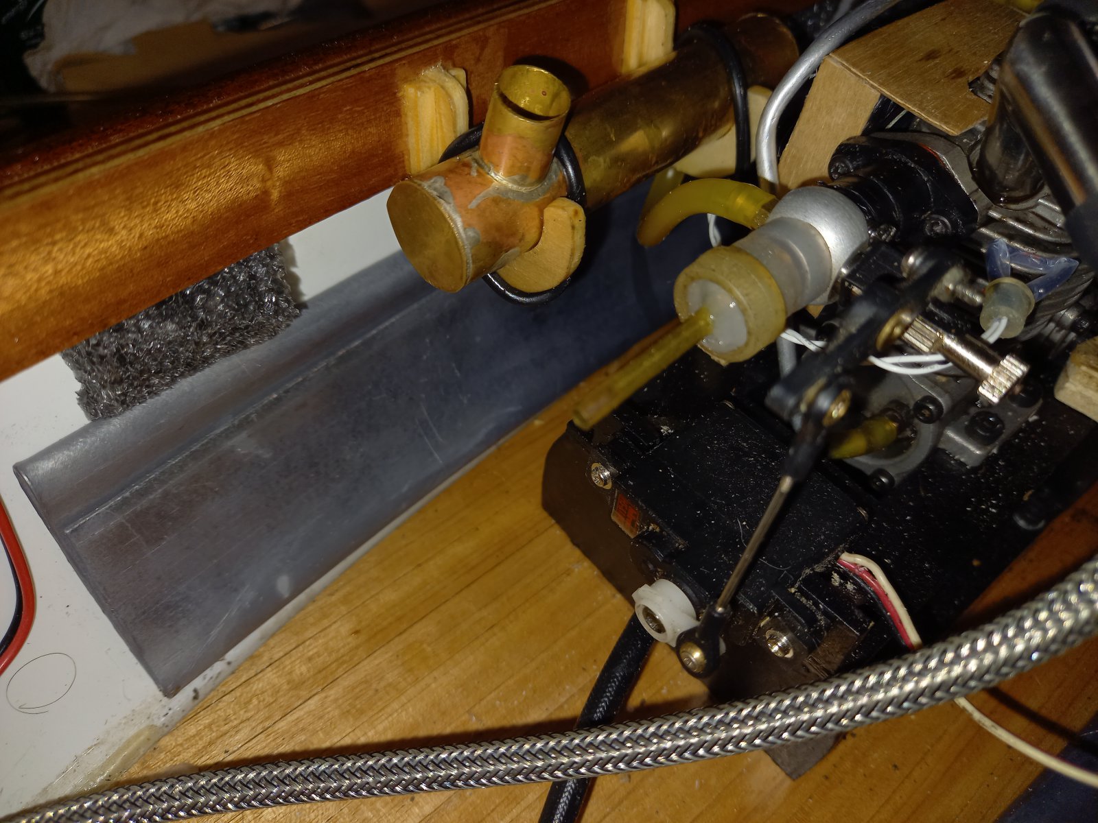

1967brutus 11-10-2023 11:25 PM
1 Attachment(s)
Originally Posted by Raleighcopter (Post 12787337)
If the throttle is managed by an onboard governor, there's essentially no throttle position available at the transmitter to slave a mixture curve to. It would require adding a throttle position sensor and moving the mixture curve to the controller and everything that entails. It's a major rewrite of the code and additional hardware (probably a magnet and hall sensor) to read throttle position.
That is exactly the bump in the road...
But I decided to go the analog McGyver way and solved it like that.
The challenge I had was that a glow carb from an AP .06 Wasp (1 cc glow engine) had to supply an ASP 30FS running at 1500 RPM, fixed RPM variable load.
Since RPM is fixed by governor, increasing load actually DOES force the governor to open the throttle, but since the RPM does not rise, that means carb vacuum and thus fuel draw reduces.
It is the same effect that forces us to use a servo-slowdown when opening the throttle, only, in my case the RPM won't come up.
So I was having an engine that went from slobbering rich at low load to too lean at high load at constant RPM (meaning you cannot really determine what is going on by ear).
Given the very low RPM, very low fuel consumption (this thing, even slobbering rich, only consumes less than 1 oz of fuel per hour), there also is no visible smoke plume to go by...
What I did, was attach about 1 1/4" length of 1/8" OD Brass tubing in front of the air intake, that serves as a restrictor.
At low load (throttle barely a pinhole sized opening) the throttle barrel is the main restriction, at increasing load the throttle opens, the airflow increases and the Brass tube becomes the dominant restriction, shigfting the vacuum area to in front of the carb barrel, increasing fuel draw at increasing load.
I can tailor that vacuum bias by varying the length of that Brass tubing, and at the moment I am (based on sparkk plug colour) probably just ever so slightly on the rich side at high loads.
It looks rather improvised (and that is because it IS improvised), but this is that restrictor.
Attachment 2273556
So far, it works like a charm, the engine is running pretty consistent and so far absolutely reliable, it starts really easy, and the only "thing" procedure-wise is that you have to start it on manual throttle, and once running you need to bring RPM to within a certain range close to set RPM or the governor won't engage. Without a visible tach, that is a bit of a trial and error thing, but no big deal. Once the governor engages, it basically runs until the tank is empty.
Cooling is done by a tiny 42 mm electric fan, and more as a gimmick than anything else I added a commercially availlable themperature controller (very cheap Proportional controller, nothing fancy) and changed the NTC resistor for a FrSky probe, which conveniently brought the regulating range to 70~100 deg C.
The weird thing about this cooling is, that when I ran the engine without cooling, it never got over 110 deg C as far as I can tell, and the other ASP 30FS I have runs way hotter.
I do not believe for one minuten that this tiny fan has any significant effect on engine temperature, because even an idling prop generates a 100 times more air movement, but alas, without the fan the engine refused to run reliable, and needed a belching rich mixture (judging by the pitch black exhaust residue) while using that tiny fan, I'm now fairly close to Stoichiometric: the exhaust residue now is a light grey oil/water emulsion and the tailpipe does barely get over 30 deg C.
Haven't been able yet to determine engine temperatures due to the shrouding on the fan (no access for IR temp gun).
But who cares if it appears to run right all day long, right?
1967brutus 11-10-2023 11:53 PM
Originally Posted by Cat 1 (Post 12787454)
Truly Amazing project Bert... Love the sound... Variable pitch to control speed??
Do you think a custom carb with a very small venturi high help out - I know a guy.. :)
All in all it seems to run great!
Yup... Variable pitch indeed. An old Marx unit, 50 mm prop, 15 degrees reverse to 45 degrees forward blade pitch angle. These things have been discontinued for at least 30 years if not longer, but 7 years ago out of a clear blue sky I managed to find 2 new ones (both NIB, never used).
Pretty decent quality, triple bearing double sealed sterntube, the hub has 5 ballbearings out of stainless (one for each blade, and two in the pitch control mechanism). Entirely maintenance free, yet the hub is taken off in 5 minutes if needed.
:D :D :D I know you know a guy, but the issue for this carb is adjustability. Right now I can trim that air intake tube, and as long as it works, I'm not going to change that...
It took me 7 long years to come up with this idea (remember I mentioned once that a lot of my solutions are "brainwave-based" and that I have little control over where or when they pop up? This was one of those... :D :D :D )
THis is a more clear vid of governor response:
As you can see, I had to extend the throttle lever by a "huge" amount to reduce barrel movement, and mind you, this is a carb intended for a 1 cc engine feeding a 5 cc engine.
Throttle bore is something like 2,5 mm in total, and at 0 load, the throttle opening is even barely visible with the eye, at full load it is maybe 1/3rd of its stroke opened.
It's a weird set of parameters to work with, I can tell you...
