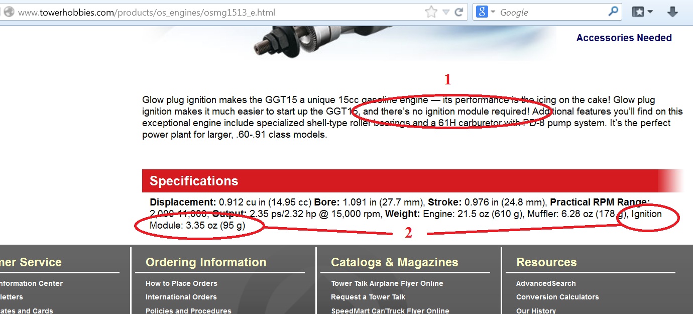

vasek 07-28-2014 08:03 AM
1 Attachment(s)
It would be nice for someone living in the US to order one and post some info. On the TH site there seems to be conflicting info regarding the plug function (see pic)
http://www.rcuniverse.com/forum/atta...mentid=2018010
hessian123 07-28-2014 08:15 AM
I noticed that as well. I wonder if they rushed this out the door so quickly that the marketing materials didn't get a thorough check.
