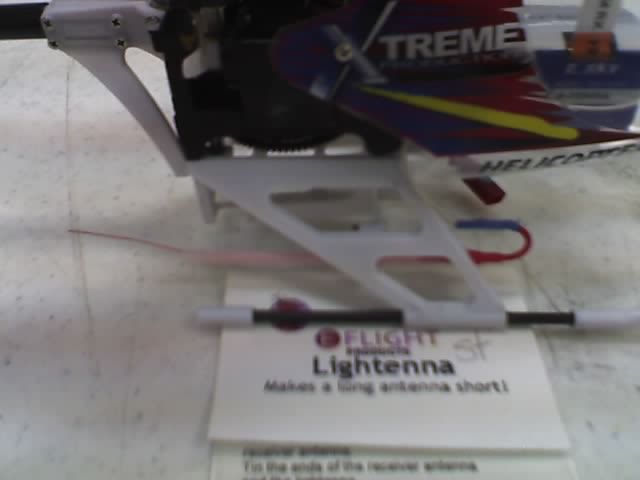

OK, I'll start this off. I just got these mini antena's in and will be putting one on the HBK II tonight. The pic is on a ESky Lama just to check it out and it works great. Bought them from Hobby-Lobby for $6.90. Sorry for the lousy pics, it's my camera phone. If anyone wants clearer one's let me know and I'll repost using my Canon Digital.

The previous post with pics also shows the micro antenna installed. Now this is a great mod for less than 7 bucks.
