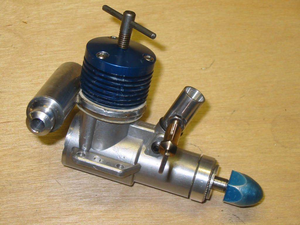

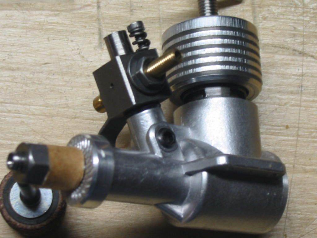

Hello, Have a question which am hoping to learn from any responses. Own 2ea MVVS 61's with "factory" diesel heads with T-hdle adjusting screws which appear to be a very loose fit. My DDD heads with hex adjusting screw hold setting when adjusted and I've seen some with lock nuts to hold setting.
Any experience with these MVVS diesel heads?
Many thanks for any responses

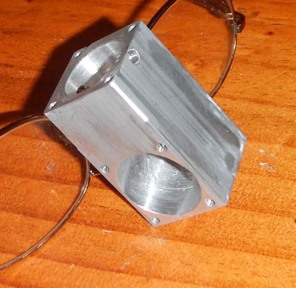

I wanted to attach pics of the beginning of my engine making attempt but I'm too junior on the board to be able to yet.

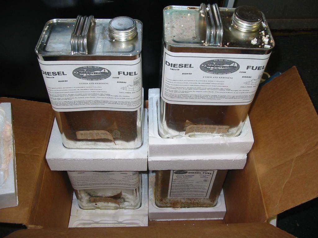

Default Diesel Fuel Ingredents -- Mixed fuel available from Aerodyne
Aerodyne -- for diesel fuel:
Allen Heinrich
4184 South Roberts Road
Fort Mojave, AZ 86426-6330
email: [email protected]
phone: 928-219-4590
cell: 760-684-2030
*** info current as of 1-18-2020 ***
John Deere Starting Fluid available at my Walmart, Farm and Fleet, Big "R", some automotve stores.
Caster Oil can be purchased on Sig's website by the gallon or pint.
The kerosene you can pick up at Walmart (I get the Crown Kerosene brand).
Eric Clutton (aka Dr. Diesel) no longer sells diesel fuel, but still sell PAW engines.

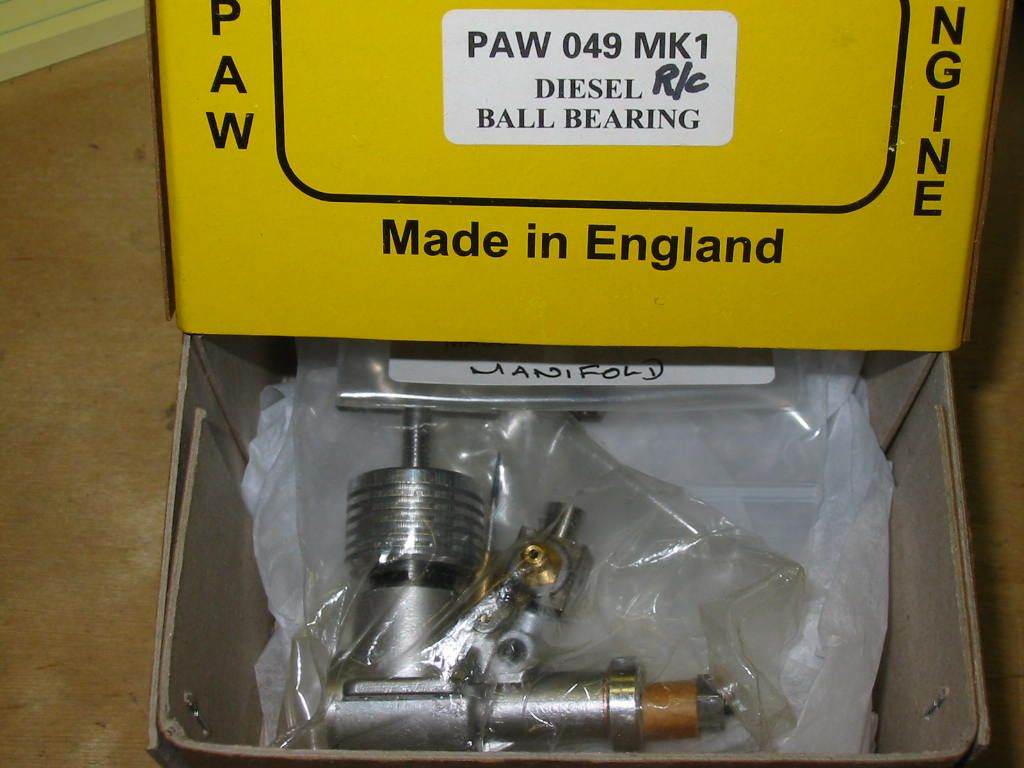

New This Year -- PAW 049 --R/C from Eric Clutton
PAW 049 with R/C throttle, silencer (muffler) and Radial engine mount.

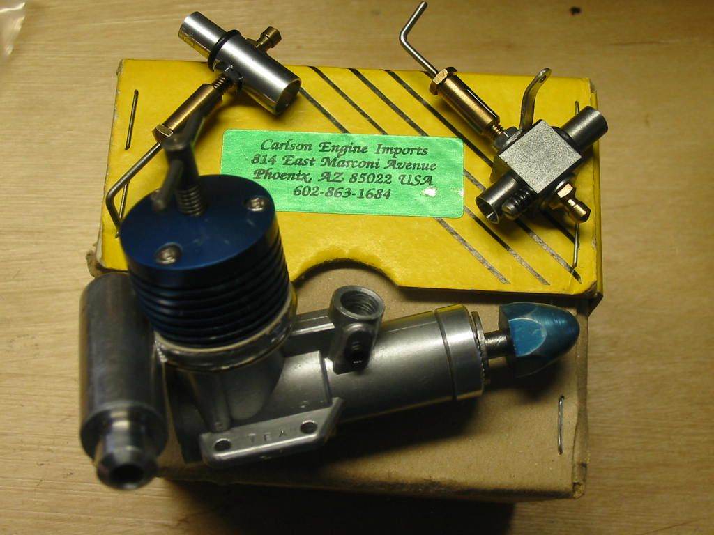

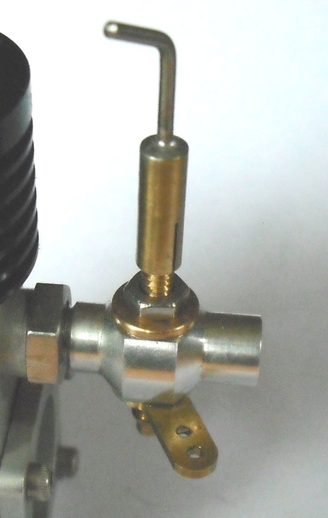

PAW 09 (#2 from Carlson Engine Imports) with free flight venturi and R/C carb. Bought in 1994.

Special order for diesel fuel from FHS (Red Max Fuels). Four of the seven gallons I have.

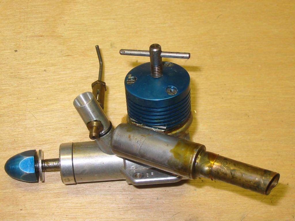

Rustler - Oliver Lynx Repro. I made a R/C carb for it.
Rustler - Oliver Jaguar Repro.

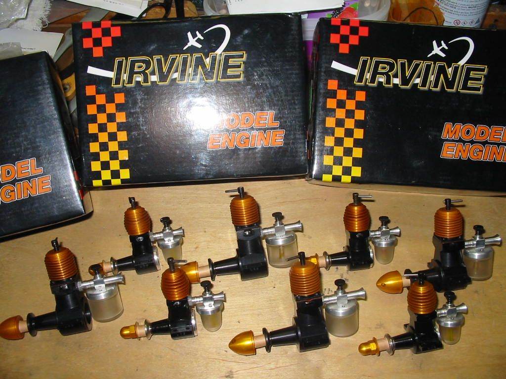

My Irvine Mill engines. The .75 and 1.3

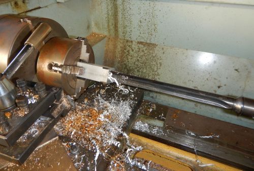

The drill's well over sized I know but it's the only one I have of the right diameter. It has the advantage of being a spade drill though so the holes are true.
Finished crank case.
