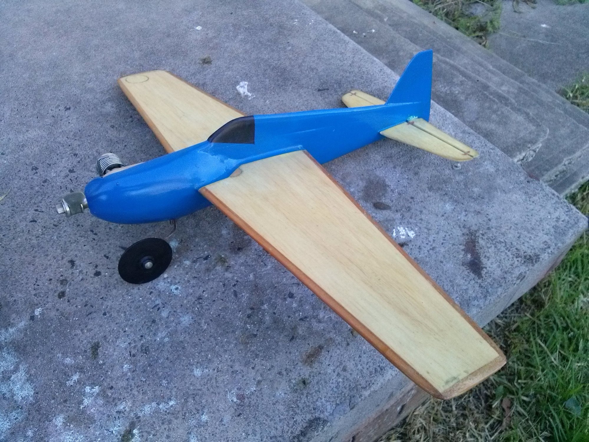

Our Australian rattle can paint choices for diesels have had a shake up in recent years as well. Suddenly the most effective brands couldn't handle diesel fuel or glow fuel. I've since found one that can manage the former. I don't think it's available in the US. Otherwise VHT brand seems to handle glow fuel with 10% Nitro and diesel ok but it's heavy and doesn't age all that well. I don't want to go via the 2-pack path either.
The pic shows a c/l Mini-Goodyear finished with VHT Blue on the fuse and floor enamel on the flying surfaces. Just getting it finished for the weekend.
Engine is an R-150 (1.5cc) diesel

Nice job how fast?

Originally Posted by Propworn
Nice job how fast?
About 24-25 sec/10 laps I'd reckon :-)

Sweet little ship Ray,
