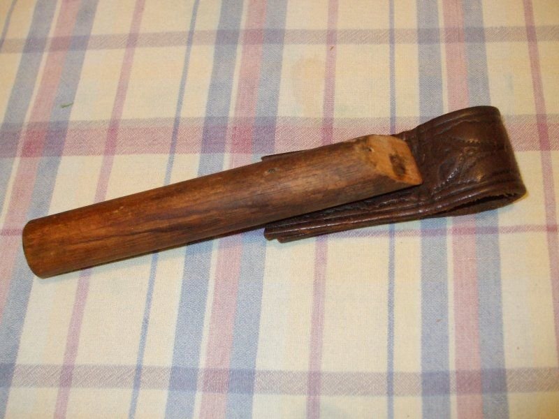

Possibly not a good place to start a journey into the model diesel engine experience. A new PAW 09 would be my choice. The engine is likely to be at least +65 Y/O, and it has a rather vulnerable O-ring in the contra piston. I have a few of the OK and McCoy small diesels, and I'm happy with them. However they are a bit of a nightmare to dissemble at their age, and you will need a "strap-wrench" (try google). I ruined a cylinder trying to disassemble a 70 y/o OK diesel which had a very soft exhaust pillars. Rather I'd soak it in a jar of Kero instead, and then oil up the O-ring by squirting Auto Transmission Fluid into the head via the exhaust. If it will hold compression (after washing the ATF out) then try to start it by all means. Have a look at the attached link for more information. Some people here have had success with the John Deer fluid, but I'd be very wary of stuff with less Ether. Remember 50% Ether means another 50% of some other hydro-carbon, which may not like running in a diesel. They run best with genuine solvent grade Di-Ethyl-Ether. Anyway good luck!

OK sounds like you have the deal under control. Certainly too little Ether or lack of a DII will cause problems. I don't know if I'd consider the McCoy as a powerhouse. Diesels have moved on a lot since 1954, and there's a lot of McCoy 09's sitting around with broken crankpins :-). I've attached some pics of my homemade strap spanner. Good luck.
