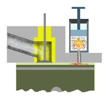

Hi all, i am new here.
I have 2 4 stroke diesel, where i has converted to diesel, it is not difficult.
First engine are a Os FS40 surpass and second engine are a Magnum 52FS AR.
Here are my pic, but not of Magnum[8D]
The engine needs to be long stroke which would need a new head and cams.
Long stroke are not important, it works well with short stroke, the cylinder liner must be lower to same height as piston (removed material from crankcase to lower cylinder liner.), At Os FS40 cams are same as before(but not at newer version of Os fs 40), removed a parts of material in cylinderhead to increase compresion ratio. Used casket to adjust height between liner and head to prevent knock valves. Maked a extra contrapiston in extra contrapistoncylinder srewed to glowplughole. Start very easy and reliable idling and turn big propeller[8D]
Magnum cams are a bit difference from Os FS 40, removed a part of side on cam for intake valve cause valve opened early and knocked at piston. Valvelifter has plane, then i maked these plane surface to halfball, then it will not valves knockin at piston.
How to start 4 stroke dieselengine (contrapiston must be ready adjusted at test running): Turn out fuelneedle 1 tturn out, choke carburettor with finger, prime engine 3 times (turn crankshaft 3 times), rotate to compression begins then flip propeller, it will start. Adjust fuelneedle 1 turn back.
Dieselfuel: 32 percent ether, 2 percent isopropyl nitrate, 15 percent oil the balance kerosene.
Hope my english are understandful for all readers
Jens Eirik,Norway

My engine ran at 8-9000 rpm with 12x6. But i was afraid to lean out fuel in case not enough lubricating the engine. Because i used motor oil at sae10W40 in dieselfuel. Castor oil are expensive here in Norway. Which oil can i use in dieselfuel for 4 stroke engine? Full syntetic motorcycle oil at 20W50?
The combustion chamber are not same as in Bukh diesel or in Mercedes diesel, both engines has injector above comustion camber. I use the "lanova cell" with contrapiston.. and it is too cause to difficult to place contrapiston direct in cylinderhead. fuelmixture presses in the cell and ignite, then blow out of cell..
Lanova cell. A special combustion chamber also called energy cell, for diesel engines of high rotary speeds.
I shall send better pictures of engine parts. Here are not much carbon builds up in combustion camber and piston![X(]

Jens very neat concept I know none of our model diesels are injected but that external chamber idea
is new to me.. years ago I worked on and installed convential diesels in fishing boats I do not
think anyone has developed tiny injection pumps and injectors but you got around it
8000 sounds pretty good since as glow we run maybe 9000 tops (at least I do) on glow
At any rate a very good sucess story

Hi, i shall not make the pump and popoff injector , because it is difficult for me.
It is very very small fuel for each injections in the modelengine + how much it can give precise quantity fuel each injection in high rpm..
To example a truck engine at 4000 rpm use 3 cubicmillimetre (0,000183 cu/in) diesel for each injections.
I am thinking if it is possible at model dieselengine with pump, maybe engine will consume 1/4 of fuel tank while model dieselengine with carburator consuming 1/2 of fueltank.
One problem, where are the lubrication of engine if it has dieselpump and popoff injector, we can not use oil in out 4 stroke crankcase to lubricate moving parts.[]
Today i am ready (not complete) with my Magnum XL 52 fourstroke. Has converted the engine to dieselengine.
And i has mixed new 4 stroke dieselfuel, i has never runned engine with glow or methanol/oil/nitro. Only new engine, then i slaughted [>:] new unused engine and maked engine to be a dieselengine. [8D]
Engine has Lanova combustion camber with contrapiston, all works well, not much carbon cause rich fuel while break in.
Now i am breaking in the engine, it ran without problem in cold weather -1 celsius (can not fahrenheit temperature).
Dieselfuel formula: 32 % ether, 10% castoroil, 10% 20W50 full synthetic motorcycle 4 stroke motoroil, 48% diesel (not kerosene, because diesel has better lubrication perfomance). Also i has all 3 things to lubricate engine: Diesel (we use diesel to lubricate dieselpumps in our cars), castoroil, 20W50 full synthetic motorcycle 4 stroke motoroil.
