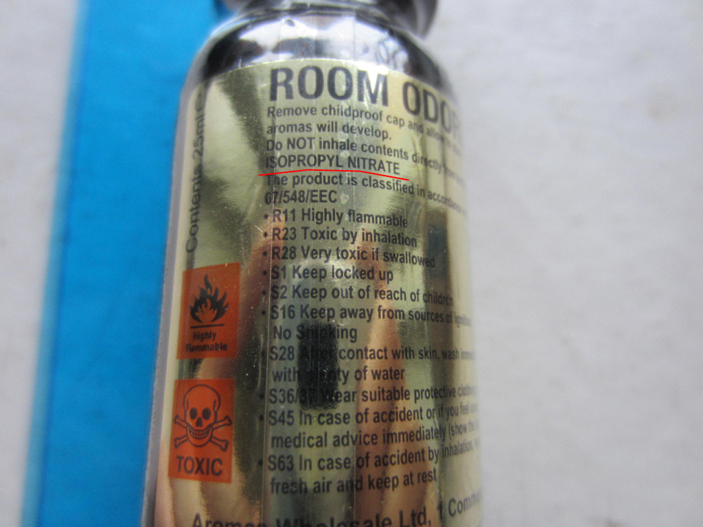

vsv123 02-28-2015 10:20 PM
1 Attachment(s)
The label states "Isopropyl nitrite".
Also the contens of bottle almost doesn't have any smell, unlike AmylNitrite
http://www.rcuniverse.com/forum/atta...mentid=2077587
qazimoto 03-01-2015 12:44 AM
That's interesting!
Can you give us the products brand name?
Does it have an MSDS?
Where is it for sale?
So many questions.
qazimoto 03-01-2015 01:18 AM
Yes, I see what you mean. Some of the "Poppers" apparently do seem to contain IPN.
Possibly mislabelled to circumvent the Law?
That's unfortunate.all round :-(

vsv123 03-01-2015 09:58 AM
There are different nitrites used for these poppers:
Wikipedia:
Most widely sold concentrated products include the original compound amyl nitrite (isoamyl nitrite, isopentyl nitrite), cyclohexyl nitrite, isobutyl nitrite (2-methylpropyl nitrite), and isopropyl nitrite (2-propyl nitrite). Isopropyl nitrite became popular due to a ban on isobutyl nitrite in the EU in 2007. More rarely sold is the compound butyl nitrite.
So it seems label "Isopropyl Nitrite" tells truth
steve111 03-01-2015 02:20 PM
Am I missing something, or are we discussing two different things here? i.e. Isopropyl nitrate vs isopropyl nitrite​?
qazimoto 03-01-2015 03:11 PM
No Steve you haven't missed anything. But I did.
Isopropyl Nitrite has a boiling point of 39 degrees C, Isopropyl Nitrate, a different compound, has a BP of 101.5 degrees C.
So the 'Poppers" mercifully contain the other sort of IPN.
But it still seems to work as an Ignition Improver.
