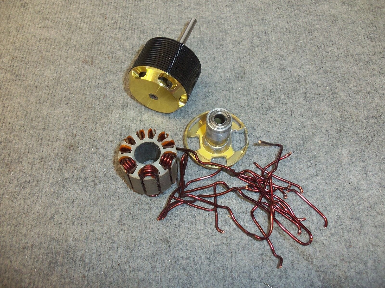

"in partloaded situation with 8/16/32kHz (depending on esc) you just are deep within the dangerous zone. also for eddy currents into the copper.
we found this by measuring this (only winded for show in 2010) 4+4 x 2,5mm YY 7050:
this is a 7050 with 9+9x1,8mm YY.
n spec is 132/V:
this one works very well and with good efficiency"

"Just in case anyone doubts whether the 7th turn would have fit into the slot.
There is nothing about or anything.
(Fortunately, I hadn't quite finished performing the comparison engine yesterday.)
