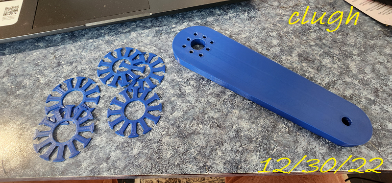

Ralph should work on his bench. Here I have printed 50 series end plates and a 6 inch torque cradle arm.
My work area is not big enough for the full 12 in a single piece.He needs a real torque measurement not unilog.

And so the torque arm for a scorpion 50 series or whatever goes. Now just a few pieces left. The hole is pinned for 8mm shaft
so the fork and yoke for the transducer plunger will be bossed for flanged ball bearings to fit the 8mm shaft.

A
A dual pillar block can hold flanged bearings on each side of the torque apparatus and that makes the cradle
You use a long motor shaft. Perhaps a 5040 in the 5020s case. You want enough shaft to also add a trigger wheel for tachometer pickup.
