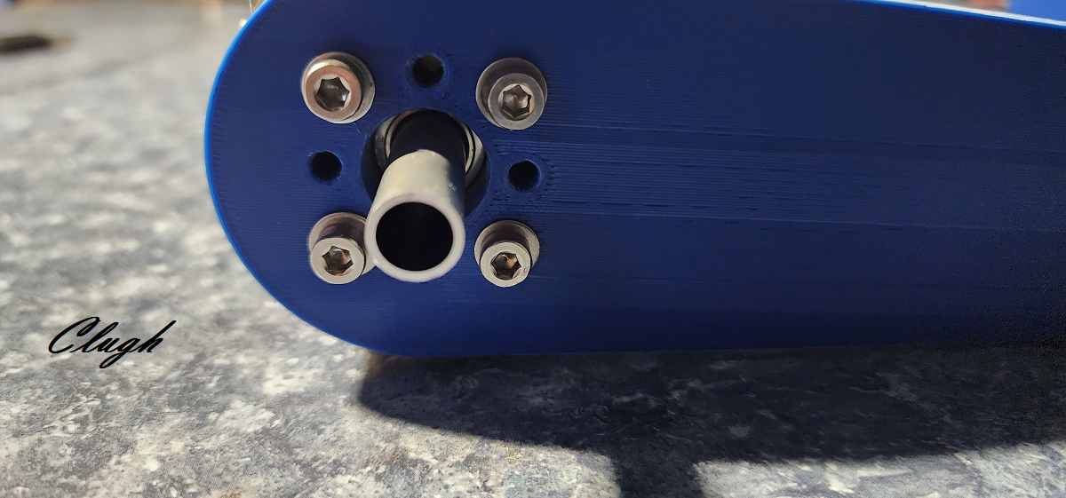

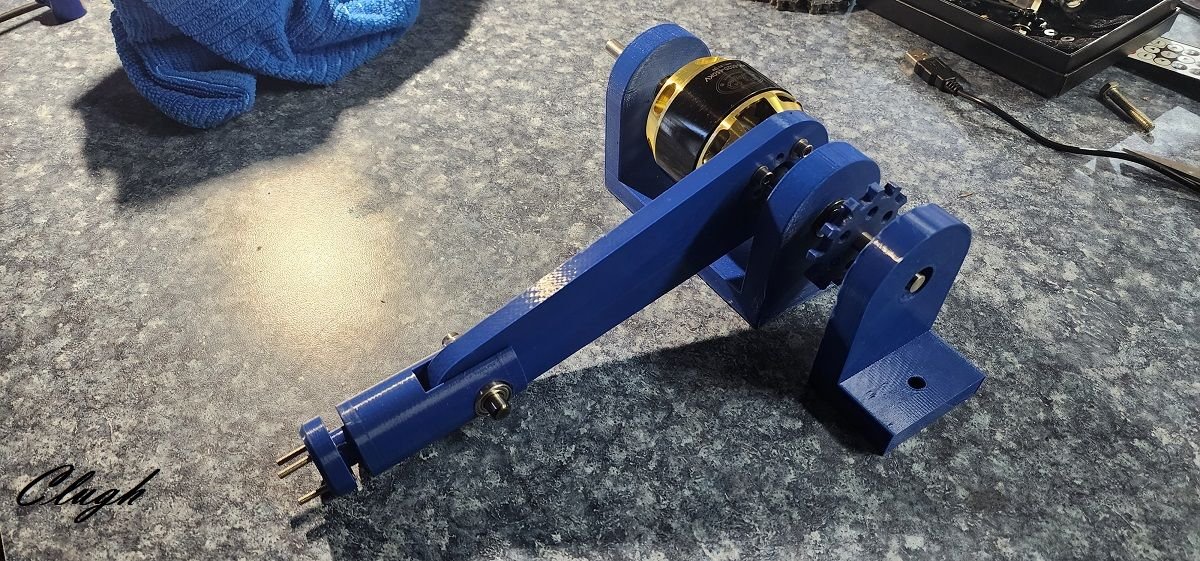

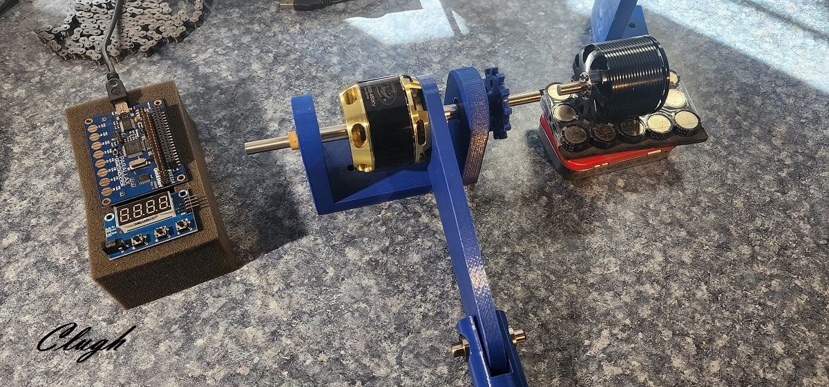

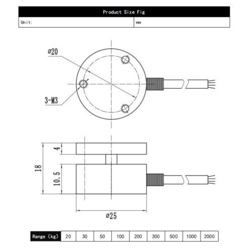

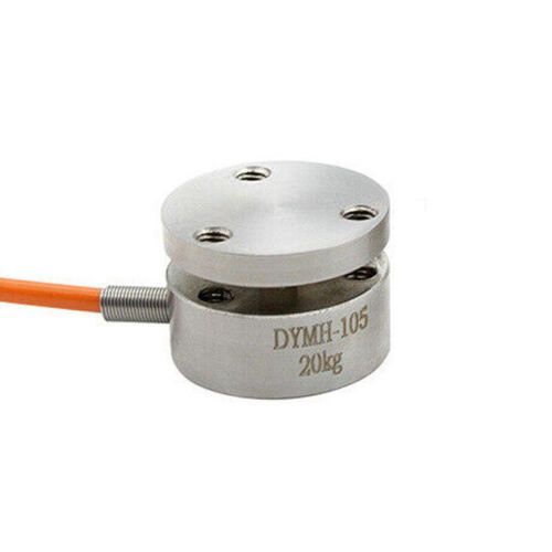

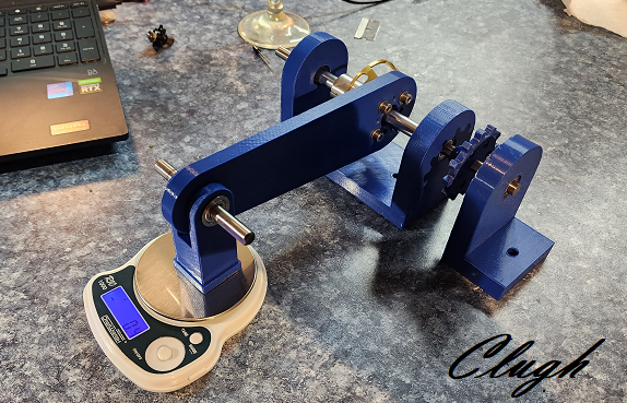

Load cell linkage is done. I don't really like it and already have a much stouter design in mind but it gets the idea across for now. When its finalized ill have this all done in Carbon fiber composite or T6. Now I have to draw up a flange that mounts the load cell to the x mount extrusion table it will all be mounted on. 3 M3 bolts wouldn't secure properly 20Kg in my mind so maybe I wont worry about it.. I just get concerned in reverse is hit with a load that sends the arm in a tensile direction versus compressive. Best to enclose it all still. It would have been better to build it where the entire link is the diameter of the load cell and hide the mounting bolts. The bottom half of the link would fast to the load cell but its in 2 pieces the the base has a big male cog the top half of the linkage accepts. Then from the top view one bolt runs down thru the middle of the entire linkage assembly and holds it together. In T6 or carbon fiber that will be very strong. The holistic linkage rod would be 25 mm in diameter. Ill also narrow the slot just wide enough to fit the arm and bearing flanges and 2 shims inside the channel. Heavy duty use needs more meat in the area of the 16mm bearing bosses. If you or your friends have ideas feel free to share them. Ralph is at the forge so Ill print it.

#103
Nice too is the fact the subject generators cogging torque can also be measured as simple as turning the shaft here so all the BS from Ralph is over and there wont be anything to say....

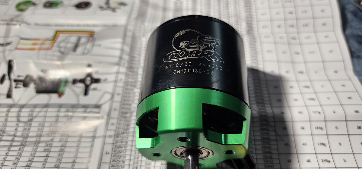

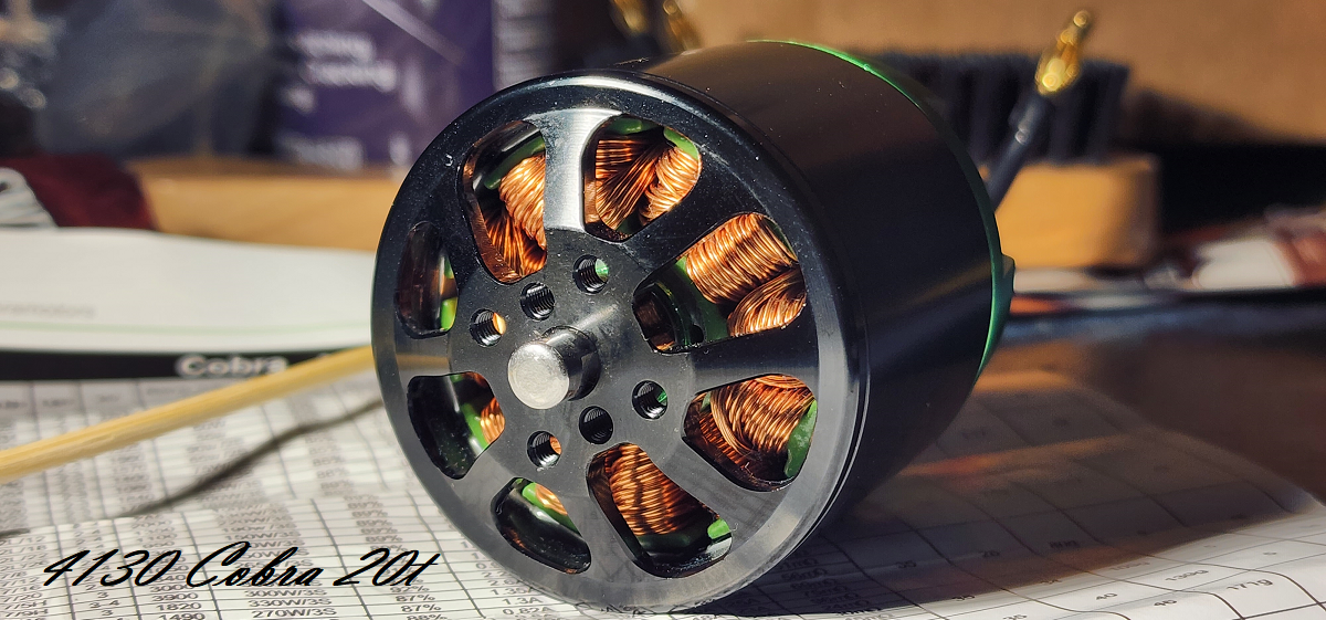

#104

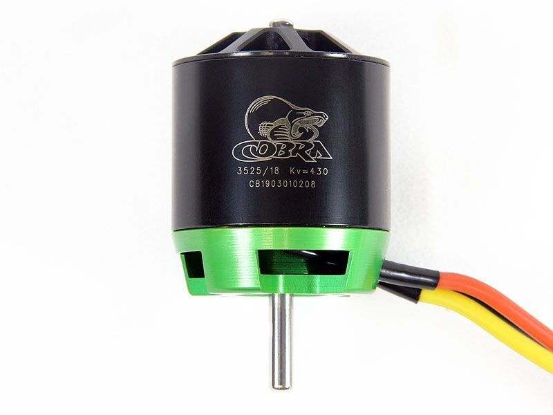

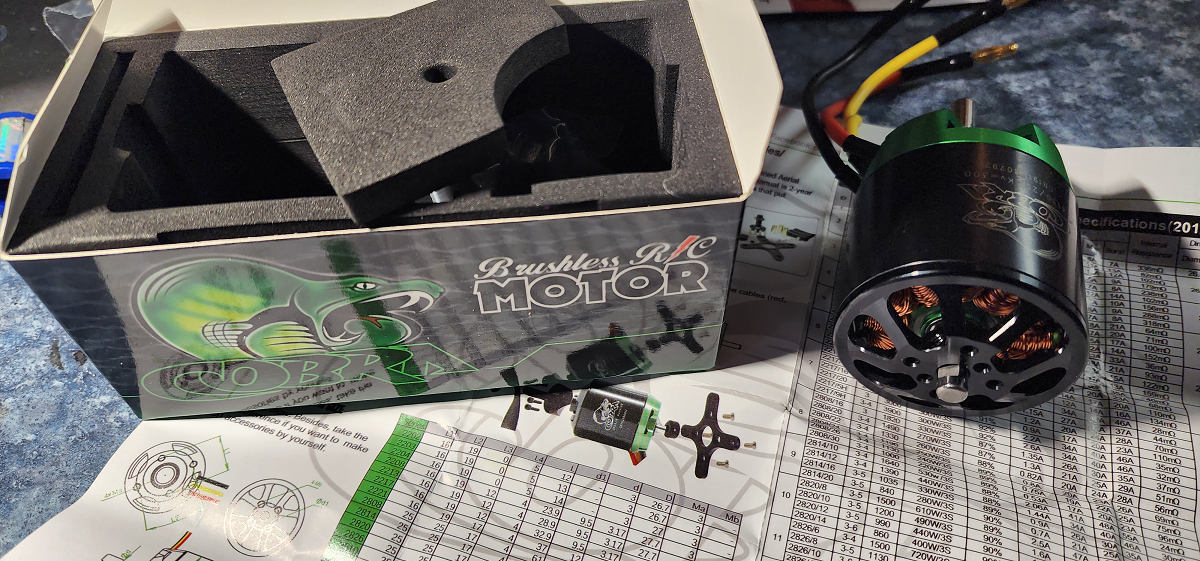

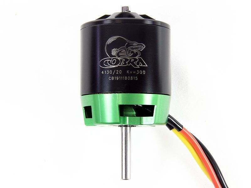

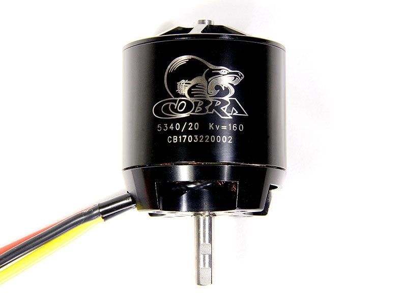

My choice for a traditional cut 12N14P machines to rewind. Lets see how the Cobra 4130 compares to a 4225 Scorpion....This is the American black and gold.
This will be the "Black Karma Cobra".

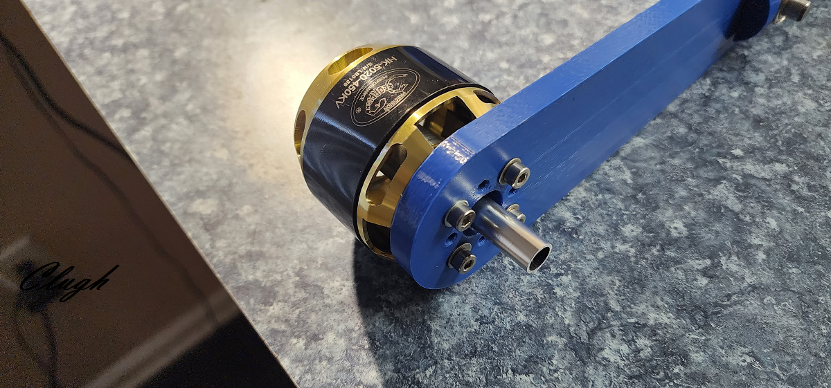

#105

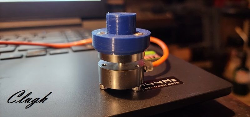

"I don't really like it and already have a much stouter design in mind but it gets the idea across for now. When its finalized ill have this all done in Carbon fiber composite or T6. Now I have to draw up a flange that mounts the load cell to the x mount extrusion table it will all be mounted on. 3 M3 bolts wouldn't secure properly 20Kg in my mind so maybe I wont worry about it.. I just get concerned in reverse is hit with a load that sends the arm in a tensile direction versus compressive. Best to enclose it all still. It would have been better to build it where the entire link is the diameter of the load cell and hide the mounting bolts. The bottom half of the link would fast to the load cell but its in 2 pieces the the base has a big male cog the top half of the linkage accepts. Then from the top view one bolt runs down thru the middle of the entire linkage assembly and holds it together. In T6 or carbon fiber that will be very strong. The holistic linkage rod would be 25 mm in diameter. Ill also narrow the slot just wide enough to fit the arm and bearing flanges and 2 shims inside the channel. Heavy duty use needs more meat in the area of the 16mm bearing bosses. If you or your friends have ideas feel free to share them. Ralph is at the forge so Ill print it.
~Clugh~
And so I revised it. The flush 3mm mounting screws for the load are invisible when the piece is pressed in and bolted together with one boot through the center of the entire assembly. Its stout and the interference fit is nice and tight. The load cell mounts seamlessly to this before the assembly is pressed and bolted together with a 6mm cap head and recessed blind nut. When assembled it appears you just have a nice 30mm rod attached to the 20kg load cell.

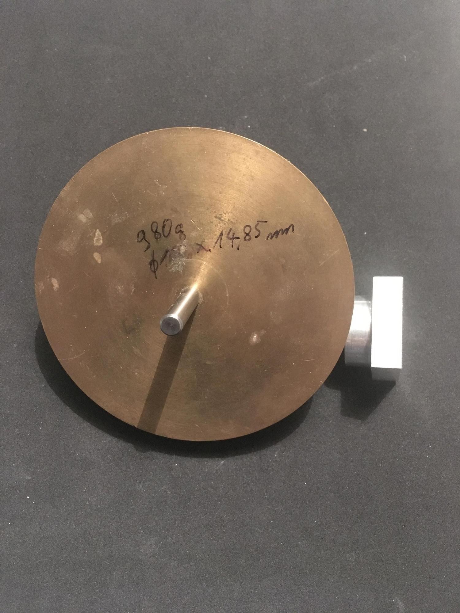

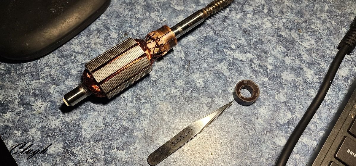

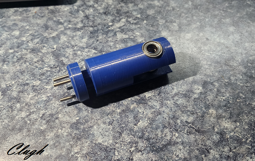

#107

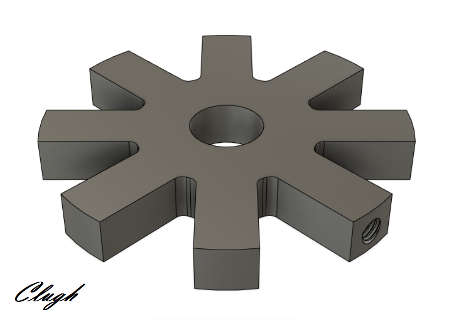

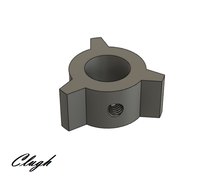

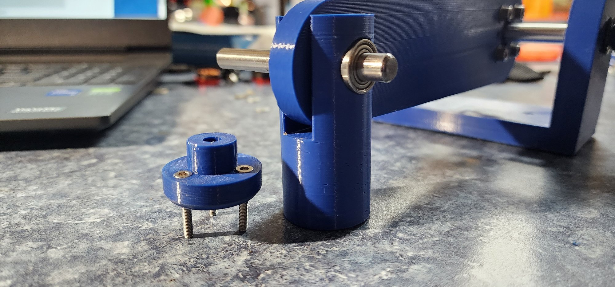

A rotor shim for the 8mm shaft. It will be bored perpendicular to the axis and the roter bell set screw goes through it and engages the 8mm shaft.
That was easier that grinding a special shaft .

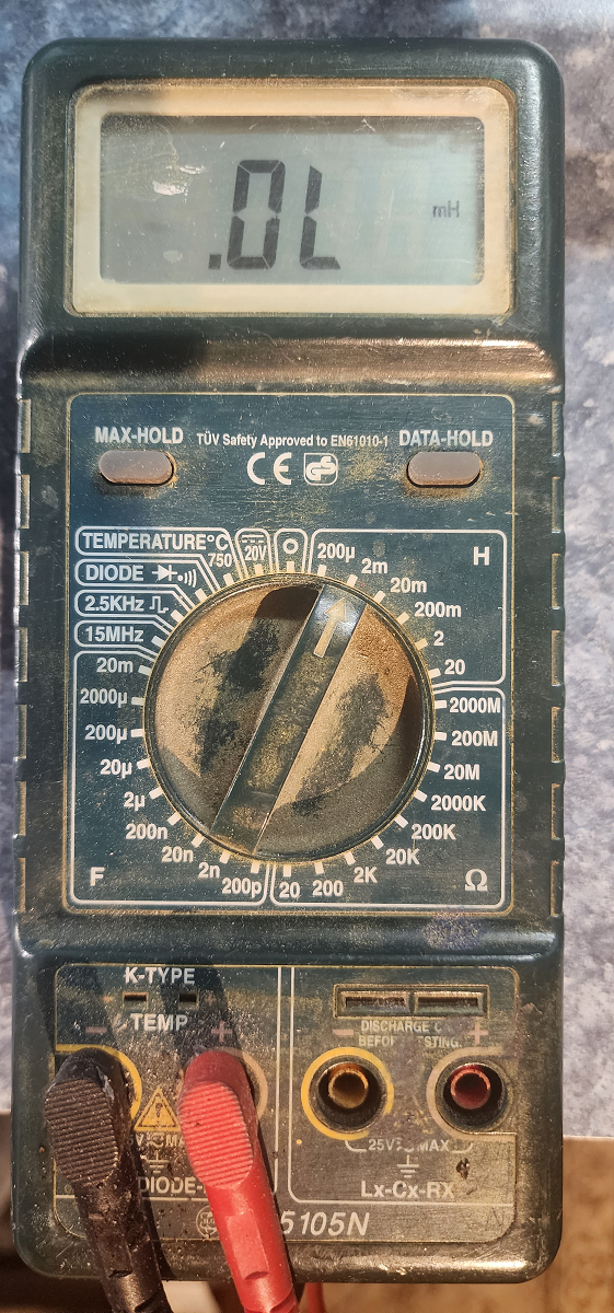

If the windings were in I could easily tell you the cogging torque right now.. Currently its the load generator. The prime mover motor mounts have to be printed..

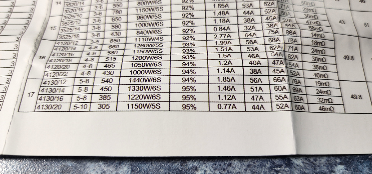

#109
Ralph 4225 Eta is 93% His super knocker is 95%
But so is this out the box for 8 dollars.
Poor Ralph this i, s much better than a Cots scorpion.
maybe he can explain it away...
Cobra 4130 20T delta
Kv300
Io .77 amps
Rm 45milliohm
396 grams
It has soo much room under the hood. It will be fun and we have real ways to measure it.
Regards
Hubert

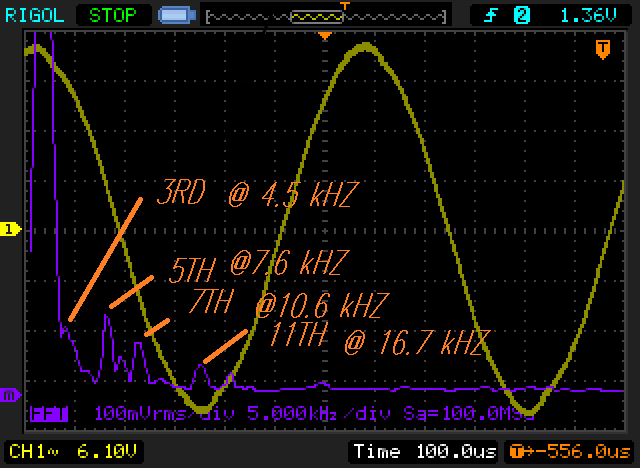

#110
He says no one is listening here so why is it that Scopion now post its phase INDUCTANCE. what other company does it?
For an A 4225 the measured the Motor Inductance (phase-phase) @ 1khz 10µH
These amateurs wont engage the question that even the manufacturers find relevant. This does not garnish guru status to not know better.
https://www.scorpionsystem.com/catal...es/A_4225_500/
Its is also a 5 turn delta its idle current at 15 Volts is1.54 amps. 9xs less than a power ditto hk4225 DD
What test do you need? The AC performance of those power ditto machines is obviously nothing stellar. Alot of reactive not real power. The PF is less than others im almost sure with such ac/dc imbalance.
All you need is a scope to see that forum mouths dont matter.
Someone whos test methodology is to test two motors head to head at different voltages has not a clue.
The real engineers at Scorpion must not share much with their autonomous winding machine
Despite dc resistance who would think increasing the idle current 9 times an improvement. Also the power report from dc ie current and voltage does not mean much it the current and voltage are so outta phase the power report is mostly reactive.

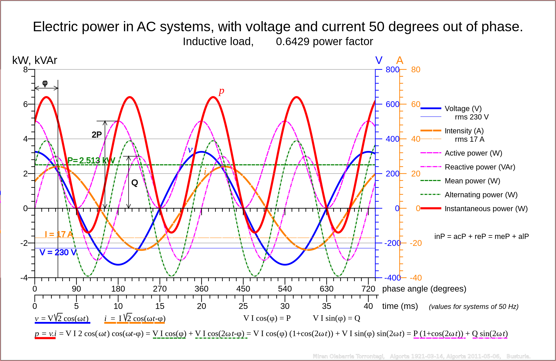

The harmonic content also has effect on the power factor which you see here is very poor at 64%. because the current and voltage are 50 degrees out of phase. he cant determine this in his plane or a static stand. He talks about test. Well then he should perform some real ones and he doesn't have to report a thing just post the waveform capture and two cursors!!!

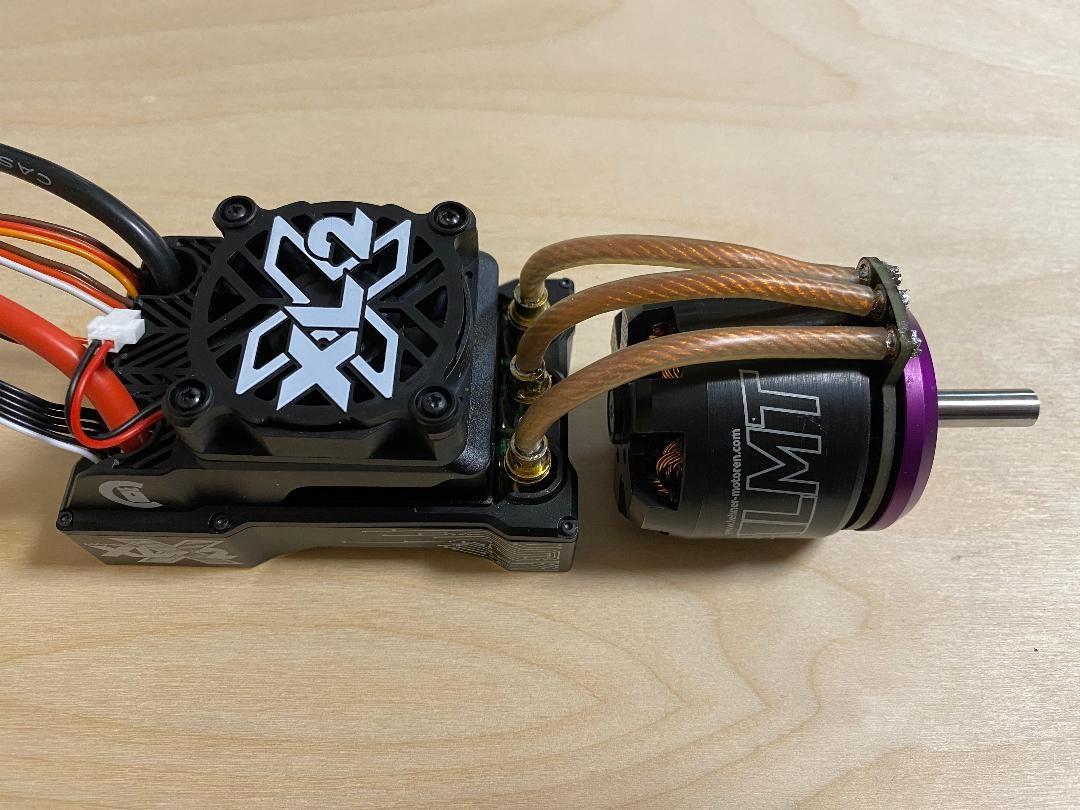

Hi Micheal
Christian send his regards to me about inertial flywheel testing of the motors.. You know this Im just being redundant.
"Hi 1BOHO,
yea, a wonderful idea to build a flywheel test bench. I used to do exactly the same thing when we used to race 1:12 RC cars. We used this to test the engines very quickly in limited classes before the race. Accelerate once and the whole diagram is generated. Like Associatet's Mike Reedy, we used magnetic pulse discharge through the motors to better magnetize the magnets and imprint a timing angle on the motors before the races. The engines had to be used unopened. Later I measured our brushed motors with flywheel mass test benches. I still have a brass disc with a diameter of 100 mm and a thickness of 14.85 mm for the flywheel. The disk alone weighed 980 g with the couplings and shaft + bearing then a total of 1000 g. These are super good measurements and, above all, you only need very little time for one pass. I've attached a picture of my flywheel. I also have a CFRP flywheel for very high-revving engines that weighs 500 g, but a friend of mine now has it and uses it to test aircraft fuel pump drives.
The XLX2 is there too. Will do some tests with it in the near future. I've had the Bluetooth link cable from the normal Mamba controller for a long time.
And yes, you're right, I'm back to normal, which I enjoy, no matter what the Kuperbieger troop tried, they didn't realize how important the electronic controllers are for brushless motors anyway. We used to learn this very easily with the brush motors and tuned and optimized the motors with the collectors. They didn't even know about electric flight, etc.
To messure amps i use LEM wandler that we adjust to higher amps load"
Happy Amps Christian
Hubert
"Hi 1BOHO,

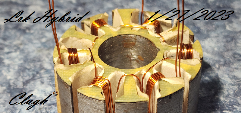

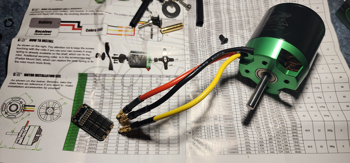

#118

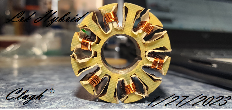

Hi Micheal,
There seems to be alot of confusion about how the winds and inverters work on RC-networks.de.
In the mean time I thought Id show you how easy it is to wind our LRK hybrid. I developed the wind and you may try it. You may not sell it. Its simple to do. When you wind deltas you always end up with 2 strands or two bundles, a start of one coil and the end of another, for the motor terminals UVW. That said its easy to assure a single wye never starves the dual delta and you have no solder points. You can also almost always assure the motor has a mostly filled bobbin. First wind 3 teeth at 120 degrees from one another all in the same direction anmd leave start and end leads long. Okay when you merge the starts and end of these coils you have the 3 coil deltas phase terminals that would normally feed to the inverters ABC (UVW). You take the two wires that make each phase terminal of the Delta and wrap them 1/2 the number of turns you did the delta. These are your open ended wyes which are essentially embedded load reactors for the inner delta. The two winding sets are also shifted 5α.
And so it looks deceptive as an 8 turn LRK but it is a 8 turn delta series wound to a 4 turn wye machine all in the same AWG.
Itz a 12 turn Y-Δ hybrid
Regards,
Hubert

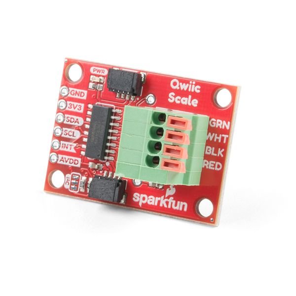

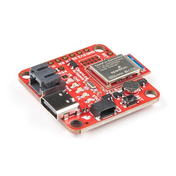

Hi Micheal,
This is the data acquisition system I chose because its open source and plug n play on all the senor calibration set up etc.
This is the way to test your motors true mechanical output then you will know you real efficiency and power and remove the Jurrasic bs from the equation .
SparkFun OpenLog Artemis is an open source data logger that comes preprogrammed to automatically log IMU, GPS, serial data, and various pressure, humidity, and distance sensors. All without writing a single line of code! OpenLog Artemis, or "OLA," automatically detects, configures, and logs Qwiic sensors. The OLA is specifically designed for users who just need to capture a lot of data to a CSV and get back to their larger project.
Included on every OpenLog Artemis is an IMU for built-in logging of triple-axis accelerometer, gyro, and magnetometer. Whereas the original 9DOF Razor used the old MPU-9250, the OpenLog Artemis uses the latest ICM-20948 from InvenSense capable of nearly 250Hz logging of all nine axes. Simply power up the OpenLog Artemis and all incoming serial data is automatically recorded to a log file with baud rates up to 500000bps [1], supported! The OLA also has four ADC channels available on the edge of the board. Voltages up to 2V can be logged with 14-bit precision up to 1900Hz for one channel and 1000Hz logging all four channels. Additionally, based on feedback from users we've added an on-board RTC so that all data can be time stamped.
The OpenLog Artemis is highly configurable over an easy to use serial interface. Simply plug in a USB-C cable and open a terminal at 115200bps. The logging output is automatically streamed to both the terminal and the microSD. Pressing any key will open the configuration menu.
The OpenLog Artemis automatically scans, detects, configures, and logs various Qwiic sensors plugged into the board (No soldering! No programming!). Currently, auto-detection is supported on the following Qwiic products:

The SparkFun Qwiic Scale is a small breakout board for the NAU7802 that allows you to easily read load cells to accurately measure the weight of an object. By connecting the board to your microcontroller you will be able to read the changes in the resistance of a load cell and, with some calibration, you'll be able to get very accurate weight measurements. This can be handy for creating your own industrial scale, process control or simple presence detection. Utilizing our handy Qwiic system, no soldering is required to connect it to the rest of your system. However, we still have broken out 0.1"-spaced pins in case you prefer to use a breadboard.
By connecting a load cell to the Qwiic Scale you will be able to translate sensor data into something your microcontroller can read. The NAU7802 is an ADC with built in gain and I2C output to amplify and convert the readings from a standard load cell. A load cell is basically a device that translates pressure or force into electrical signals. In most cases this signal is very small and needs to be amplified. There are many popular chips that read the change and amplify it, but the NAU7802 goes one step further and converts everything to a true I2C output (attached to a Qwiic connector).
The board provides a four spring terminal to connect your load cell with no soldering required. In addition to the I2C pins, the board also breaks out an interrupt pin and AVDD to the edge of the board. The differential input signals (plus a second set of input signals) are broken out to the middle of the board, as well.
Note: The I2C address of the NAU7802 is 0x2A and is hardware defined. A multiplexer/Mux is required to communicate to multiple NAU7802 sensors on a single bus. If you need to use more than one NAU7802 sensor consider using the Qwiic Mux Breakout.
The NAU7802 Qwiic Scale can also be automatically detected, scanned, configured, and logged using the OpenLog Artemis datalogger system. No programming, soldering, or setup required!The SparkFun Qwiic Scale is a small breakout board for the NAU7802 that allows you to easily read load cells to accurately measure the weight of an object. By connecting the board to your microcontroller you will be able to read the changes in the resistance of a load cell and, with some calibration, you'll be able to get very accurate weight measurements. This can be handy for creating your own industrial scale, process control or simple presence detection. Utilizing our handy Qwiic system, no soldering is required to connect it to the rest of your system. However, we still have broken out 0.1"-spaced pins in case you prefer to use a breadboard.
