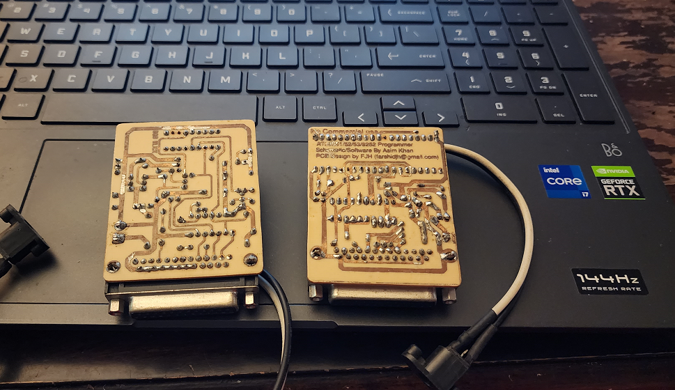

I take it you and Audiosmith have never built an electronic device.. These PIC and ATMEL MCU flashers were built by hand eons ago with laser jet templates and etching solutions.
Regards
Hubert

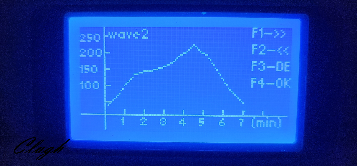

U run your mouth like this in Germany but are standing in here front and center for inverters 101 early in the AM. So I share with you some of the ramp options of a reflow oven in 2023.
