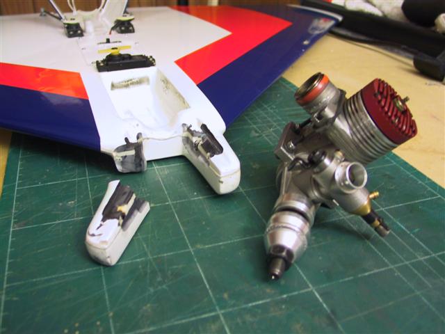

I've had about 8 flights now with my Whiplash and I have to say I'm impressed. Very fast and very stable. Very fast roll rate. The Rossi 53 is starting to loosen up. Running a APC 10x8 prop at the moment. No idea of the speed but fast.
However, I found that the engine vibration was loosening the mounting bolts. Kept tightening them up, but noticed that the vibration was fretting away the bolt holes, so all I was doing was pulling the bolt heads through the engine mount.
On the last flight a hot landing broke one of the engine mounting beams from the model. Has anybody got any ideas of how to fix it. I'm thinking of maybe removing the other one and letting in some wooden engine bearers. I need to think about this one before I do anything. Ideas are very welcome.

If you aeroepoxy the urethane piece back into place, once you bolt the engine back on the engine will reinforce it, actually recess flathead screws from the belly of the bracket, and then use elastic stop nuts on your engine bolts, that way the bolts will not back out and it will also give you a flush underside..
if you dont have aeropoxy, please call the office monday and ask for me or Dan, we'll get you fixed up..

also. if you take a bit and drill a hole into the mount on both pieces, then aeropoxy it in place, it will hold tgother better.. or if you can find the box it was shipped in, just send to us and we'll fix it for you...

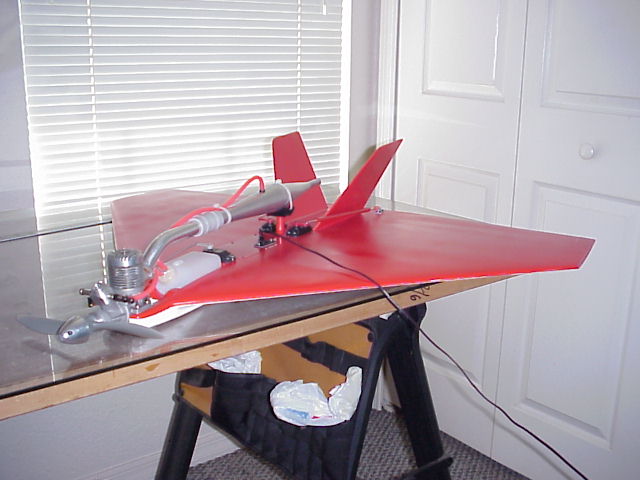

This is my Whiplash all ready to test fly (serious rain storm this morning, will have to wait till tomorrow). Great ARF, fit and finish excellent, customer service, best in the industry (at least the best I've come across). The only thing in kit not used were the elevon push rods, made up Dave Brown arrow shafts. Used heavy duty servo arms on Hitec 5645's, close but no clearance problems with fin.
Rick, is there any Whiplash decals available? Or maybe you could e-mail your Whiplash logo that I could print, scan and get a decal cut locally.
