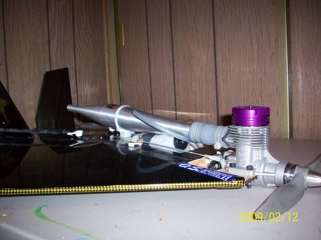

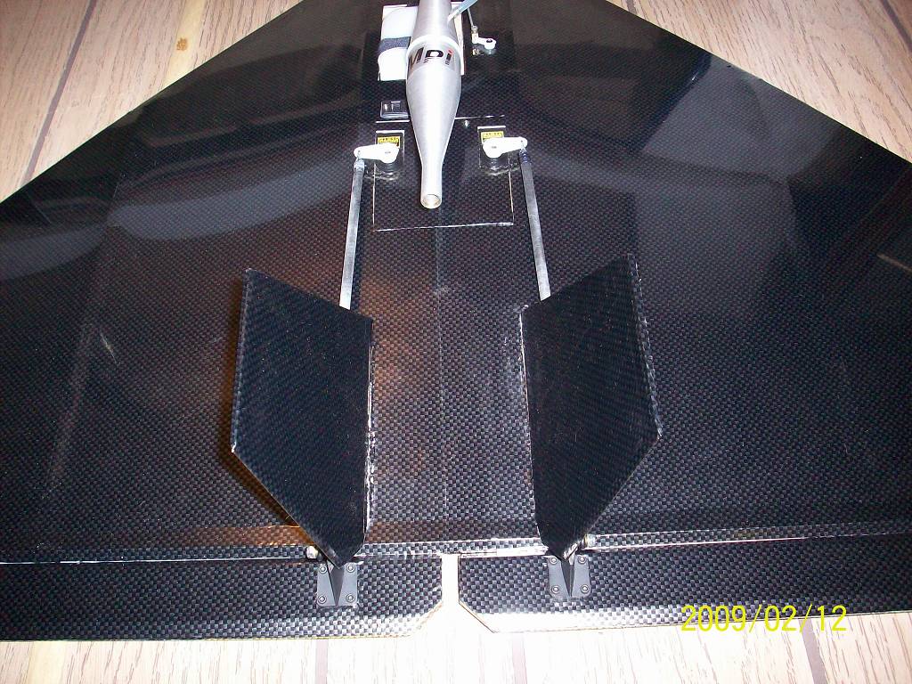

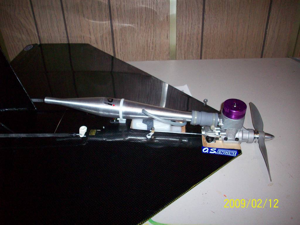

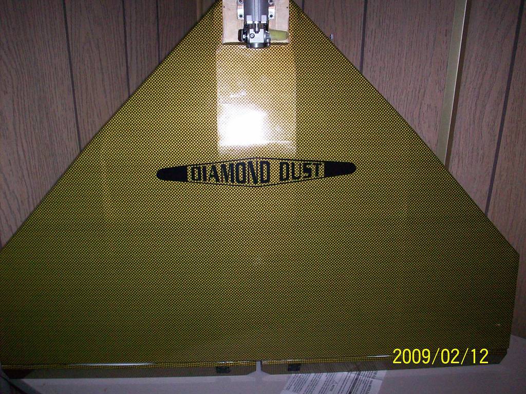

Ok i have been flying the DD for a yr now and i know it should scream!! I have flown it with these props 9/7 9/8 9/8.5 9/9 and would like to know if im not usen the right one or do i need to trim the pipe a little or what. im also using the OS header pipe that comes with the engine. is that good enough or not.

Go to Pspec for a APC prop in the 7.4x8.2 range, some head and liner shims and play around with that. If you can come up with 20,000 or better that should be worth trying to fly.

The pipe is the one OS requires for the engine so assume its pre tuned.

Ooh, yeah. Those engines are timed for 20k++. Those props are wayyyy too much load, unless as CP suggests the pipe could be tuned for those prop sizes, in which case you might be zipping around pretty good but the engine is impatiently tapping its foot waiting for you to let it rev. You're lugging it in other words. In Europe, for pure RC speed models, they run props as small as 6.5x10 on .45 DF engines.
First kick at the cat I would say trim an 8.8 x 8.0 APC pylon prop down to 8" diameter and get thte thing over 20k. I wouldn't recommend the 8x8 sport prop.

and no the pipe isnt pretuned, wait till you take a inch or more off the header then you might see it perk up, go to macspro.com and read their instructions on how to tune the pipe system, the df 46 should spin the 9x7 @20k rpm if the pipe is set right

Your pipe looks short if anything, so don't cut till you run the correct prop. Those small hub non pylon props(sport) are a bomb waiting to go off, luckily you had too much prop to reach the high rpm. You need APC carbon props!
Mac’s pipes and headers are what I use. The #1050 Quiet pipe, #1250 Muffled and the 1150 tuned (noisy) I have all tried and all work well!
To my biggest surprise the quiet pipe rendered the most speed, at least measured on the ground. The best average pipe setting was 9 ½†from center of piston to the large diameter on the pipe.
The highest speed measured was 24,500 RPM (on ground) spinning a APC carbon (LP 74825C) 7.4X 8.25 on Power Master 30%Heli fuel. K&B HP glow plugs
