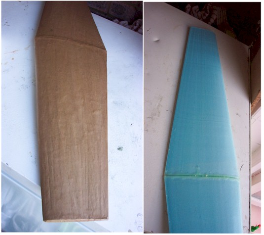

At first I covered the wings in BrownPaper, but felt it added too much weight, so I went for 0.6oz glass cloth and Polycrylic, also provided a nice smooth finish.

Rather than add un needed weight I'm using .6oz cloth and poly-c
