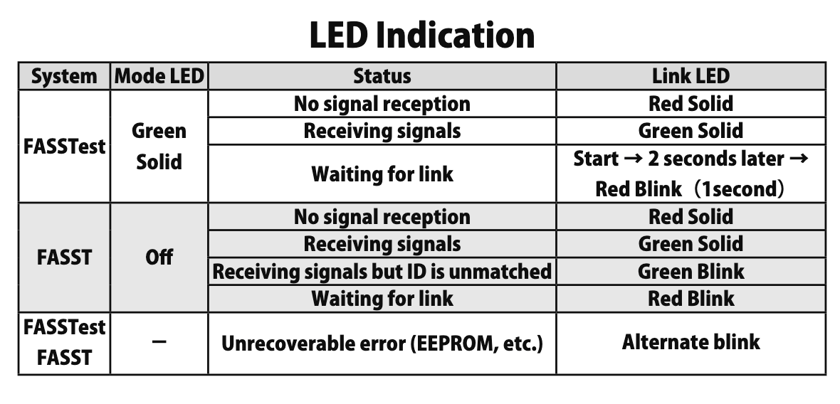

Old 02-17-2021, 12:38 PM
Cfe7
Join Date: Feb 2021
Posts: 9
Originally Posted by FUTABA-RC View Post
Yes it is.
First-set the RX mode to FASST
Then use the Multi FASST protocol setting in the System type menu of the TX.
Linking is done by turning the TX on and holding the TX antenna close to the RX antennas. Then hold the LINK button down on the RX while turning it on. It will blink red, then go solid green.
There are two LEDs near the antenna end of the RX. One in the MODE LED the other is LINK. Both will be green when the RX MODE is FASSTest and a signal is being received. Only the LINK LED will be green if the RX mode is FASST.
The RX is set to Fasst normal mode (and locked there). TX is set to Multi Fasst mode. When I try to link them the LINK LED blinks 2-3 times red, then 2 times green before it goes over to rapidly blinking red/green. After this LINK LED will blink green (slowly). I never get a solid green LED.
I missed something somewhere - didn't I?
Old 02-17-2021, 12:48 PM
FUTABA-RC
FUTABA-RC's Avatar
Join Date: Oct 2017
Posts: 1,174
Received 22 Likes on 22 Posts
To confirm, when the power is on to the RX with the TX off you should see the MODE LED = OFF and the LINK LED = solid RED.
When you turn on the TX the MODE LED is still off, but the LINK LED Blinks green.
Correct?
If so this means the MODE is set to FASST but the RX is seeing a FASST signal but from a TX that it is not linked to.
I suggest making sure both TX and RX battery are fully charged, move away from strong WiFi signals in house (routers, etc.), and get the RX and TX antennas as close as possible.
Then with the TX already on (in you normal flying screen) Hold down the LINK button on the RX and turn on the RX. Only need to hold it for a few seconds. Once released it should go solid green. I always cycle power on both RX and TX after linking.

Old 02-17-2021, 01:41 PM
Cfe7
Join Date: Feb 2021
Posts: 9
The Led status you decribe is correct.
It didn't help to move away from all noise sources in the house, so now I'm charging the RX battery.
3.9 V was maybe to low for this kind of RX - or should I instead plug in a 2 cell LiPo directly?
Old 02-17-2021, 01:51 PM
FUTABA-RC
FUTABA-RC's Avatar
Join Date: Oct 2017
Posts: 1,174
3.9 volts is very low. You can plug a 2S lipo in as long as any connected servos can handle that voltage.

There is no binding possible. Both RX behave as described earlier.
