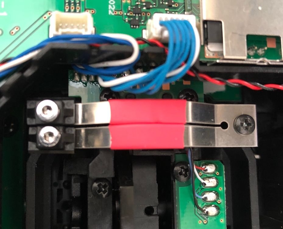

Hello Bill,
Can you advise whether the 32MZ has a replaceable throttle friction quadrant like the 18MZ?
pics attached.
Malcolm

No, it works like the 14MZ/16SZ/18SZ. There are two screws on the back of the TX. On a Mode 2 TX the screw on the left adjusts the ratchet, the one on the right adjusts the smooth stick friction. I found I need to open my 32 up and put a piece of heat shrink on the smooth spring leg to get the friction I wanted. Easy to do, just have to watch the wires for the 2 switches on the TX back.
You back out one before adjusting the other, otherwise they tend to overlap and it makes it hard to get what you want.

Understood Bill,
But what does the spring leg rub against if not a plastic piece like above?

There are two pieces on the gimbal. One with ratchets for the ratchet leg to run on and a smooth one for the smooth leg. You do not need a separate piece like the 14SG uses.

Would it be possible to get a pic of the back of the stick unit showing what rubs against what?

Sorry for the delay. I should have paid more attention the first time. There is a small piece of smooth white plastic on the throttle. Not sure if it is the same as the other gimbals. I put some red shrink wrap because my smooth friction was not as much as I like. This is my left stick. I fly Mode 2.

Thank you Bill,
That is very helpful.
Malcolm
