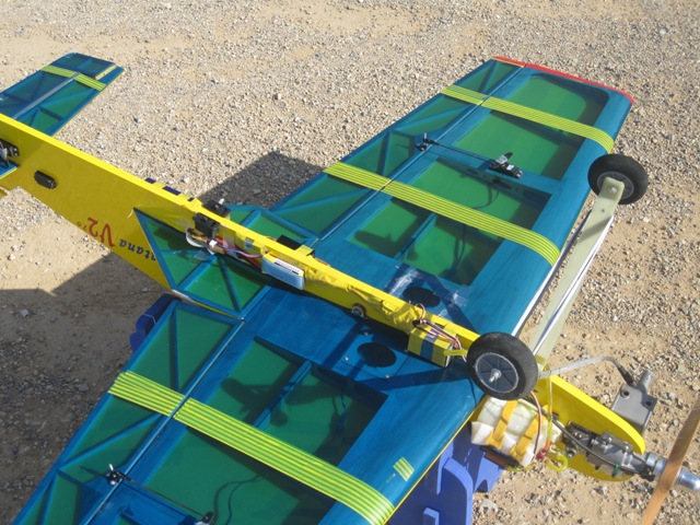

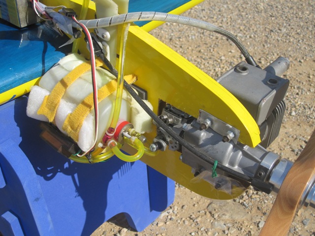

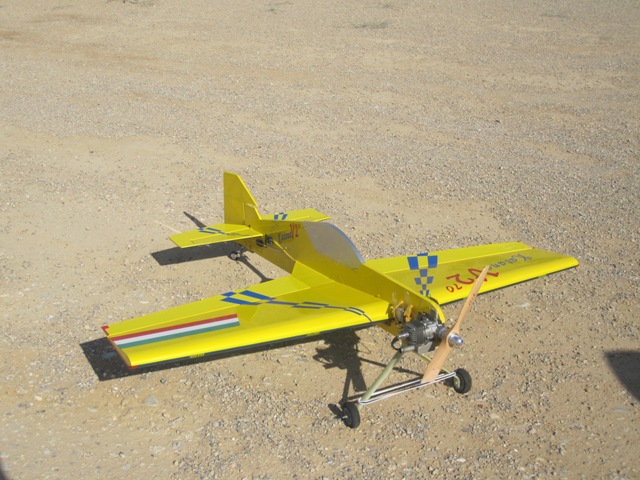

I have installed the DLE 20 on a KATANA 70 V2 from OMP ( www.topmodelproduction.com/<wbr></wbr>katana70V2.htm )
below are the specs:
DLE20
Prop: Xoar 17x7 @ 7600 (didnt touch the tuning needles yet) running rich
fueltank: 180cc (6 Oz)
Servos: Power HD90 all the way round
Battery: RX: 1,600mah 2S Lipo IGN: 1050mAh 2S lipo
flying weight: 3100g (6.8 Ib)
great flying, pulls straight up even with such a rich mixture. once i tune it would be a rocket. the wing loading is low so im able to fly the plane relativly slow.

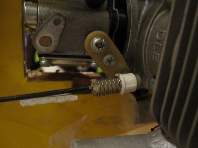

$2.09 throttle arm for DLE 20
http://www3.towerhobbies.com/cgi-bin...&I=LXDMG1&P=ML
Will have to be drilled to 3/16" you will have to put the screw in the throttle arm before you drill it or the brass will catch and spin in the arm.

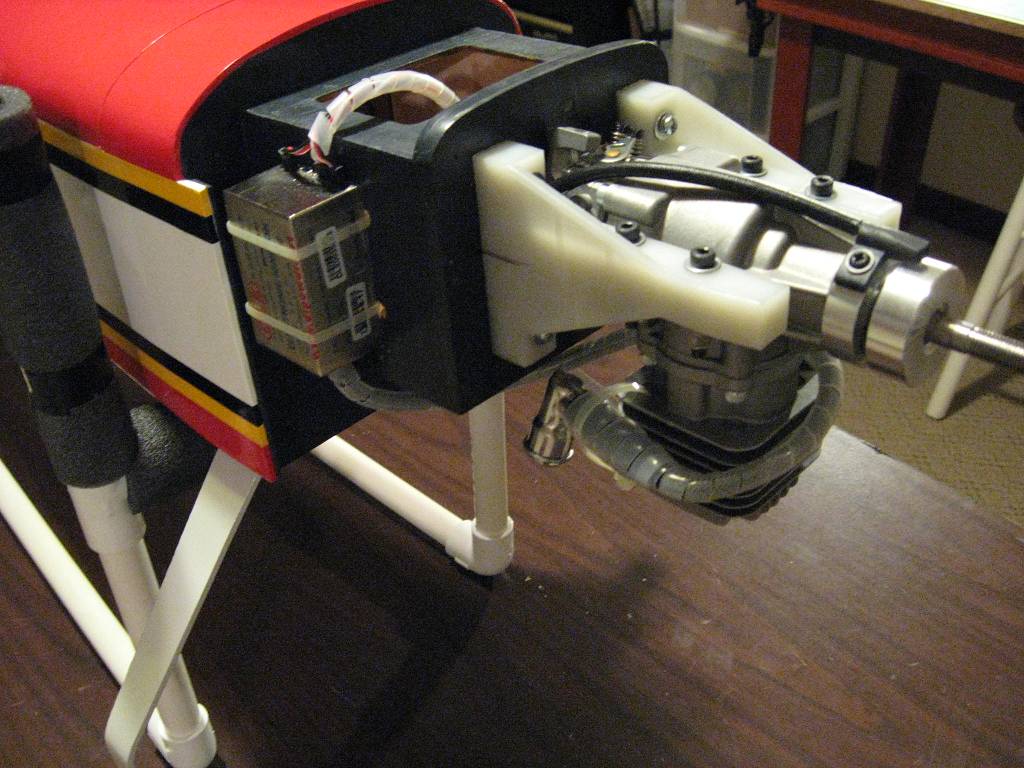

I am currently building a SEAGULL EDGE 540 90 size. Using a DLE 20 with engine mounts that come with the plane. Great Fit.

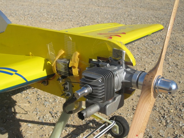

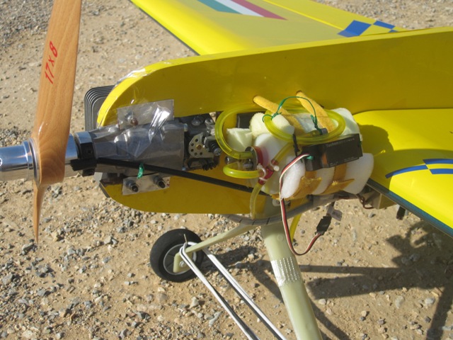

Mounted one on a Hangar9 Ultra Stick Lite 120 w/xoar 18x8. I used the recomended Dubro motor mount(DUBG1307).
No Cowl on this plane so I mounded the engine upright and had no problem with throttle linkage & the choke
is available for "finger" operation. I did reinforce the firewall and installed the ignition module & batteries
in the "tank area" and the tank on the CG. My other USL 120 has an OS 120. When I tried to purchase another USL 120
discovered that Hangar9 stopped production BUT upon checking for PARTS I was able to purchase everything
needed, fuse, tail, wing & landing gear all except hardware and at 72 yrs young and 50+ yrs in the hobby/sport
I have enough "hardware" to finish MANY planes! Sorry, no report on preformance yet as the weather has been to
cold & Windy for these old bones. The plane did need a tad (hope all know what a tad is) of tail weight. Did not
weigh the lead but it was a tad, couple of sq. of that stickon weights. (screwed them in place) Sorry for rambling
on so but I am getting Cabin Fever this Winter. Heck, it is not even winter yet!
Will have to be drilled to 3/16'' you will have to put the screw in the throttle arm before you drill it or the brass will catch and spin in the arm.

To give you a choice I just ordered the following throttle arm from AZTECH Aeromodels. It is alumonum and a little more expensive than what w8yr has proposed. I will let you know how it works as soon as it arrives.
http://aztechaero.goods.officelive.c...ccesories.aspx

My DLE20cc went in an AeroWorks PROX260 Freestyle 90 size.
Details.......
AW .60-.90 PROX260 ARF- QB
AUW= 7 lbs. 2oz
DLE20cc gas engine
Optic Remote engine kill system (42% Products)
MK3 Voltage Regulator Li-Ion (MPi Products)
Froemco 2600 mAh Li-Ion 2-cell (runs everything)
Hitec HS-5645MG Ailerons
Hitec HS-5625MG Rudder & Elevator
Hitec HS-65MG Throttle
Sullivan ball link (carb)
Futaba R608FS 2.4Ghz reciever
8 oz fuel tank (off an OMP)
Madison Components Ceramic fuel filter clunk
Stihl Ultra HP (synthetic) 30:1
Zoar 16x6, Vess 17x6, Vess 18x6 props.
Rcv, batt, regulator, ign kill, ALL went in one wing panel hatch.
CG as stated in manual is waaaaay off, and both sizes of this bird end up flying tail heavy, a bunch!!!
Be aware of that, and balance accordingly. AW states such was intended for Xtreme 3D'ers
Also; center ailerons to the center of the SFG's
Stock L-G is far too short for this engine with the preferred 17x6 props, so I put Tetherite L-G on to raise it up.
It'll hover round abouts 35% throttle, and pull-out is like a missle!
At 7lbs, this combo is flat out awesome!!!!
