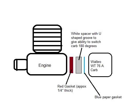

Well I know it has been several months since I last posted, but winter hit and I put this plane away...just bringing it back out a week or two ago to get working on it again. So here is the update.
As was stated by me last post...I bought a NOS (new old stock) Walbro WT 76a carb from ebay and installed it. I thought that would fix the issue, which it did in a sense as I was able to start the engine now with the new carb. However, it still has issues with being reliable.
I have gone back and forth with tuning the Hi/Lo needles and nothing seems to help.
I can set the Hi/Lo back to factory(appox 1.5 turns out on both) and get it started. Let it warm up (minute or two) and adjust the Hi to around 3 turns out total and it runs great. Transistion is great. No four stroking or anything. Very fast throttle response (as so Ive heard this to be the case with rotary valve engines) and has TONS of power. Note...compression is good (not tested as I have no way to test the PSI in the "dome") but feels very nice and tight.
Anyway...after this engine runs for about 8 or 9 minutes...it starts to sag for 2 or 3 seconds and then dies. Like its not getting any fuel. Its almost like its a heat issue...but checking compression (by hand again mind you) as soon as it dies...it feels just as tight as it did when it started. Plenty of compression IMO, but without testing it...who knows, right?
After this has happened, it wont restart reliably without going back through a cold start procedure...basically have to "choke on", flip it till it pops...then choke off 1/4 throttle and flip it and it will fire up, burble, sputter and die. IF, I am quick enough on the choke switch during the "burble, spurting" it will run longer...but then "choke off" it will still die.
I havent waited long enough in the same day for everything to cool down to a "cold" condition and try again...but a couple days later I can start this whole procedure over again and it will run fine for the first 5-8 minutes and ...well rinse, repeat all of the symptoms after that.
This whole series of things is pointing to me that there is a problem that arrises after the engine gets nice and warmed up...or possibly a fuel supply issue. Id rather think that its a heat related issue rather than a fuel line/tank issue because I would think that a fuel/tank/line issue would have the same problem ALL of the time. But i dont know as much about gas engines as I probably should.
One thing that comes to mind is that with the original carb...i had it on and off at least 3 or 4 times. And with the new carb Ive had it apart another 3 or 4 times (not the carb itself...but removed the carb from the engine). So maybe after the engine gets up to normal operating temps...I am getting an air leak somewhere between the intake and the carb. There is 3 spacers/gaskets and perhaps they need replaced?
I did talk with someone about this at TBM and he said it sounded like a compression issue. I really dont think that it is after reading all over the net about it. And like I said...this engine "feels" like it has great compression...cold OR hot. So Im still thinking it is carb or spacer/gasket issue. Unless there is something inside the engine that could cause this symptom once it gets up to operating temps. I have not had the engine apart. Only the spark plug out and the carb off. And really I wouldnt know what I would be looking at even if I did take the engine apart.
While I dont have any pics of the engine or carb or spacer/gaskets...here is one I found on the net (i will take pics and post them if needed...its just I havent taken the engine off the airframe at this point again, but will if I need to.
Im not even sure if the above pic is a zdz40, but it looks the same. And I only wanted to point out that my 40 has the slit shown in the pic to the left of the intake hole. It also has the thick red gasket with the hole there (mine was plugged up initially and I cleared it...but then it wouldnt pump fuel so I plugged it back up) then next to that red gasket is a white spacer block with a U shaped groove milled into it (I take it this is this way so you can flip the carb 180 degrees and still carry the "pulse" to pump fuel) then a thin blue paper like gasket that goes between the white spacer and the carb.
I guess it would be good to just find all 3 of those gaskets/spacers and replace them. Possibly even a brand new carb...id be willing to buy one again as this "new one" was old stock and could have been on a shelf for years...thus giving me this issue. However, the guy I spoke to at TBM said that there was no carb that would work with my engine because of having to mill out something on the intake to line up the pulse? I guess the 76a carb is discontinued and the pulse hole on the replacement carb wont line up. I dont know...just what I was told.
So...any other input would be greatly appreciated. Even info to someone I could call that knows these engines inside and out and could sell me what I need to get this thing going.
When this engine runs for the 8 or so minutes...it runs like gangbusters! I can only imagine the power it will give to the Extra 300S it is installed in. However, no way in Hadees will I put this plane in the air only to have it deadstick on me!
Thanks for all the help in advance.

I had a similar problem and it was with the spacer. The original spacer was about 3/32" thick and it was made from an aluminum sheet. I called Mike Dooley "RCShowcase" now maybe still working at TBM and he sent me an upgraded thicker approx. 3/16" thick aluminum spacer. It now runs fine. This was back in 2003. I just checked my next generation ZDZ 50 and it only has one 3/32" thick redish in color gasket between the carb and engine.
I'm wondering if it quits in the same spot on the fuel tank level? If it does... is it the tank or is your ignition module overheating and shutting down. What about the condition of the ignition battery? Is it old and/or undersized?

As my drawing shows...there are 3 pieces involved. I'll call the reddish one a gasket as it seems to be made from some type of pressed fiber composite material. Then there is the white spacer block...seems to be made of like a butchers block type of nylon, then the thin blue paper-like gasket (which is thin like a muffler gasket on a glo engine).
The reddish and blue gaskets have a hole through them for the pulse. The white spacer has 2 holes in it, one on each side of the port opening and then a "U-shapped" channel milled all the way around. This is so you can have the linkages at the top of the engine(head side=top) or the bottom and the pulse will carry thru the channel.
I havent looked at it long enough to divuldge which orientation requires the use of the channel...therefor eliminating the need for the white spacer. Im only assuming it does as this is the way it was configured when i got it. But I will double check.
Anyway...I havent changed the tank out...BUT this was a brand new tank and hardware when I put this thing together last fall/winter. And when I put it together I did pressure test the tank in water to make sure it wasnt leaking. Maybe it has developed a leak and I have all new hardware and spare tanks tahtI could easily put together another tank and try it just to rule the tank out.
I cant verify that it stops at the same fuel/tank level every time as i have never put the exact same amount of fuel in it at each attempt at getting it to run.
Also...I havent tried another ignition as I dont have a spare one. This is the only zdz I have. I do have 2 other gassers...one being a RCGF 65 in a Yak 54 and also a CRRCPro 26 in a 91" Cub. It wouldnt be worth it to me to tear these 2 planes that run fine and are flying to use their ignitions as a troubleshooting tool. Maybe I can talk to someone in the club that might have an ignition laying around that I could test out.
I know one thing for sure though. This is my first, and LASTused gas engine I will buy. Actually i would buy another used gas engine...but I would have to see it fly for a considerable amount of time and then remove it from the plane right then and there...THEN I might consider buying it. For what I have in this used ZDZ...I could have bought a brand new DLE. I know...apples and oranges. But Ive just about had it with this thing! LOL

Sorry you are having problems with it. The carb bolts should be torked down to 8" oz. It's not much. (I use blue locktite). If the white spacer is cover compressed it could leak when warmed up. If you can, eliminate the white spacer and blue paper gasket. That's what is on my new ZDZ. Make sure the pulse holes line up.
My friend has a ZDZ60 that was hard to start and unreliable when it did run. We found that the base gasket on the cylinder was leaking which caused problems with the carb pulse. Just something to check.
