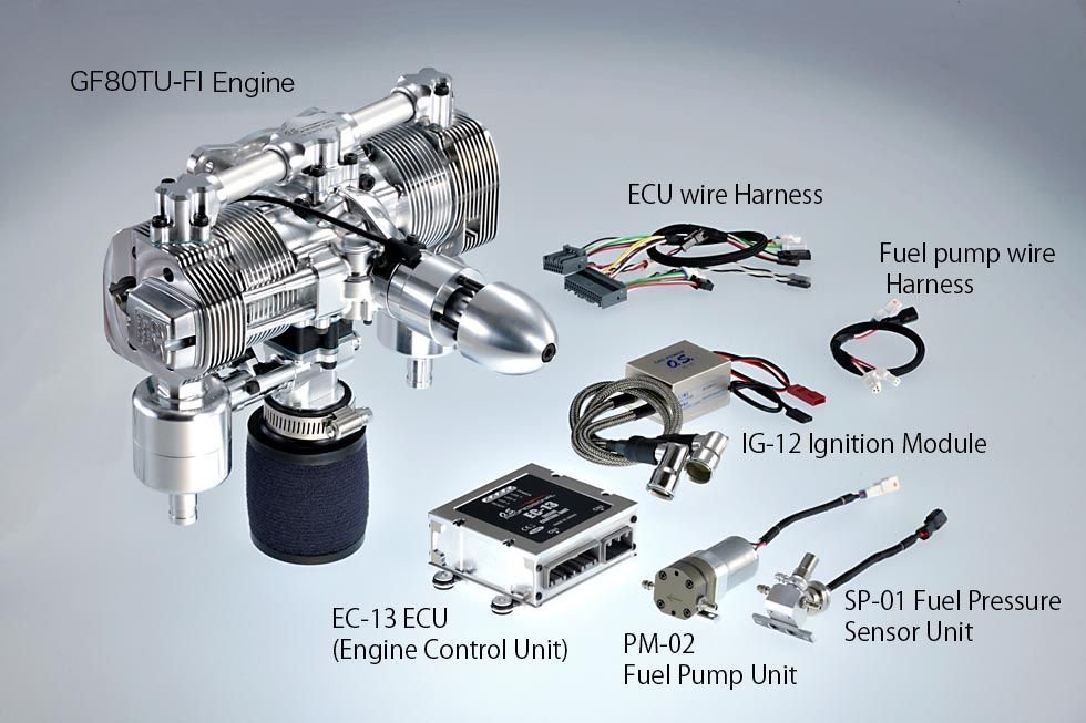

Aslo, seen the GF80 yet ? :-)
This seems to be a UAV engine, but still looks cool
