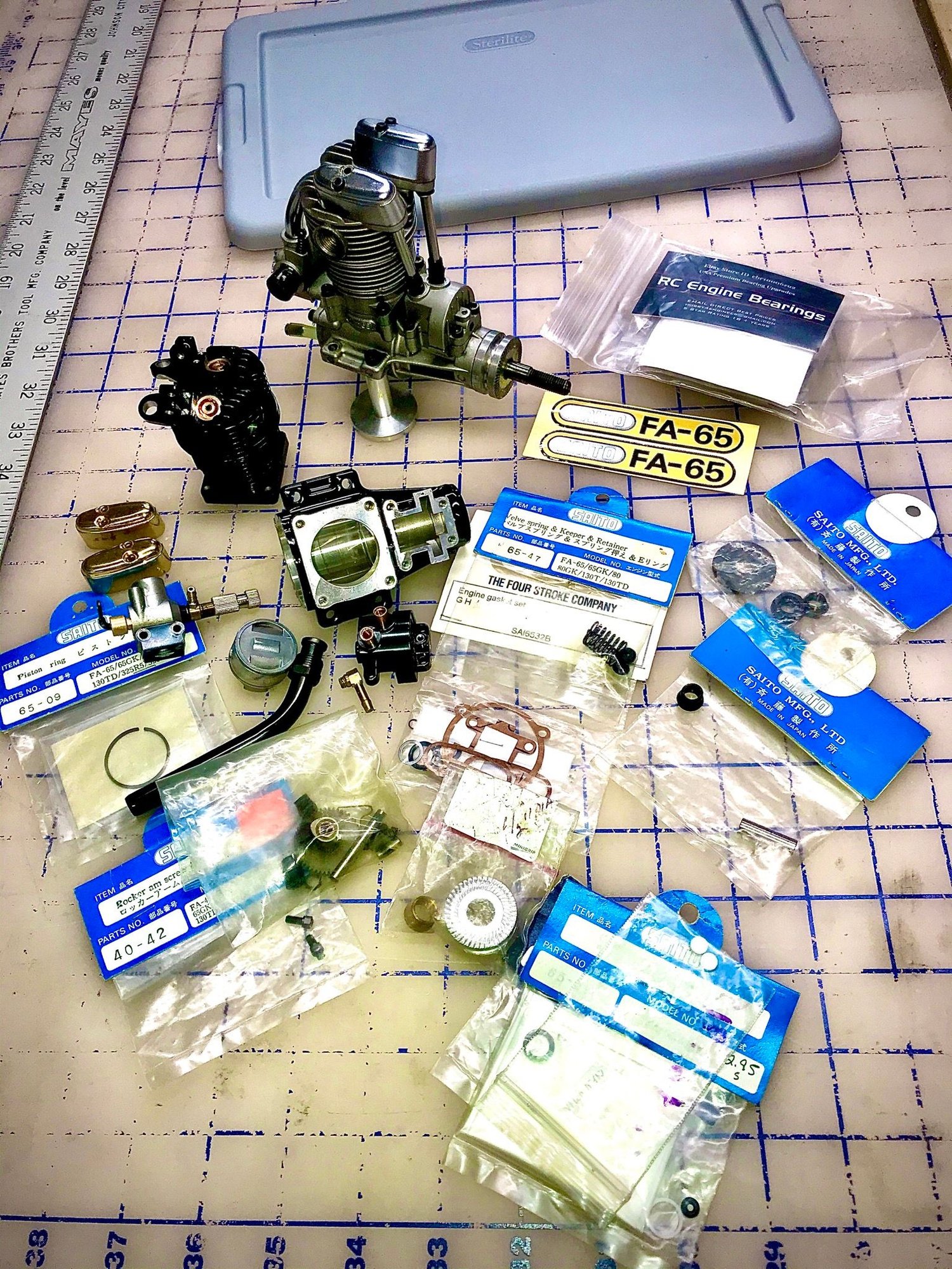

Originally Posted by rwijnhov View Post
The problerm is that cyliders break with even de lower compression pistons. Hence the thicker gaskets. Hope to fly the plane tomorrow and see if power is still enough for my at6.
Not aware of cylinder breakage with methanol fueled Saito radials.Could be that the low compression pistons alone fail to get the job done (?) Years ago I saw two Saito 80s fracture cylinders. Both of them were early versions with high compression. Saito soon made the subsequent engines of lowered compression. I made base shims up and had no problems with the 80s that I ran.
Right now I am building a high compression Saito 65. It will use a cylinder from the R 325 radial along with the bubble top high compression piston from a Saito FA-65. The 325 of course is a dual plug cyl.
Will also be running dual plugged CDI. The methanol fuel will be zero nitromethane initially.
