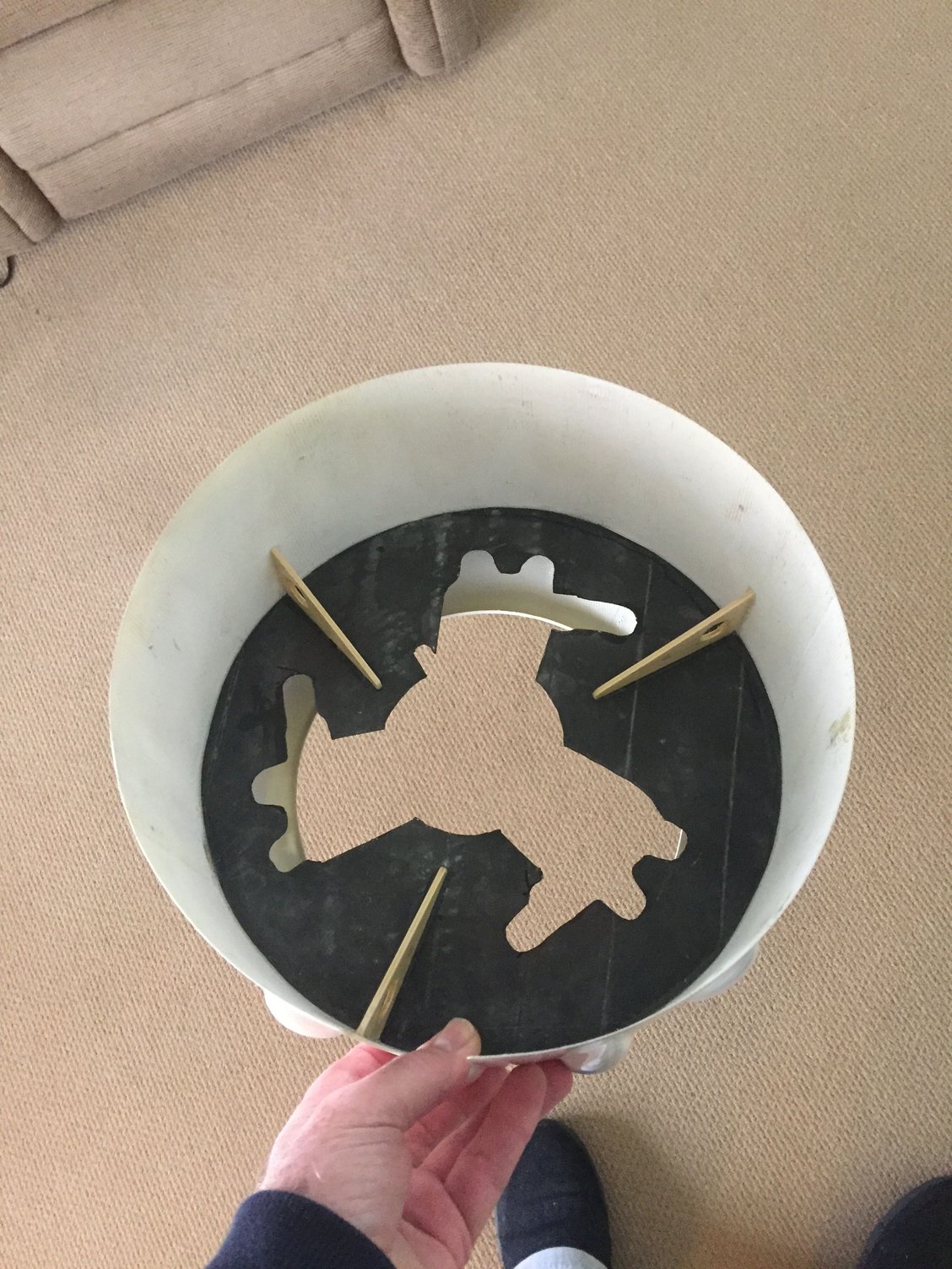

Originally Posted by mitchilito View Post
2) You are of course correct with regard to temp variations. This is why I tell everyone running these (or most any air cooled engine) to install effective BAFFLING. Look, you spent over a thousand bucks for this little jewel, don't you want to take as good care of it as possible?
My baffle was a lot more complicated to build...
https://www.modelbouwforum.nl/attach...-1-jpg.428046/
https://www.modelbouwforum.nl/attach...-1-jpg.428222/
Yet it weighs only 27 grammes and works a charm.

Looks good, Brutus!
