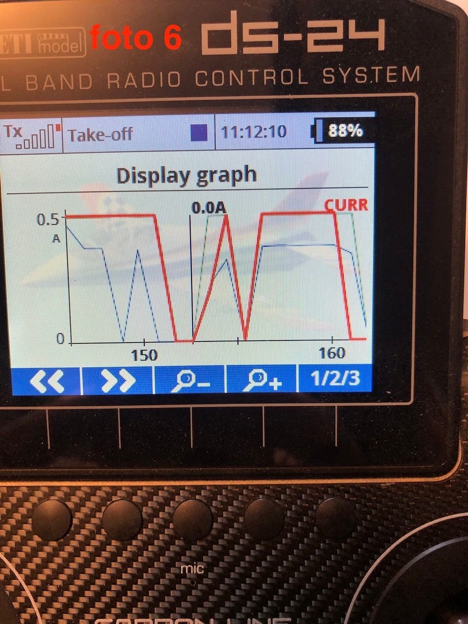

Hello guys,
I had yesterday for the second time an emergency landing (unfortunately damage this time) due to engine was stopping-running intermittently.
Luckily I have telemetry from my "Powerbox SparkSwitch pro" and you could clearly see it is ignition related due to the voltage of ignition battery dropped to 0V.
On ground could not reproduce the fault. When I disconnect the Saito ignition box from the SparkSwitch, the telemetry gives still the correct battery voltage,
With this in mind I suspected the fault was from battery -> cable -> SparkSwitch Pro.
All 3 items replaced so good to go. Engine runned flawless for 10 minutes on ground. Unfortunately after about 5 minutes of flight same problems as the first time it happened.
Now I suspect the Saito ignition box is intermittent short circuit, that results in 0V and 0A on the telemetry.
All cables are triple checked. Anyone any idea or experience with a faulty ignition box?
foto1: voltage ok, engine running normally
foto2: rpm ok, engine running normally
foto3; amps ok, engine running normally
foto4; voltage drops to 0, you hear the engine hesitate
foto5; rpm drop, you hear engine hesitate
foto6; 0 amps, you hear engine hesitate
situation1: batt, cable and SparkSwitch pro replaced
situation 2: disconnected ignition box from SparkSwitch and confirmed telemetry still gave voltage.

Didier, before you throw out the ignition, remove the Powerbox Spark Switch.....just run your ignition straight to a battery, or through a simple switch....if it keeps doing it, then its likely your ignition. If not, then its the Powerbox Spark..

I think that's good advise for Mr. Didier... I was looking at the radio readout he posted and I haven't the slightest idea what I'm looking at! (Way above my electronic paygrade?) You guys would probably GASP at my setup for the P47/FG60. Single battery, A123 2500, 2 outputs, one to a single switch to the receiver, the other lead straight to a RcXl Opti-Kill and to the ignition. You can't get much simpler than that!
I use the same setup in my 3D gassers and believe me, they use way more juice than this *****cat ever thought of using!

Only difference is telemetry from the switch. What you see in the pictures, is the ignition voltage dropping intermittently. This results in engine hesitation at the moment the voltage is dropping to zero.
In my point of few it has nothing to do with the "complexity" of the system. Actually the telemetry told me I have to find the problem in the ignition circuit and therefore not mechanical or fuel related.
As an aircraft maintenance engineer, this is the way we perform trouble shooting as well in the real world of aviation. Isolating the problem.
What makes it hard is that the problem is intermittent (due to vibration?) and I don't have spare parts to play with.
So the question to you guys still is: What is the "failure rate" of the ignition box of Saito and does anyone experienced the same issue?

CDI ignitions MTBF (Mean Time Before Failure) is not as high is you think, and they do fail. I have seen many instances on forums over the years where they start ‘behaving badly’, giving intermittent faults like you describe. Some have even failed out the box. They are creating a high voltage spark discharge so they have a finite life. That said, I have never experienced it myself and probably will one day!
They don’t like excessive heat, nor do they tolerate vibrations for long...people that hard mount them in the cowl are more likely to have early failures.
i have read and heard of the powerbox spark systems being unreliable, and when I chose TechAero BEC as my ignition system I use on all my planes, I did so because I have never seen a failure.
remove the powerbox before anything else...(edit to clarify) while you test to find the problem, not saying it is the problem, but start there...
