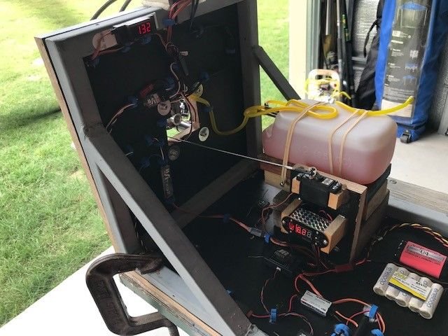

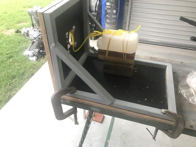

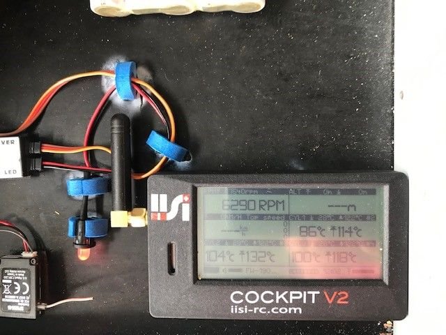

Old 11-28-2021, 02:18 PM
  #545
planenutzz
Join Date: Apr 2016
Posts: 248
Ran the FG90 on the weekend! What a beast. Was mounted to my test stand, no baffles.
Biela 3 blade FW-190 style 20x12 prop. 15:1 Klotz KL-200 and 98 Octane petrol.
Idle 1290 RPM, peak 6400 RPM though it was getting hot so only did a few bursts at full throttle. I am hoping that when I fit the baffles that will bring those temps down to reasonable levels.
I richend up the top end, low needle was already quite rich.
Engine ran for 84 mins on a 9050mL / 32Oz tank. What a miser! Most of the running was around 3000 RPM with a few burst to 4500 - 6000.
then back to idle to allow it cool down. Lots of burble in the transition which I expect as the mixtures are very rich. Copious amount of black oil expelled from the exhaust.
I'm also getting oil leaking from the exhaust fitting to the head. Is that normal?
My only concern now are those temps. No.1 actually was the best performer and numbers 2 & 3 were getting hotter.
Could be the petrol I was using as it was 98 Octane and I would suspect was making it run hot as well as hit that 6400 peak RPM.
I'll ditch that batch of fuel and use it in the old mower, mix a new batch of 91 Octane, fit the baffle and re-run it.
I did find that the choke rod with the threaded part was useless, pulling the throttle body out as far as it would go would go would not suck fuel but putting finger over the trumpet drew fuel very quickly. I think I will make something that allow for that style of choking when in the plane.
Engine was very easy to hand start.
