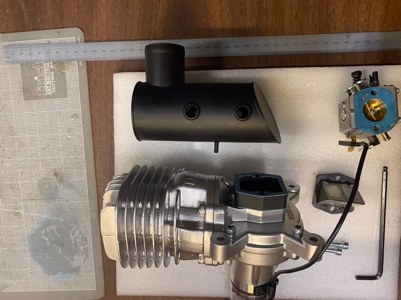

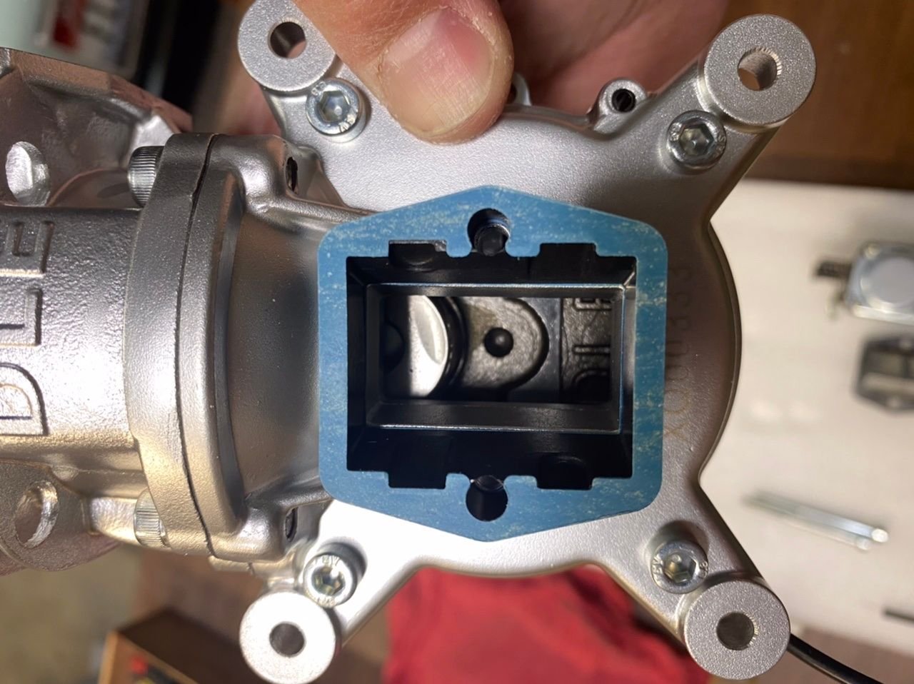

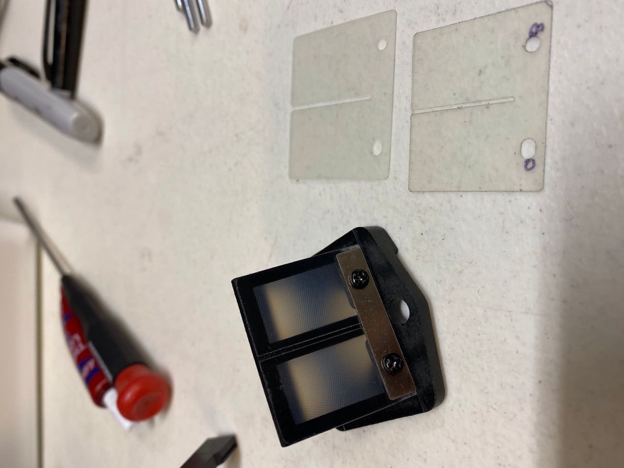

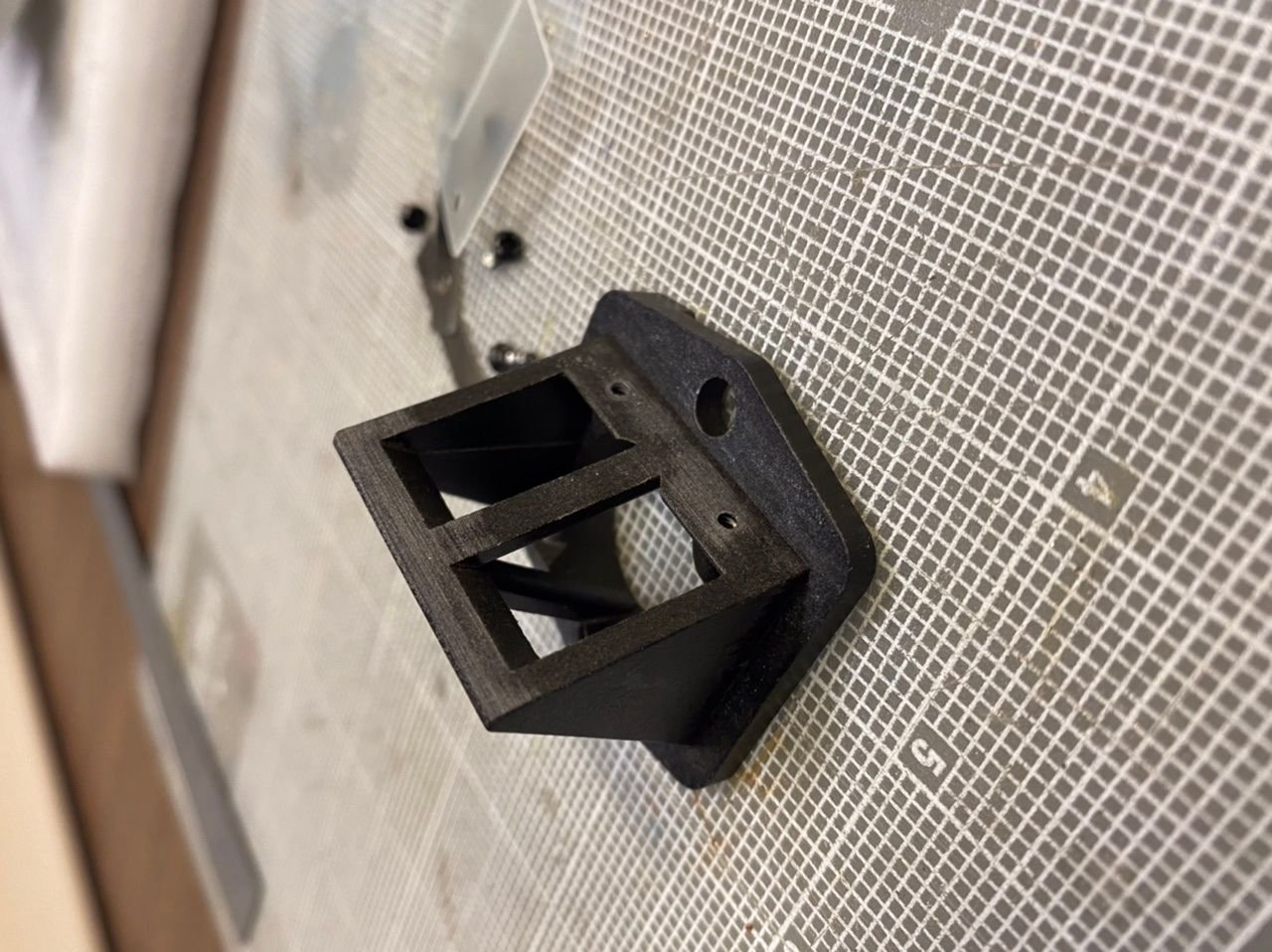

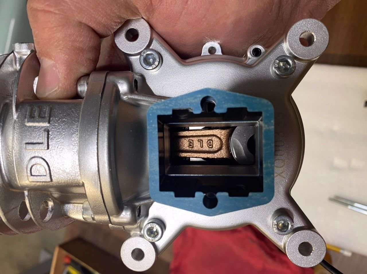

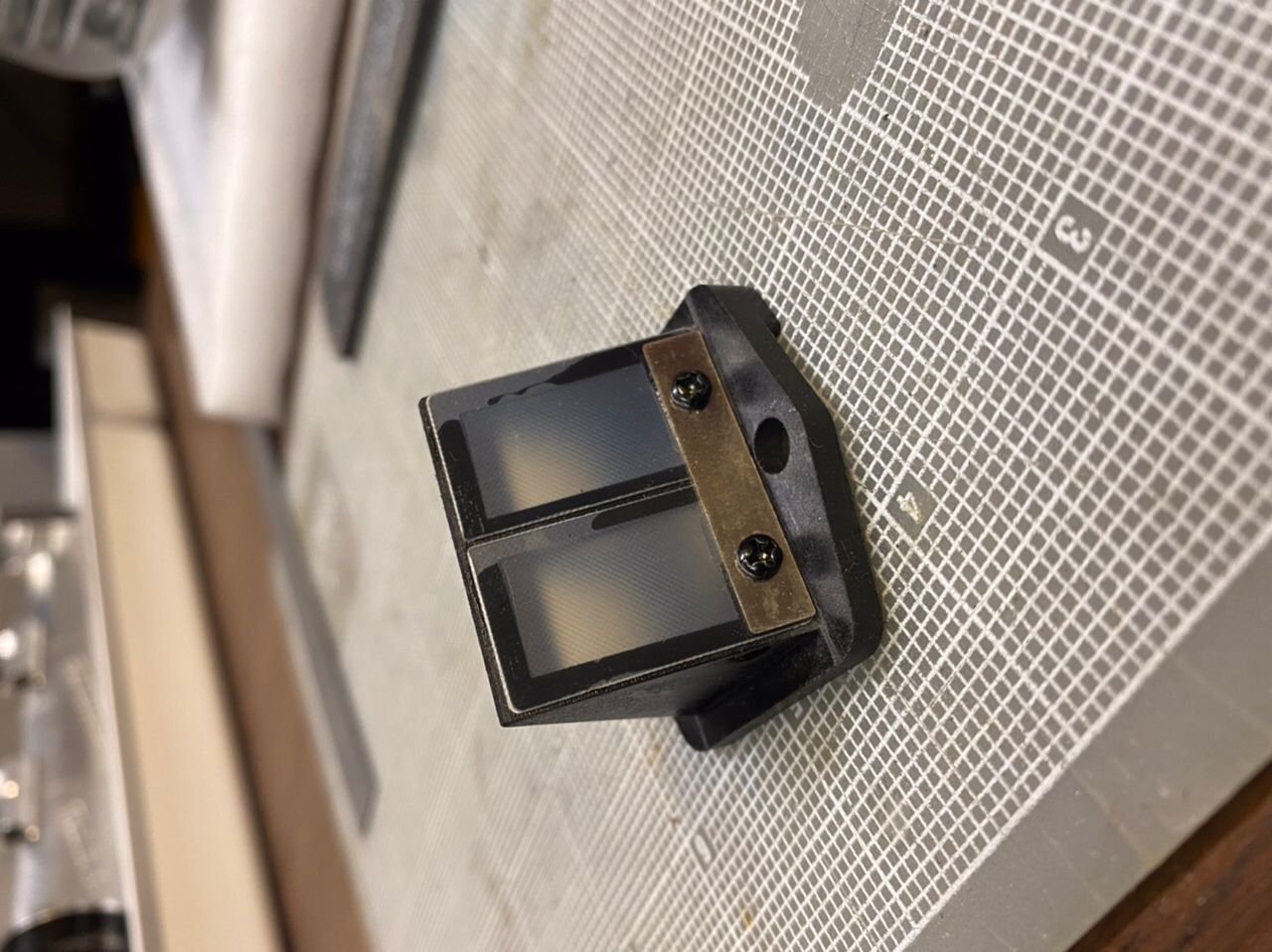

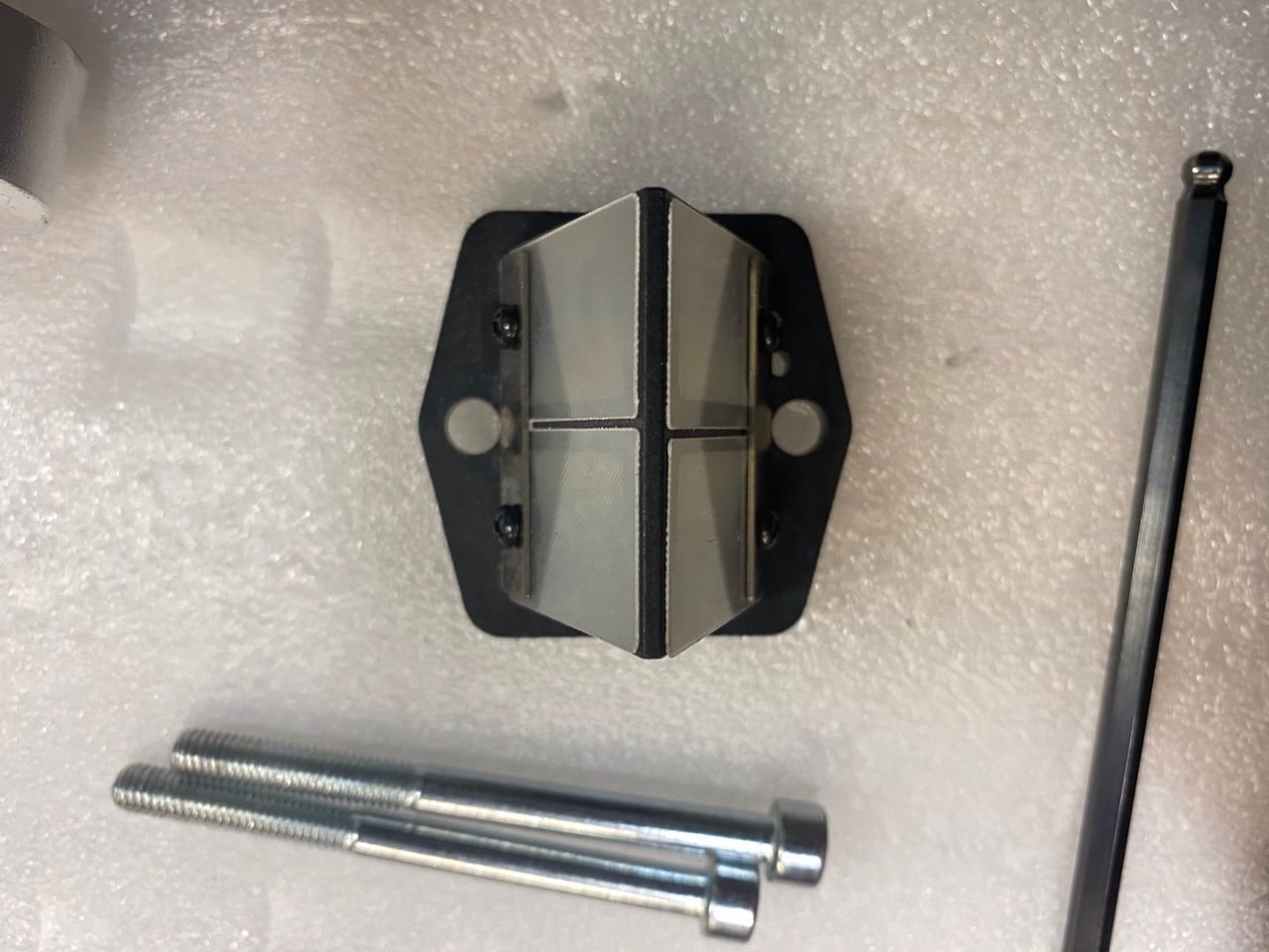

I have the engine now and pulled the reed block off to see whatís going on. The typical DLE reed blocks in all the engines Iíve handled have reeds that are not sealing to the block. The 65 is no exception. The reeds are not aligned and they have a gap to the block. The first thing I do is sand the plastic block faces flat with a sanding block and get them even. The molded parts warp in the molding process so the middle is typically lower than the edges. The fiberglass reeds cannot conform to the blocks wavy surface so you get a leak in the low spots. By basically blue printing the block you get a better seal and that results in easier starts and better response from the engine.
Unfortunately the reed on one side is warped so you can see with just a few drops of oil that one side is sealed and other has leaks. Now Iíll have to figure out if I can get the twisted reeds to flatten out or maybe just leave it as is. It will be better than stock at least.

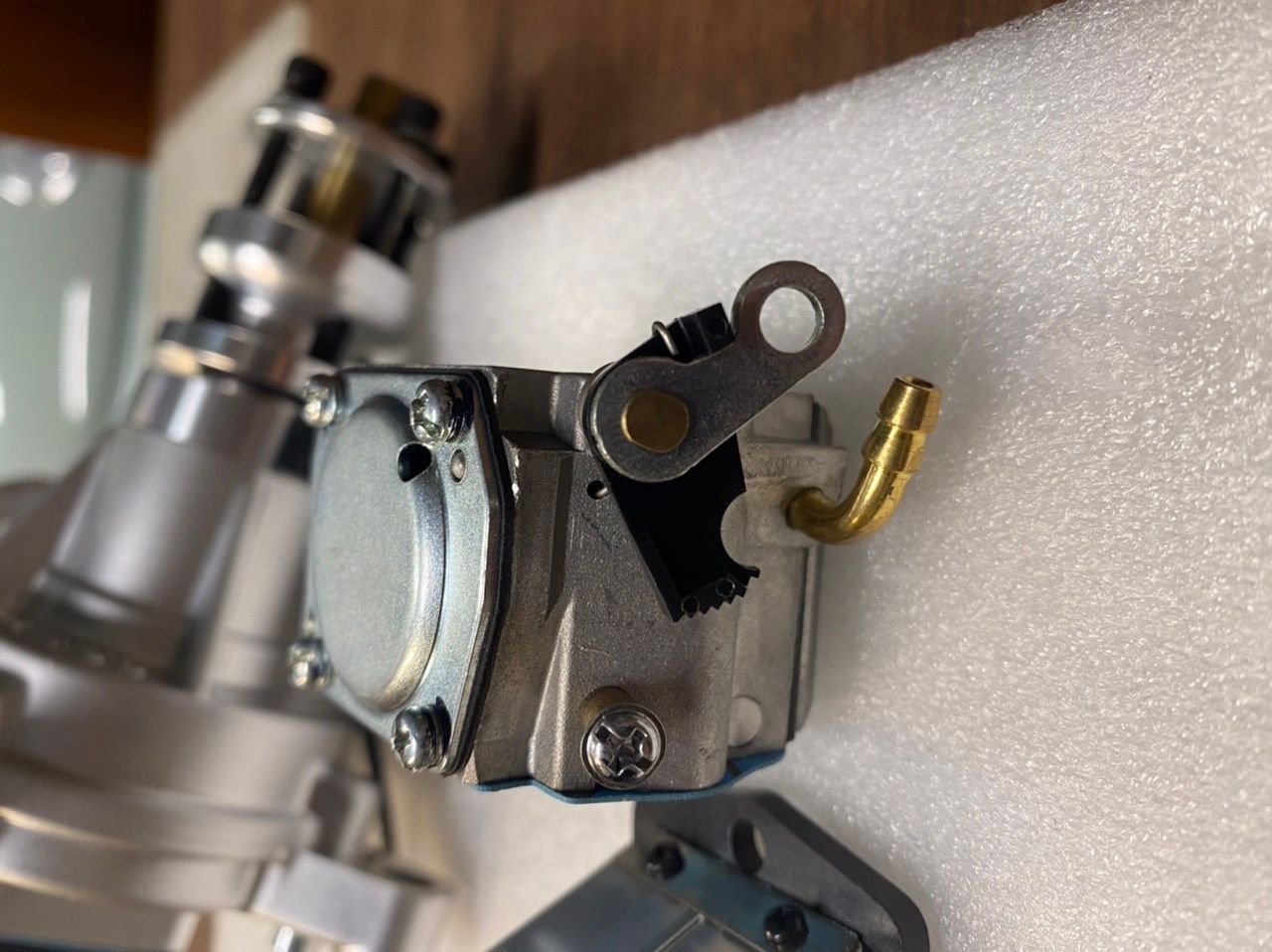

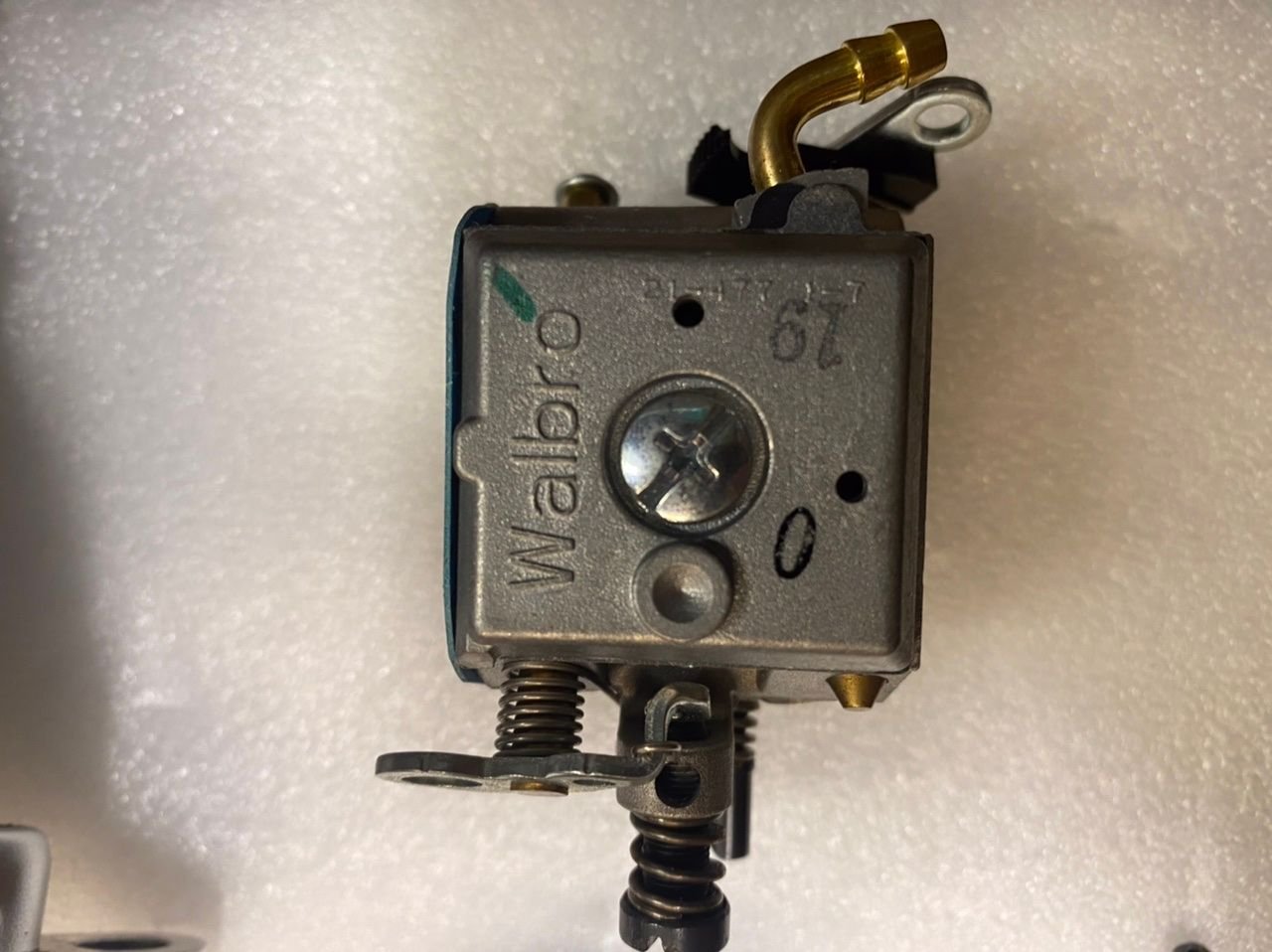

Some features this engine has you would like to know aboutÖ
The piston has a coating probably molybdenum, unconfirmed, but this helps reduce friction and increase performance.
The Walbro carb is great to see but they left a strange lever/arm on the choke side. They do supply an aluminum lever for the butterfly but not for the choke. The problem is how to attach a typical RC linkage here so my solution is to order another aluminum lever set and remove the existing parts. I like to use a servo on the choke so that will be pretty straight forward.

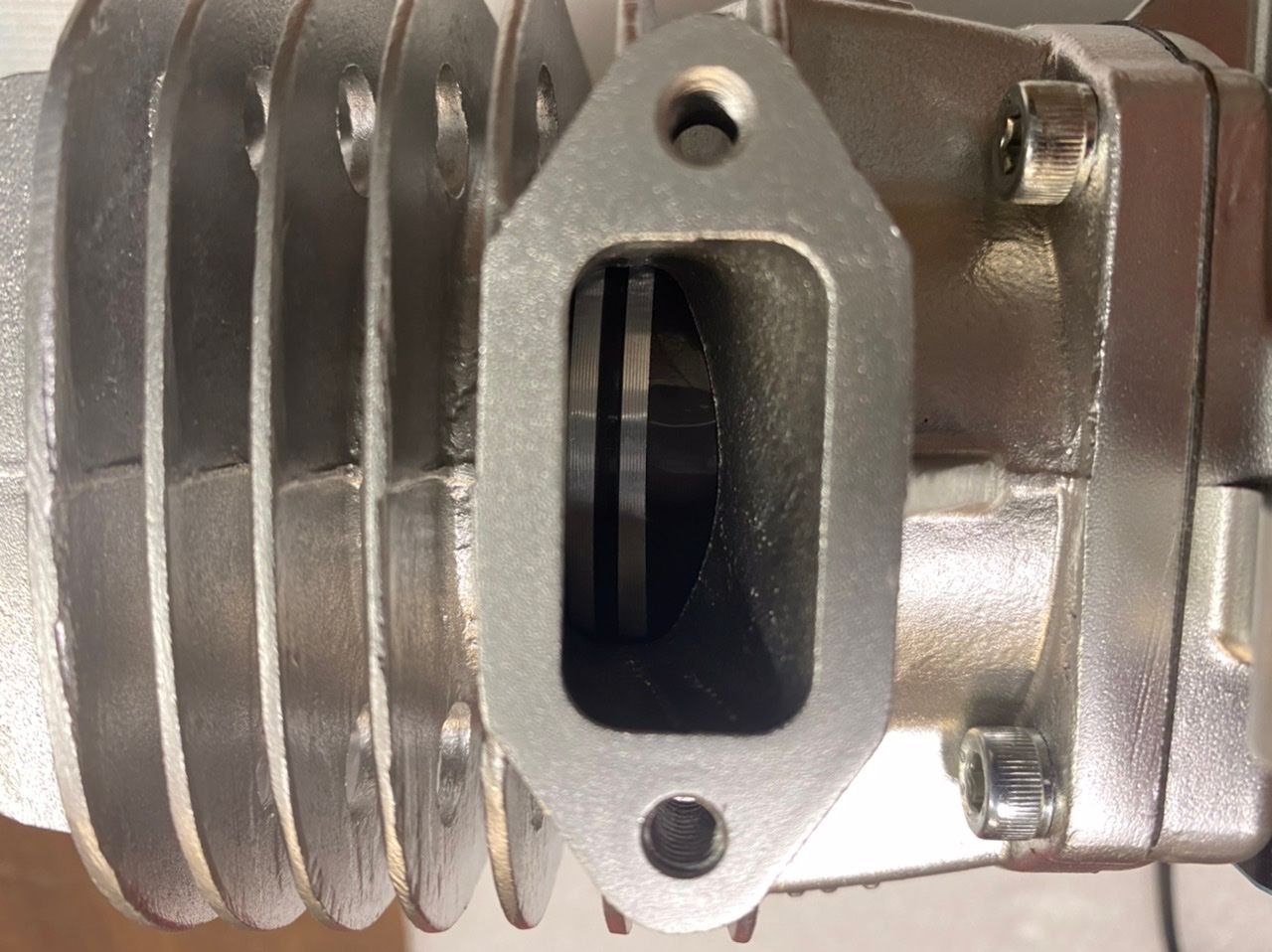

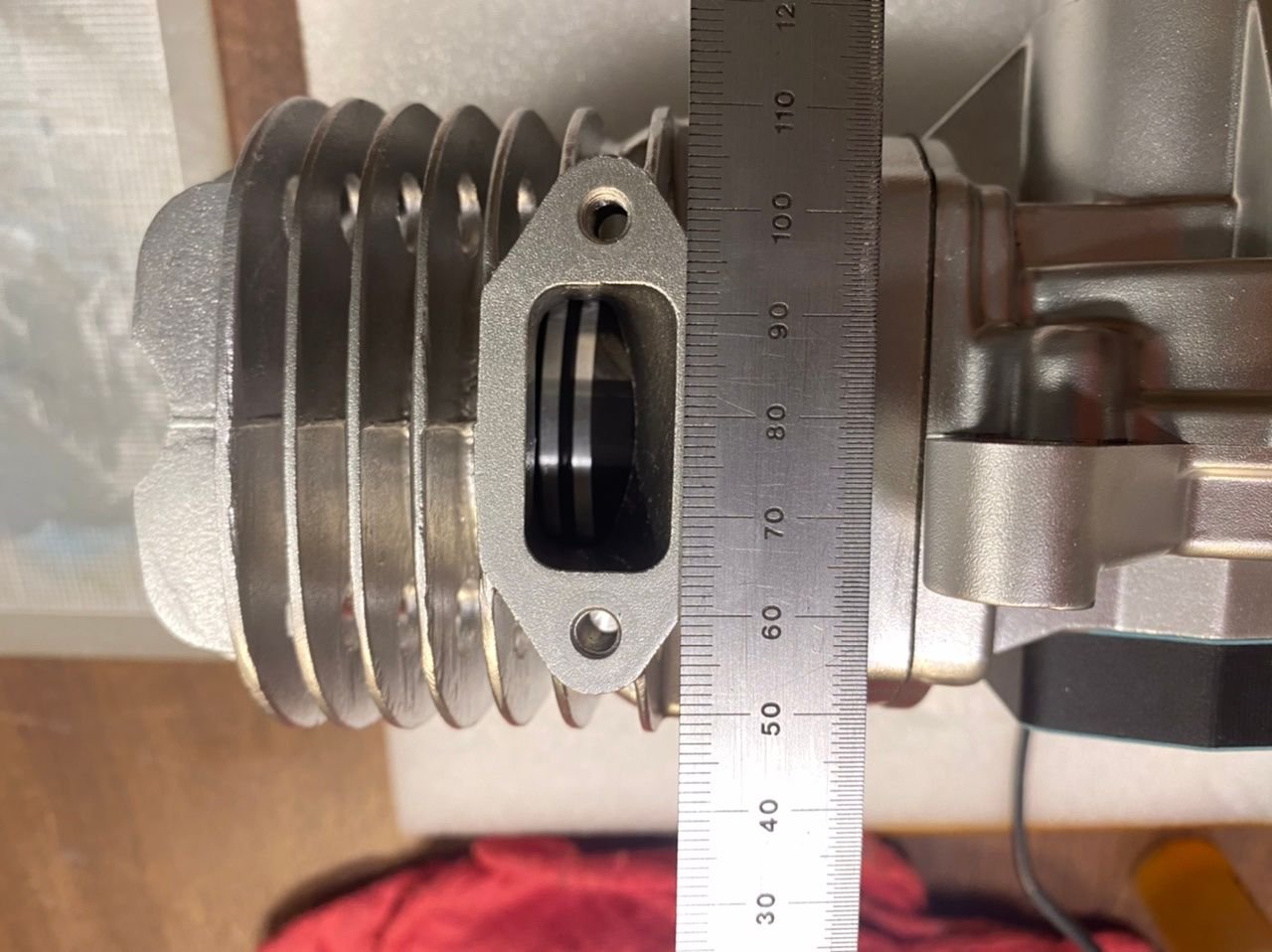

Something I noticed and didn’t like but can be typical of production engines is seen in the exhaust port. There is a clear edge of flashing next to the piston. What I think I’ll do is take a stone on my Dremel and carefully grind that flash off. I’ll have to take the jug off the engine to do it so it can be cleaned and reinstalled later.
The intake also has some flashing but I’ll leave that because it won’t make that much difference and you want turbulence to promote mixture in the intake track.

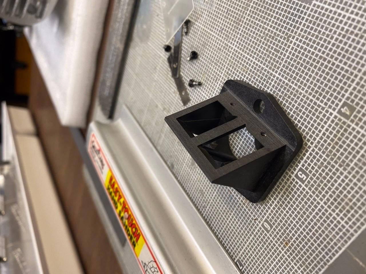

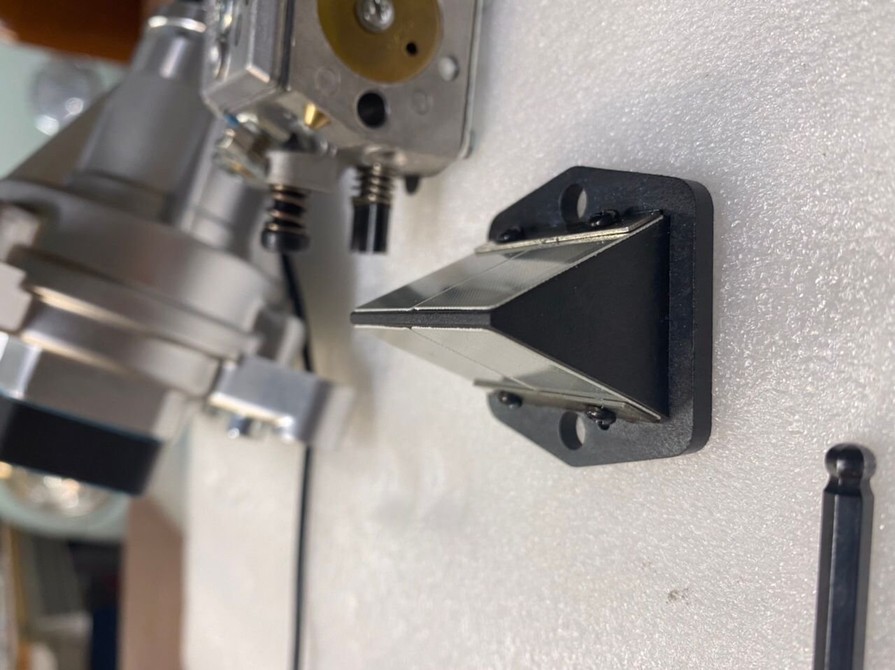

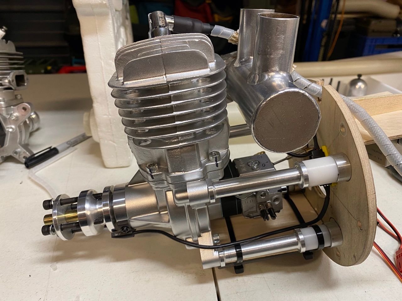

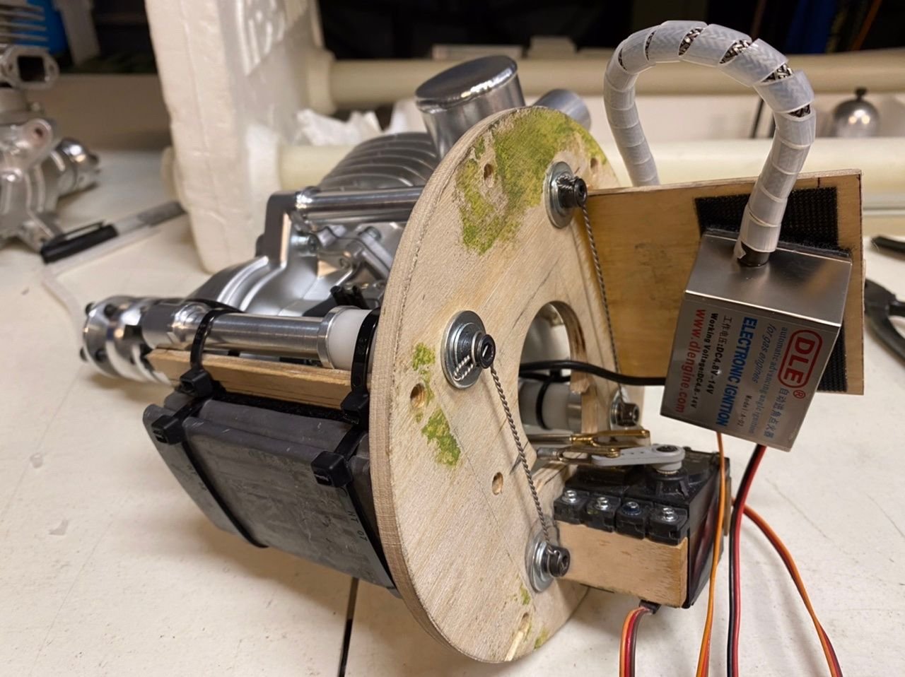

The 65 is back together and mounted now. Here are some pics of the work I did. I ground the exhaust port flashing and then with a tapered carbide bit I profiled the side port dividers. They have a blunt face so I gave them tapered profile to smooth out the flow. With a diamond file I smoothed out the castings edges and faces that looked a bit rough ahead of the transfer ports. Also notice the exhaust port flange with the black stripes before and after. The face is not flat so I filed and sanded the face to even it out. The pitts wrap around pipe I had on the 61 fit with no issues.
My engine mount is different from everyone elseís because of the previous radial engine installation so I kept it. Itís basically all self contained and bolts on to the front bulkhead firewall. I fixed the warped reed by replacing it with a new one. It was a larger reed so I cut and sanded it to fit and itís nice and flat so now you can see the seal.
Next step is to cycle the battery pack and install the power unit back in the plane.

Got the engine running today for 10min. Very impressed with the very first start. All I did was prime the carb and then turned on the ignition. Then just a couple flips and it popped so I opened the choke and flipped it two more times and it started right up. After that it just settled in and idled with no problem and I didn’t adjust the needles at all. I used an NGK CM6 plug I had on hand and cleaned it up with a wire brush. I bought a couple more and noticed the price on these plugs went up!
The engine can idle at 1350-1400rpm solid and responded to a short blip with no hesitation. I ran it at about 2500rpm for a few minutes and then shut it down.
Xoar 23x10 prop
Klotz full synthetic at DLE’s recommended ratio 30:1
Non-E 91 octane gas

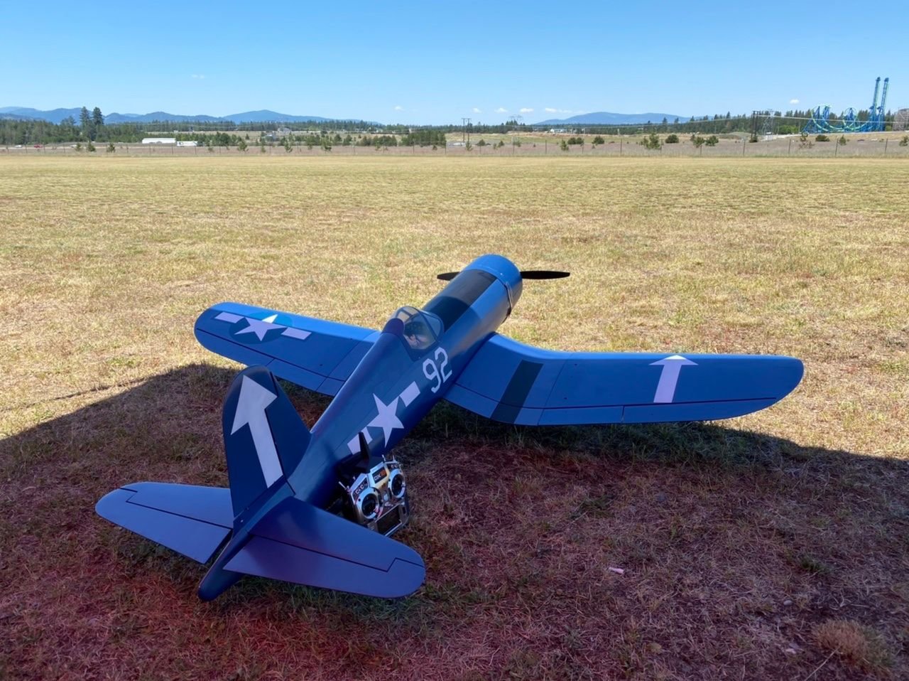

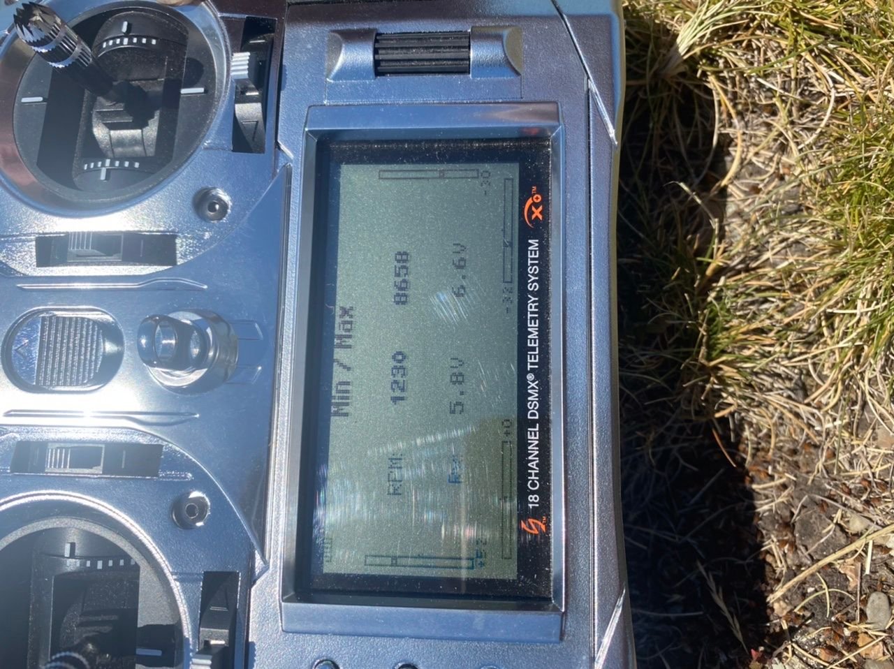

Flew the Corsair today and the engine is working great! The reeds have a lot of suction so I accidentally flooded the cylinder the first time, never done that before! Cleared that out and it started right up. It revved out pretty high so Iím going to tame it down with more pitch. The temps are under control at about 185F in the cowl then temped at idle on the head. The idle is capable of going down to the low 1200ís and responds right up to 6300rpm immediately. In flight it unloaded to 8658rpm
Iím really happy with it so far and canít wait to see how it breaks in and performs with more pitch.
