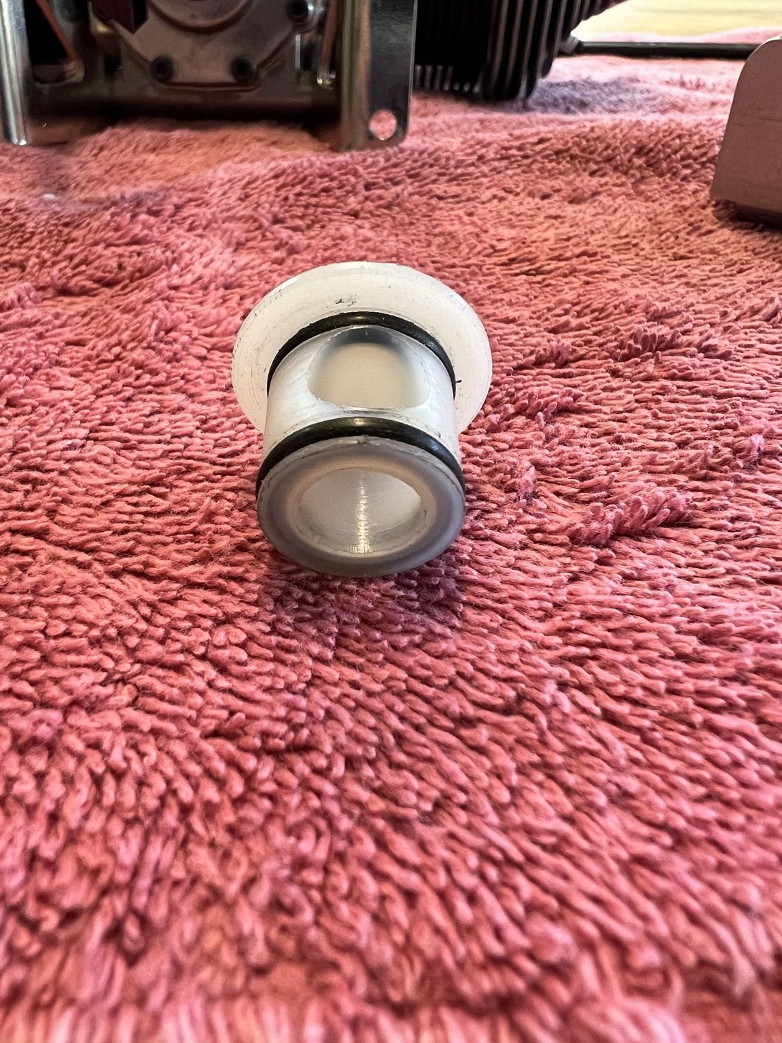

I wanted to check in here to let all you guys that have been following along know that I'm waving the checkered flag on this project.
In a nutshell: I did not like the way the engine was running with my "inlet charge diverter" drum. I gave it a good try then decided to center it once and for all. Along the way something got in the Walbo and caused it to misbehave. SO: I centered the diverter drum, disassembled/cleaned the carb and put a new gasket set in it and test ran it one final time. It starts and runs great.
I did do one final modification to the diverter drum. In this picture the outlet of the drum (which leads to the intake pipes) is on top. I opened/smoothed the sharp edges of that port and installed it centered. Yes, there are still minor differences between the cylinder mixtures but I'm so happy with the running characteristics and power output that I'm calling it done.
One day not too long from now I will build an aircraft specifically for this engine and at that time I will return to this thread and update. Kind of like I did with the little Gemini 160 project. Until then, see you all later -
The edges at the sides of the hole (on top in this pic) are now opened up smoothly leading to the intake pipes left and right

This to me is more evidence that a simple rotation of the carb 22 degrees may have been a solution.
Did this drum setup loose you any rpm?

No loss of rpm. I'm getting 6750 with a Xoar 20x8. Not a powerhouse but quite adequate. To me the loss of power compared to when they are nitro-powered is well worth it. I just can't stand the internal corrosion and unreliability of glow plugs on these engines.
