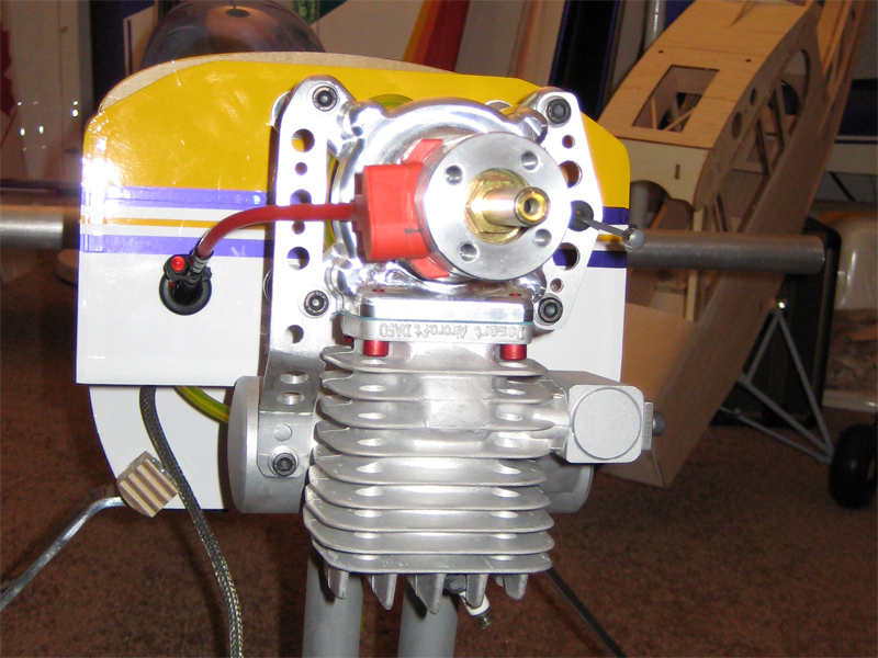

I have the slimline and it has been great. Only part I don't like is the support bracket. I tossed mine in the trash and made a new one.
You can also see the choke plate I added to the other side of the motor. The choke rod lines up with the air intake of my cowl. Just reach in and grab the rod to choke the motor, simple.

Nice work there sundevil, really clean
