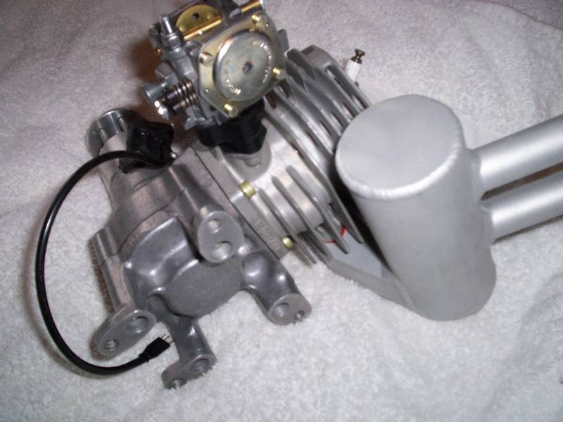

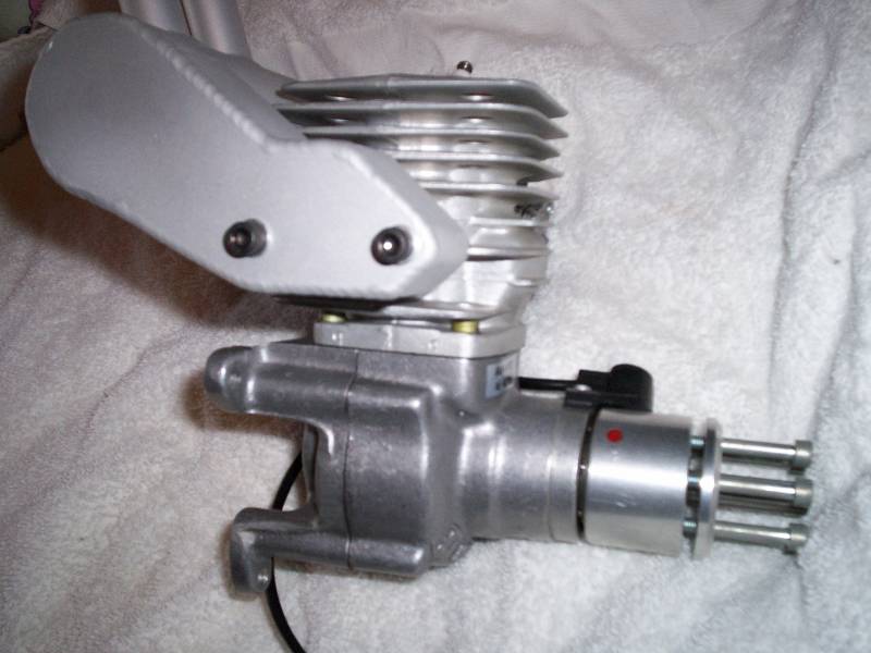

I have a 3W-60K, it is actually 57cc and has no reeds. It is the 3W equal to the zenoah G-62 with OEM electronic ignition.
Does your engine look like this?

I will know what it looks like in a week, I do not have it yet, it's in shipping.
Are there different versions of the 3W 60?

Yes there are two 3W-60's. The one I have shown is long out of production. The later version is a rear carb with reed block configuration. It is more powerful and heavier, also larger in size than the "K" model.
