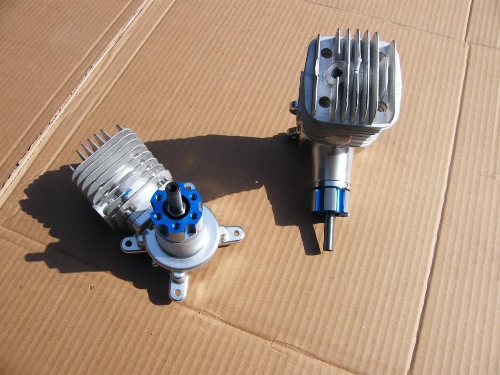

I have a prototype CRRC pro GP50R coming.
I should have it in a week or so.
CRRC Pro is sending it to me to do testing and list my findings.
I have had CRRC Pro engines 26cc and 50cc and have had great success with them.
Low weight, great performance and reliablity.

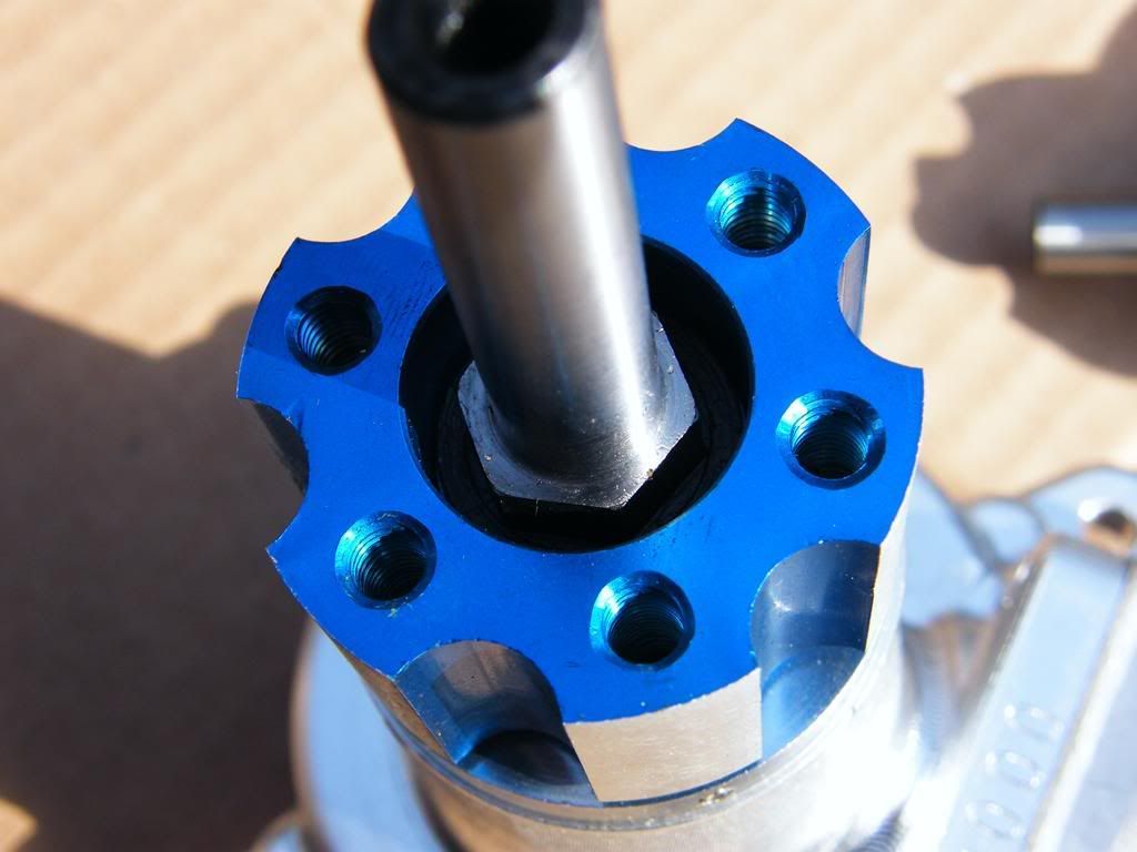

This new GP50R will have a CNC machined case, dual bearings on the crank, single ringed piston, rear inducted carb, etc. ( DA/DL mufflers will fit this engine )
Factory numbers on the 1st run of prototype #1 were and idle of 1450 rpm and a top of 6850 rpm with a JFX 22 X 8. ( that was the 1st tank ). Now factory number claims are 7400 rpm with the JFX 22 X 8.
The props will need to be drilled with a unique 6 bolt pattern that will only fit this engine.
Maybe this will change and go to a hub that will mix match with other engines such as the DA/DL's.
I will need to gather up some 20"-23" props of different brands to use as test props for rpm #'s since when they get drilled they will only fit this engine. Anyone with any props willing to donate for test all will be welcome.
After some bench test, it will go into a 50cc extra for flight performance.
When it comes, I will take my own pictures, weights, and opinions and let you guys see what I will have.
This engine is designed to run against DA and DL-50's.
I know that my CRRC Pro GF26I is a power house and I only can keep my fingers crossed for this new 50cc engine.
Here are a few pictures that were sent to me.

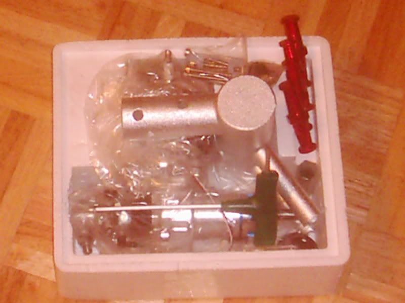

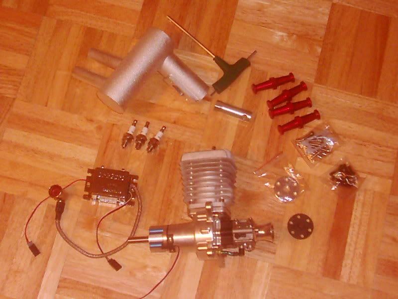

OK, enigine came today.
All looks very very good.
My engine included:
Engine, pitts muffler, ignition, stand-offs, sparkplug, wrenches, prop jig, all nessesary bolt, washer & gaskets.

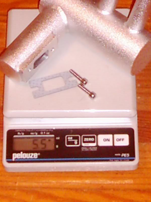

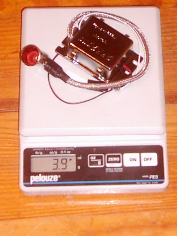

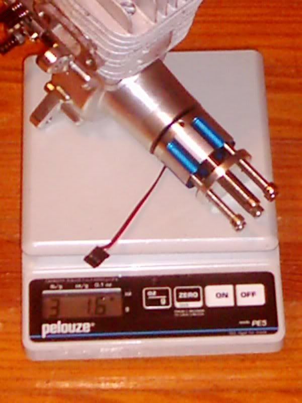

Weights are as follows:
Base engine with prop bolts and prop washer............. 3 lbs 1.6 oz.
Pitts muffler, muffler bolts and gasket......................... 5.5 oz.
Ignition CDI unit .................................................. ..... 3.9 oz.
That is 3 lbs 11 oz or 3.68 lbs or 58.88 oz.
My DL-50 with the stock ( light ) muffler came in at a total of:
3 lbs 7 1/2 oz or 3.46 lbs or 55.4 oz.
So the CRRC GP50R is 3 1/2 oz heavier then my DL-50 , but has a heavier pitts muffler.
Both with the DL-50 muffler, the CRRC is only 1 1/2 oz. heavier.

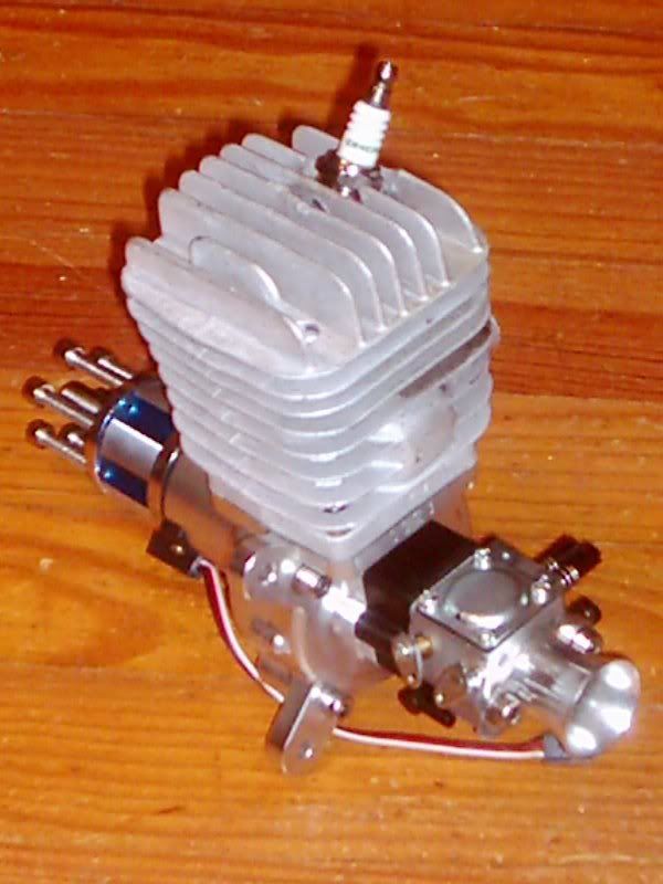

CNC work on the engine case is very clean and on the money.
Head casting fins are a little wavey, but not a big deal to say the least.
Sparkplug threads are clean and sloop free.
Prop main shaft is drilled for a spinner and is 10mm in dia.
Engine mounting tabs are ( CNC milled case ) 8.5mm thick.

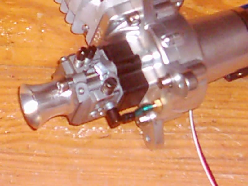

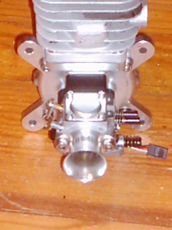

Carb is a Walbro ( there are two numbers ) WT ( 841 ) ( 907 ) and carb is fitted with a venturi.
Ignition is the CRRC Pro auto advance CDI unit that runs on 4.8V batteries.
This engine was factory started and run, but needs to have break-in done to it.

I just laid prop jig to prop jig and this 50cc is the same prop bolt pattern as the DA/DL-100's.

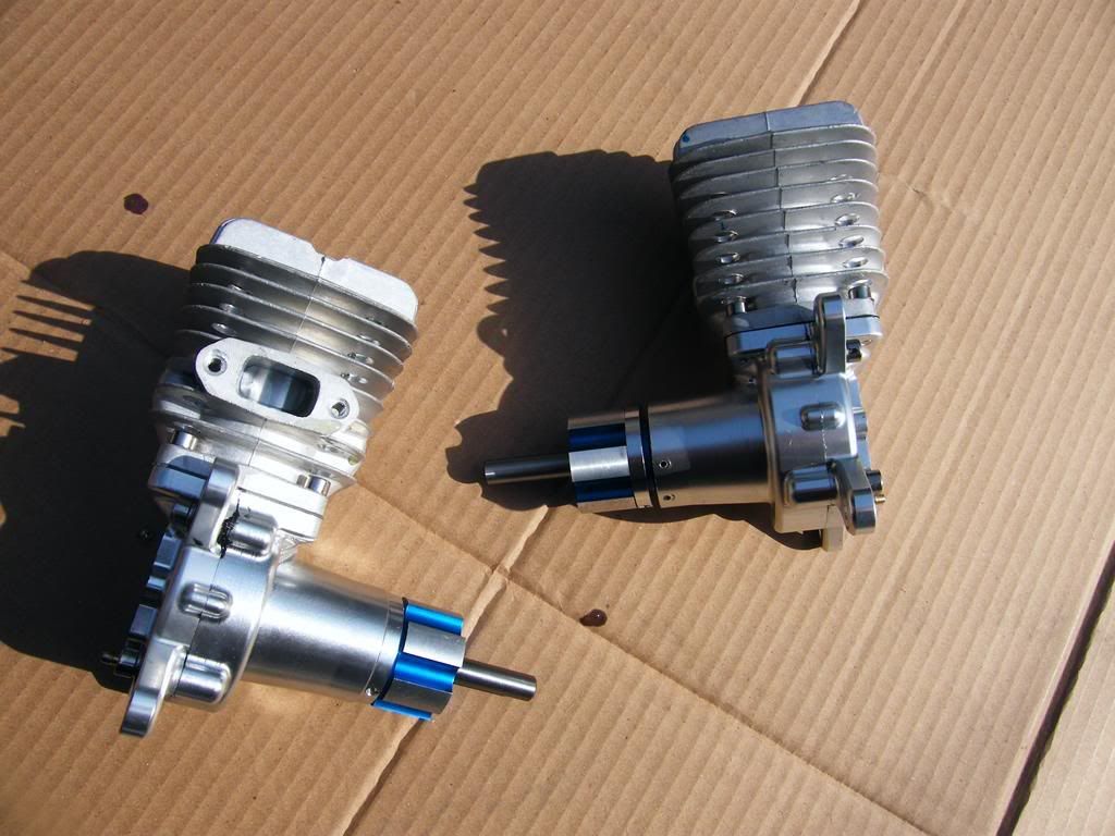

I am currently flying the ccrc 50 with a 22x8 prop. Premium gas/ 40:1 Belray racing 2 stroke oil and it will turn 6800 rpm. On a 17.5# plane it is almost vertical at lift off. When the tail lifts I can pull straight up and over to the invert at about 10 ft altitude. A few birthing issues on the ignition (mine ran 10 min then failed replaced with new one and all is well).
I am curious though about the rear induction. Don' t know if it is easy to choke etc in the rear. I found I had to put thumb over intake prop until fuel reached the carb for the first start. Then 9 flips, ignition on until pops. Then 7 more flips choke open until it starts. This works everytime.
I have run a 20x10 prop but the engine was turning 7800 rpm and this seemed a bit high so I went to the 22x8.
I am also curious about the prop attachment. The 50 side carb uses 1 bolt which seems to work well. I machined a prop adaptor nut for the prop threads on engine side and 8x32 on the bolt side for the spinner. I am not sure about spinner attachment or prop strength with all the holes. I also back the prop washer with double sided 400 grit sandpaper to prevent prop slippage. Keep us updated. vettdvr

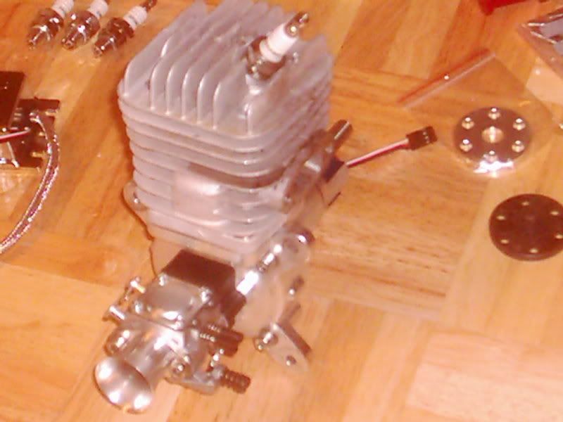

Today , i've received mine.
GREAT LOOK,
i'm impressed, and having knowledge about the development of this engine some months ago, i can't wait to break-in and test.

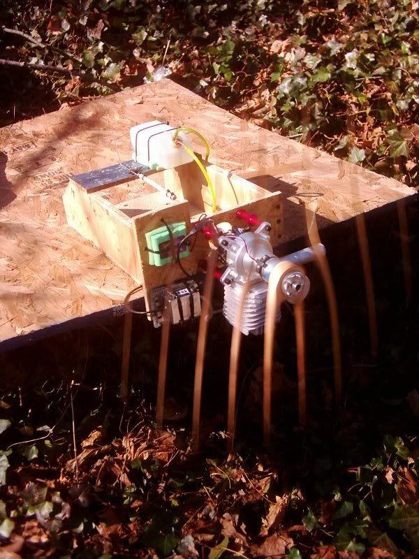

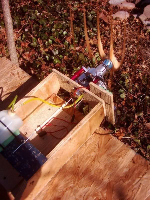

O.K., did some running today.
I ran a light loading Xoar 20 X 8 ( That's all I had ).
I used one of my DL-100 mufflers to make a equal comparison to have the same style muffler as the DA-50 and DL-50.
Ran 32 oz. through it @ 40:1 Pennzoil Aircooled.
Only took it to 3500 rpm because of the small prop.
I just wanted to get some time in on it.
Then, the mail lady came with some props.
I put on a JFX 23 X 8 for some numbers.
I leaned the low needle in a little.
Turned the JFX 23 X 8 @ 6930 rpm with a idle of 1900 rpm and that's with only the 32 oz. run through it.
I have a JFX 22 X 10, and some more ( JFX & Xoars ) coming for more testing.
That's all for today, 21 degrees and 15 mph winds.................I'm staying inside.

JXF / Xoar 23x8 prop at 6900+ RPM!? you sure your tach is working as it should? cos thats a very very respectable performance

Yep, Had the tach for a few years.
I use it on all my engines and have even done back to back, to back, to back comparisons with three other tach at the flying feild.
I am very, very impressed with the rpm's and the 23 X 8.
I had a hard time believeing it myself, especially as it only had 32 oz of fuel run through it.
I had the CRRC factory tell me that they were at 7400 rpm with a JFX 22 X 8.
Maybe those numbers are possible, I have the JFX 22 X 8 coming soon and I will run it posting some numbers.
Those numbers are better then what my DL-50 ever turned that prop.
I actually have a brand new Mejzlik 22 X 8, but it is already drilled for a DA/DL 50.
To drill that prop out to this 6 bolt pattern, I would not feel safe with so many holes so close together.
I no longer have the dl-50, so if any company/anyone is willing to trade a new undrilled Mejzlik for a new drilled Mejzlik let me know.
I would love to see what numbers come from a Mejzlik.

I did some more engine running today.
Man what a differance today from yesterday.
Yesterday was 21 degrees and 15 mph winds, today is 58 degrees and still 15 mph winds.
I decided to drill the Mejzlik prop and run it.
I ran three props ( Mejzlik 22 X 8, JFX 22 X 10, JFX 23 X 8 ) and I took video of all three prop runs.
Yesterday I ran two 16 oz tank through the engine ( 32 oz. total ). Today I got new fuel, filled the 16 oz tank and ran all three props.
So, this engine after running the three props still has no more then 40 oz of fuel through it.
I did absolutely no needle turning in between props, needles stayed the same, just props were changed.
Needle tuning may get a little more rpm's with each prop, but the most rpm's will come from more run time/break-in.
I have more props ( Xoars ) coming , but here are the three videos of todays runs.
Mejzlik 22 X 8 ........ around 7400 rpm
JFX 22 X 10............. around 6700 rpm
JFX 23 X 8................around 6840 rpm
http://www.youtube.com/watch?v=78XIdVxNffE
http://www.youtube.com/watch?v=c-VW498xGAg
http://www.youtube.com/watch?v=8BAQmb0Kvr4
