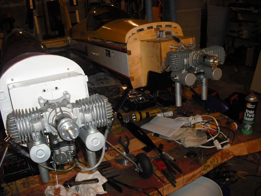

Hey guys, I know this is a topic over and over, BUT.
I am running a DL-100 without any issues.
Turning a Mejzlik 27 X 10TH @ 6500 rpm.
I am at about 4 gallons in this engine and I want to take a look at the plugs.
I think the centers of the plugs look a tad on the rich side ( tan/brownish ).
I was concerned about the black wet looking build up on the outside edge of the plug.
I am running Pennzoil aircooled @ 40:1 and these are NGK CM-6 plugs.
The tuning might be good, but maybe to much oil?

Looks a little rich and too much oil... 40:1 is a bit much as evidence by the large amounts of black deposits. In short order you'll see some problems with the rings sealing. You are uing a good quality oil so thin it down to 50:1 and check the plug again after a few runs...<cite>

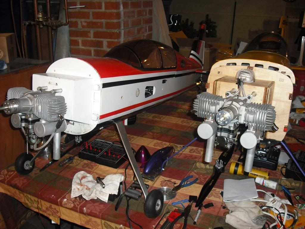

I also just pulled the plugs out of my Yak.
DL-100, Mejzlik 27 X 10TH ( 6600 rpm ), NGK CM-6, eight gallons through it with Pennszoil aircooled @ 40:1
First two pictures are the right side, second two are the left side.
I am thinking the right side on this set looks a little lean, kind of white.

You can never run too much oil if you tune properly.
I think the first might be on the rich side a tad. 2nd looks fine. However it depends when you shut down the engine. If you had a long taxi back then you are not really getting a true reading. Best thing to do is to kill the engine right after you land. Then you can get a good reading on your high end which is mostly what you are using.

What octane fuel are you using? Judging by the heat line on the ground strap this engine needs more timing! That would help power output as well. The brand of gas you use and it's composition will greatly affect the coloration on the ceramic and electrodes of the plugs.

In the last set of pics I saw what I believe to be an engine running lean. The early set of pics is an engine running wet and rich. A difference between sides is normal, but try to strike a balance between the two. The oil residue on the plug threads can be pretty much ignored.

Engine #1 is close, engine #2 is way off. Since we cant adjust the timing in the ign. module we have to play with octane and oil/fuel ratio. Higher octane fuels burn slower which changes the timing of the flame front/travel in the combustion chamber. I would run it on a leaner oil/fuel mix and look at that white insulator very closely and look for brown spots. That is the clue for slight detonation. You want the color change on the ground strap to be at the bend or slightly below it.

Another trick you can do is bend the ground strap so it is only over the half of the electrode. If you look at eng#2 it looks to be that way while Eng #1 it is covering it. I also noticed that the gold plating is still on the electrode on Eng #1 which means it is way to rich but if the engine is new that is ok for now. Something to watch. Just remember, lean will kill the engine and rich will only lower the power and foul plugs. By kill the engine i mean destroy it so go slow and keep us updated. I tuned my FI street/drag cars by reading the plugs just as i have told you. Every engine and gas/oil mix combo is different so if you tune by reading your plugs you will find what works with YOUR combo. It worked for me, my Impala is still #1 and my Cobalt still #2 in the country after 3 years and i tuned it myself.

I think i messed up the engines.. Need to number the plugs so i can better help you. The stronger engine is leaner and slightly retarded ign and the electrode is unshrouded nicely The wet plugs on the 1st eng? shows weak ign, to much oil, or junk gas even? Overall to cool in the combustion chamber. Believe or not though, retarded timing can cause excessive heat as well but i'm sure that is not the case here. As for changing the timing, that would involve moving the pick-up if not correct. To bad there isnt an adjustable pot in the module.
