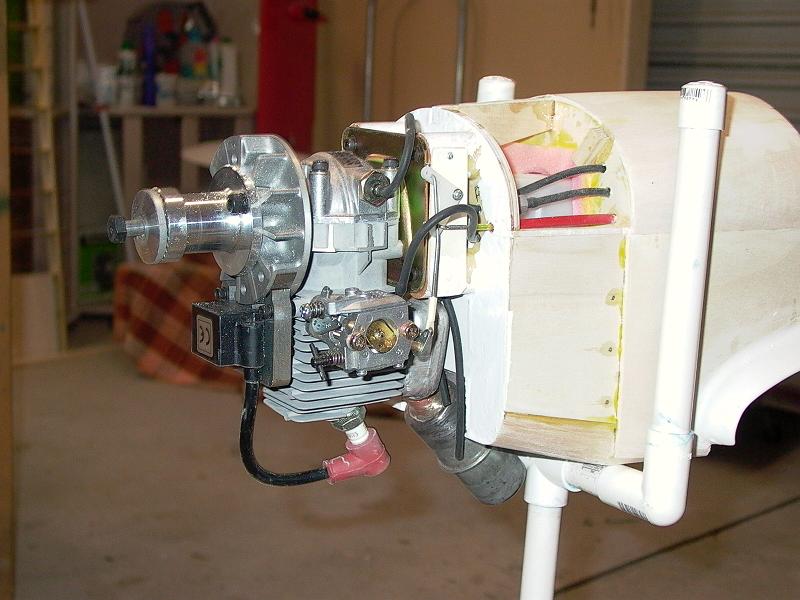

Hello all,
I started my new G-38 with a Bennett built exhaust. Holly cow it is ridiculously loud. Any suggestions on making it quieter. Not sure I can stand it the way it is now and the Bennett is the only thing that will fit the area I have behind the engine. I have heard that you can put lawn mower mufflers on to the pipes does this work?
Thanks in advance
Scott

Yes, I think it does. the Snuffler muffler was actually a regular muffler front with a lawn mower muffler held to the front with a long screw. I have seen where some have used silicone tube from the Bennet muffler stacks to the lawnmower muffler and then more silicone tube(S) on out if necessary. The mufflers are cheap, try it and let us know. Good luck.

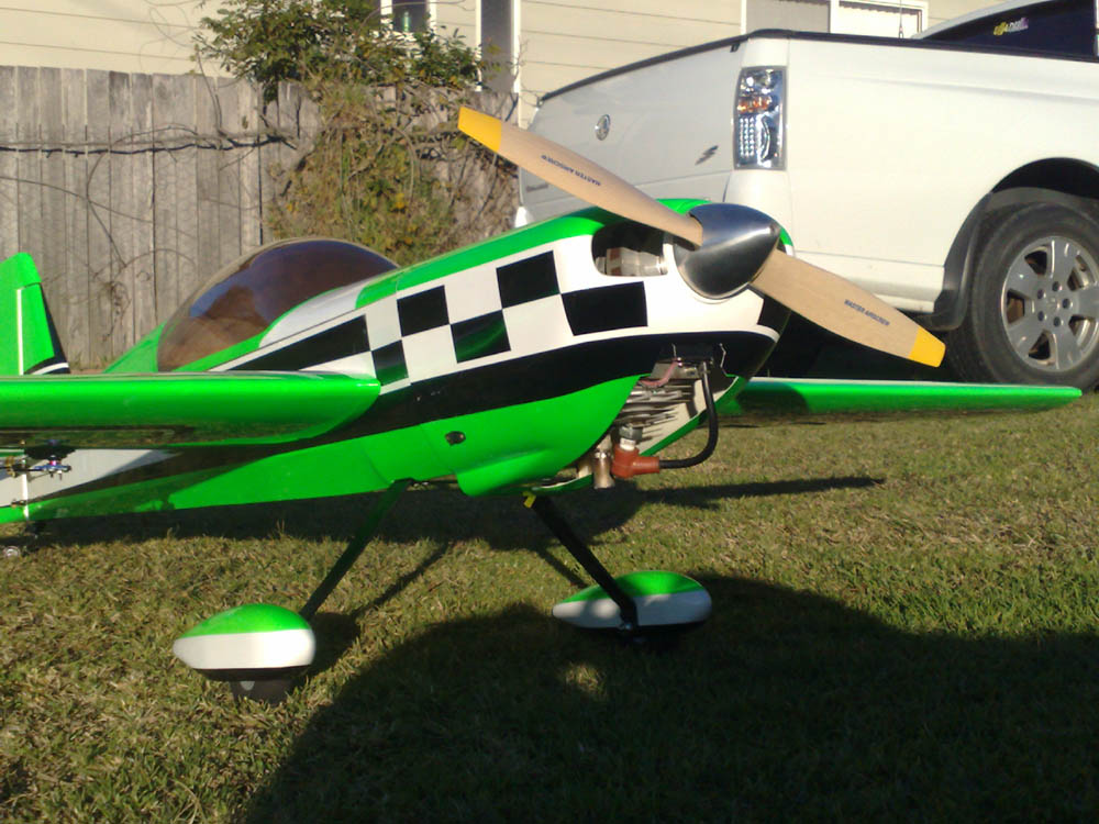

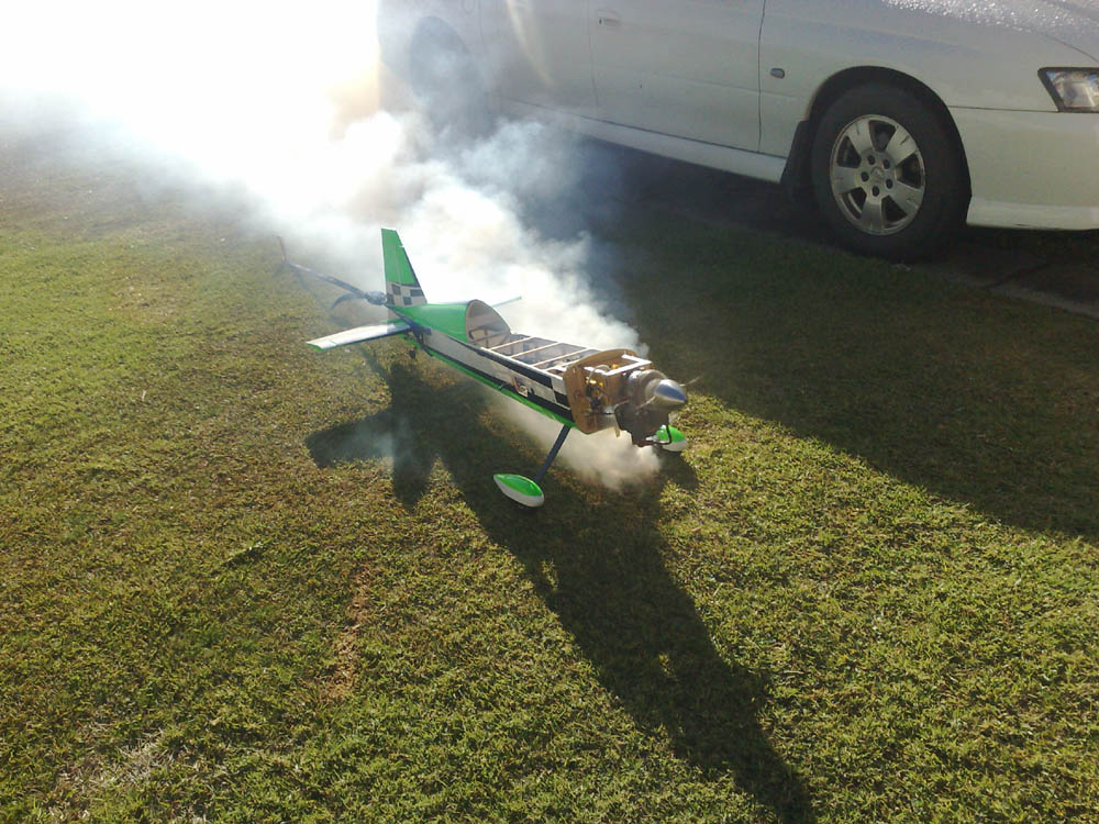

I used the OEM muffler that came with the G38 that was given to me. Just welded a tube to the muffler at the outlet. I lso added smoke fitting to the muffler. Very quite and works well.
Cheers

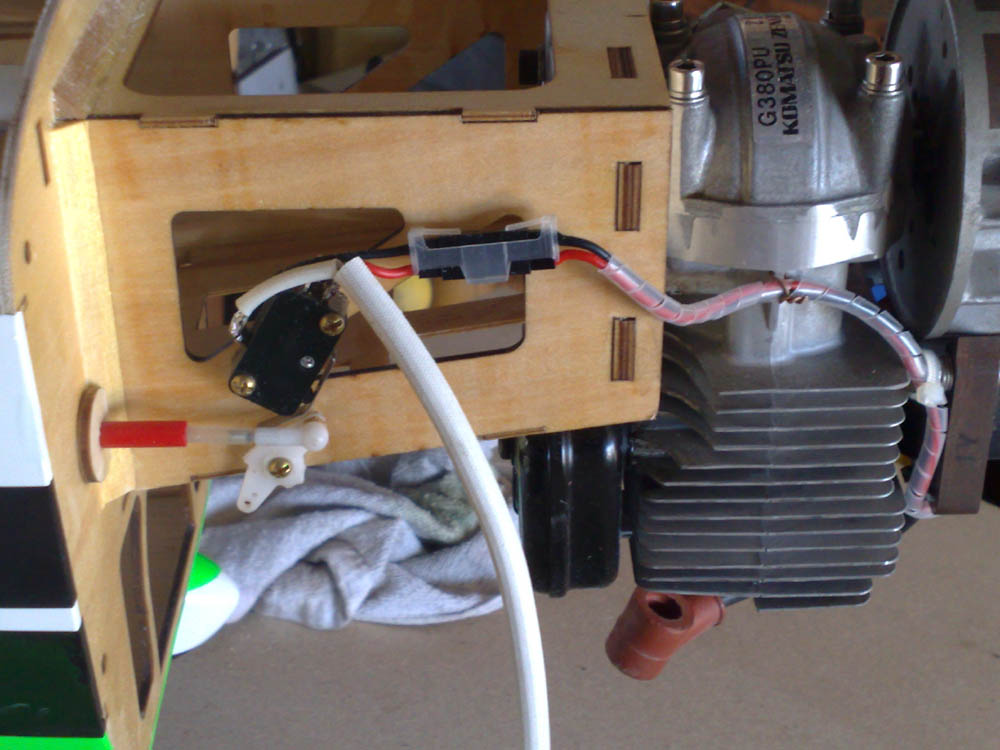

Scott,
I believe the additional perforated pipes will restrict the exhaust without calming the noise down.
Could you add a regular muffler connected by Teflon or flexible steel tube to the pipes of the B&B?
[Edited to replace silicone with Teflon or flexible steel tube (silicone doesn't stand gas exhaust)]
