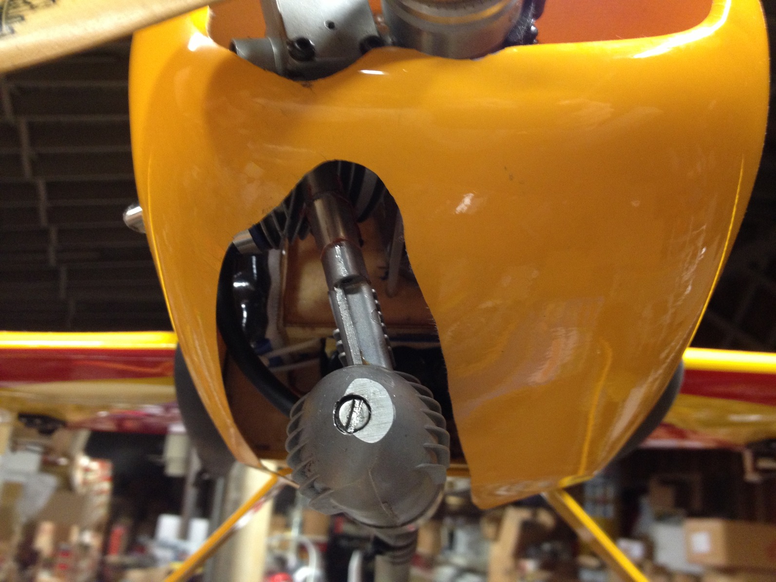

Here is what the 10GX looks like on a Katana with a muffler/header extension and the stock muffler.
The muffler is about 1/4" below the fuse.

I cut out the cowl tonight to the muffler in the standard position and it wont make any cut difference with the extension. Only thing would be the looks of the muffler sticking down lower. The bad thing is I would have to have a 30mm extension to clear the fuse bottom. If I would cut the center piece I would need to cut out 15 mm which would be close to half of its length.

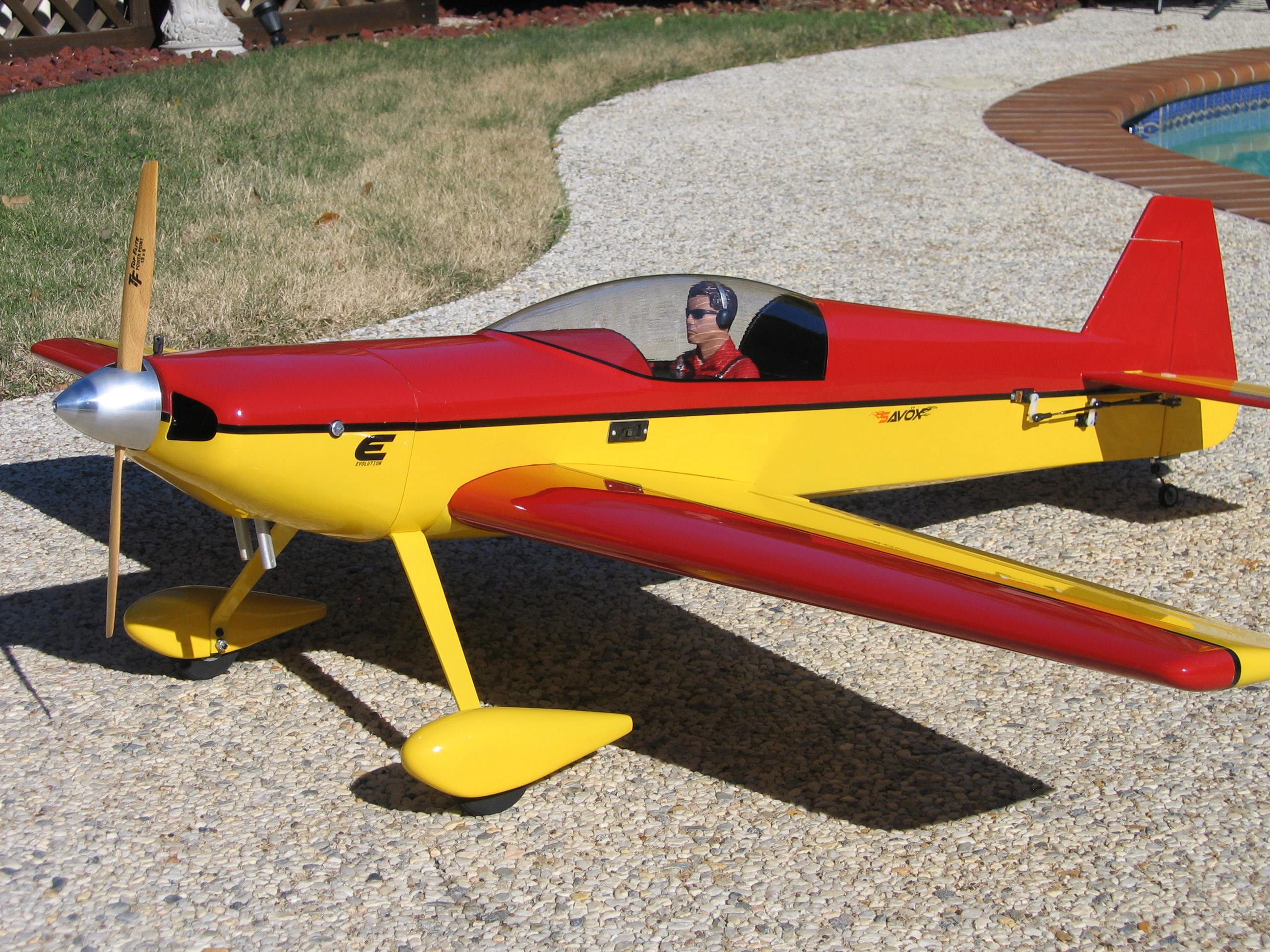

Santa's brown sleigh dropped a .45 size Phoenix Extra 300 at my front door today. Thinking of side mounting an Evo 10 w/Pitts muffler, using "park" size servos, and a single LiFe battery setup to keep it light. Anyone done anything similar?
Russmall 12-24-2014 07:15 PM
1 Attachment(s)
Yes I used a pitts muffler and Savox SH-0255 micro servos in this DR-109 that I built from plans. These little servos are only about 1/2 oz. each and have metal gears and produce about 50 oz, of torque. Plane turned out very light and flew well. I used an 1100 mah Life pack to power everything.http://www.rcuniverse.com/forum/atta...mentid=2057650
