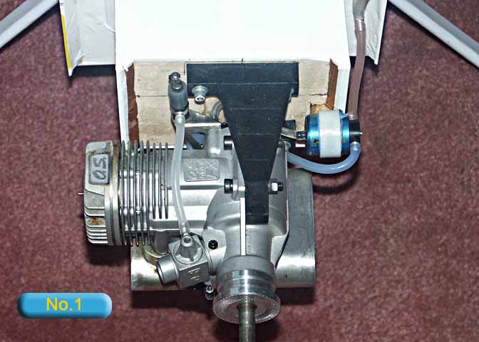

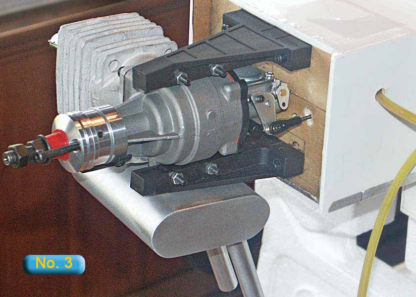

My preference is for those very strong, black, glass-filled nylon engine mounts in
the pictures below. When these beam mounts, engine and fire wall are bolted
together they form strong no-flex unit. I've used them for many years and have
never seen a failure. Also, they can be drilled, tapped and used without nuts if
you prefer.
Pictures:
(No. 1) Large powerful 1.60 (cu in) 26cc glow engine in a 3D model

(No. 3) 35cc beam mount gas engine in a violent 76 inch 3D model

I have a certain degree of confidence in a good FRP set of them as well. I did run across a set of aluminum ones though, that might be worth a try if you were so inclined? 10 bucks! The guys talking about it say the DLE RA will fit, so this engine should be a breeze? So you can suit yourself?
