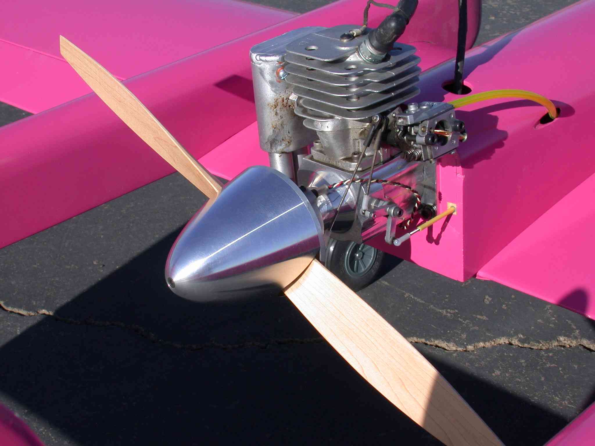

1 Attachment(s)
I don't understand what your problem is but I have used Tru-Turn to solve all of my problems with one of their spinners and adapters. Here is an image of one of their spinners I needed for a pusher application. Dan.http://www.rcuniverse.com/forum/atta...mentid=1965082
