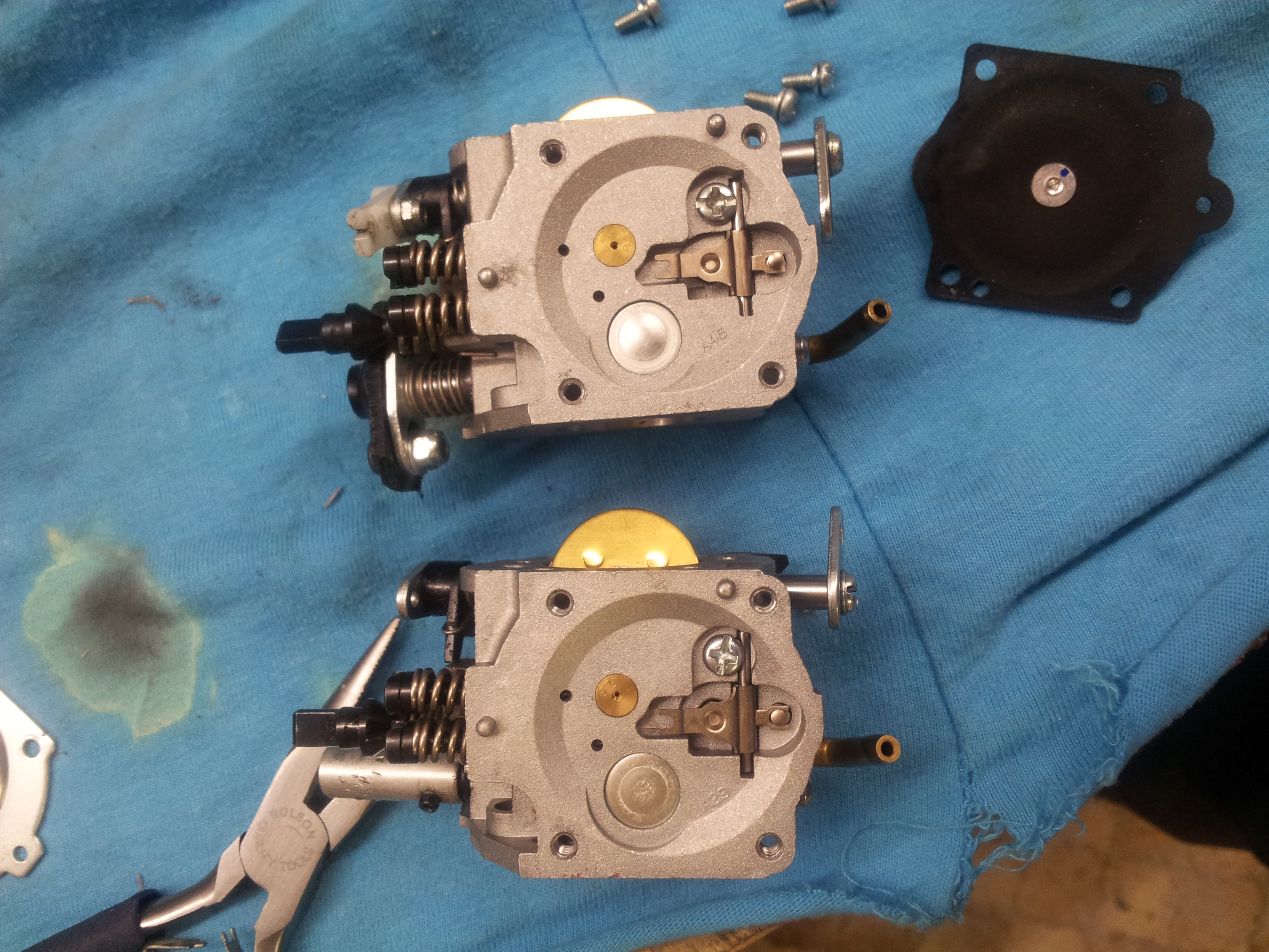

aviator2002 02-19-2015 03:01 AM
2 Attachment(s)
I have removed the carb and checked inside for any sort of damage but found none and being as it is a new carb I didn`t expect to find anything really, the needle seems to be set ok and is not stuck open and no dirt to be seen but I gave it a blow out just to be sure I also removed the backplate from the engine to check the rotary valve for anything untoward but that seems to be ok also. I have attached a couple of photo`s to show both carbs and rotary valve.
My next step is to mount the engine to my test stand and see if I can get it to run on that but will need to wait for the rain to stop before that happens? The carb at the bottom of the photo is the old one.
If my next attempt to get the engine running fails I am at a loss as to what to do next particularly as the engine was fine before all this happened and as both carbs were dripping fuel I thought the fault may actually have been within the engine but examination has not shown anything amiss so any further help in solving my non start engine will be most welcome.:rolleyes:
Johnhttp://www.rcuniverse.com/forum/atta...mentid=2074608http://www.rcuniverse.com/forum/atta...mentid=2074609
aviator2002 02-20-2015 06:29 AM
All sorted now, engine is back in my model and running really strong so apart from a bit of fine tuning when I fly again all is well.
Now a week of high winds and rain forecast so will have to wait for better weather now.:mad:
