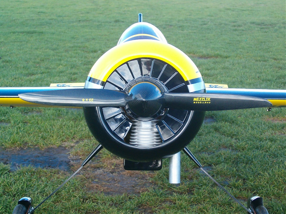

Have a gas engine that runs good on the ground, then goes rich at altitude. It will not clear out. Does not stop but loads up and loses power which makes for some hairy landings, having engine surging at low speeds. I have seen a post where the carb was vented into the fuselage, but can not find it again. The vent was off the 4 bolt/screw plate on the carb. My plane is a Yak55 with cowl. Any help thanks.

Try flying it without the cowl and see what happens. You may need to vent the cowl or put that vent line in to the fuselage.

As All Day Dan suggested, testing with the cowl on and off is an excellent way to know if you have the problem. You need to determine if the problem is caused by airflow directly striking the vent hole which can happen with front or side mounted carbs. Or is the problem caused by excessive pressure in the cowl? Is the problem constant or does it change with changes in airspeed. Many times the problem is actually a cooling airflow problem caused by excess pressure in the cowl. The fix might be as simple as adding additional cooling air exit area or decreasing the cooling airflow inlet area. On round cowl airplanes such as your YAK, I fabricate a baffle that blocks off all of that huge hole in the front of cowl except the small area just in front of the cylinder. I usually add baffles in the cowl to insure the cooling airflow has to pass through the engine cooling fins and not just around them.

Sounds like our on the right track, but in some cases engine surging is not a sign of a rich running engine. Suggest checking your engine temperature, check the color of your spark plug, and make sure your baffling your engine correctly . Your exit air flow from your engine cowl should be at least a third larger than the intake. With a round cowling you should baffle the front of the cowling leaving only a opening in front of the engine cylinders http://www.rcuniverse.com/forum/atta...mentid=2079529.
Venting the carburetor maybe a treatment to the symptom of improper engine ventilation and not a cure to the true problem.
