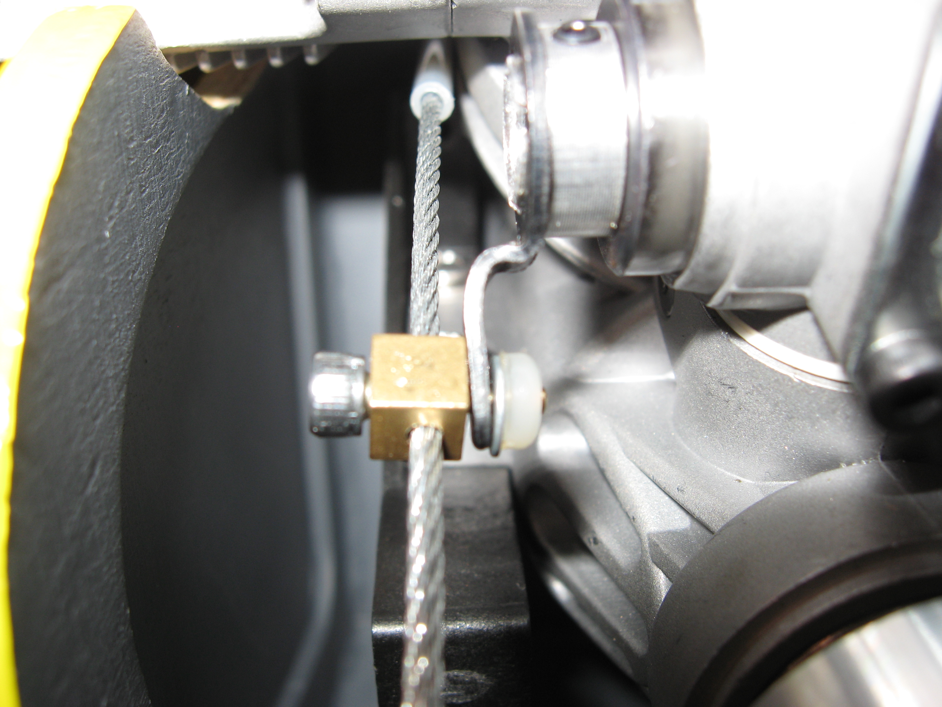

I am nearing the end of my Sig 4 Star 60 build and test fitted the engine and throttle linkage cable from the carb arm on the engine to the servo arm.
The cable is flexible and incased in a plastic sleeve.
The problem is that when I push the throttle up, the flexible cable bows(binds) instead of pushing the cable and opening the throttle. Any ideas to stiffen the cable at the servo end?
The carb barrel on my Evolution 15cc gas engine is also stiff and contributing to the problem. The first 25% of travel to open the barrel is tight and I can't seem to loosen it up enough to stop the flexing (binding) of the throttle cable.
Tried a couple drops of oil and repeatedly working it, but that did not seem to help. Is there a way to get that carb barrel loosened up?
I attached some pics. I would like to make that cable shroud in pic#3 more rigid too because it bends into the bottom of the muffler when the throttle is opened.

First off, flexible metal cable like that is not recommended for gas engines due to the possibility of radio interference. Secondly, when you do use those types of cables, the outer sheath needs to be anchored as close to the servo as possible while still allowing enough throw, and at the firewall. Lastly, I have sometimes had to solder a length of solid pushrod to the flexible cable where it goes from the firewall to the carb to help eliminate unwanted flex. You can use a brass sleeve to facilitate soldering the cable to the pushrod. A couple of times I got away with just cleaning the flex cable with flux and wicking solder into that portion in front of the firewall to stiffen it.
You might want to just go to the regular plastic flexible pushrod. It is stiffer than the metal cable.

The Dubro flex cable is an excellent setup, and with 2.4Ghz I see no reason not to use them with a gas engine. In fact my Sig 4 Star 64 and EVO 15cc is set up exactly that way. What I would do is ditch the EZ connector on the throttle end of the cable and solder a 2-56 brass end on the cable and use a nylon clevis to (comes in the Dubro package) connect to the throttle arm. The clevis and threaded adapter will lessen the amount of cable that can flex. Another tip on using those flex cables is to tin the area with solder where you're going to trim it, before you try to cut it. Also tinning with solder can be used to stiffen an unsupported area of those flex cable. Normal electrical solder flows very nicely with that cable.

Going forward try and correct the geometry of the pushrod/cable with the throttle arm so it's more at a 90 degree angle.
As already mentioned, support the sheath in more spots and extend it beyond the firewall.
Heat up the last 2" of the cable and flow a bit of solder in to stiffen it up.
Also I would ditch that easy-connect on the throttle arm and replace it with a ball link. Those easy-connects can be/are usually nothing but trouble .

jeff4912 04-26-2015 12:16 PM
Don't think I can get a 90 degree connection because of the engine mounts.
The 2-56 ball stud thread diameter on the connector from Dubro that I bought are to large to fit into the throttle arm hole on the engine.
Should I just connect with a clevis instead or drill the throttle arm hole larger?
All Day Dan 04-26-2015 12:24 PM
Use the 1/16 ball link number 190. Dan.
jeff4912 04-26-2015 01:00 PM
Thank you Dan!
jeff4912 05-04-2015 06:00 PM
1 Attachment(s)
I followed many of your guys suggestions and soldered a brass connector to the throttle cable (removed the easy connector) and tinned a portion of the cable also.
I then put the ball connector on and the throttle problem now seems to be solved.
I also braced the cable in a couple of places.
