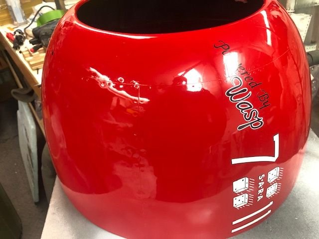

Dennis from Kirby's Kustom Graphics accepted my order today for my R2 graphics set. It's been a while since I have gone through Dennis for my last order with him. Great fellow to deal with and one of the true gentleman of our hobby. Will try to get some pictures going of what is happening next time out.

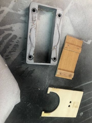

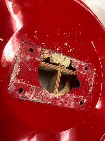

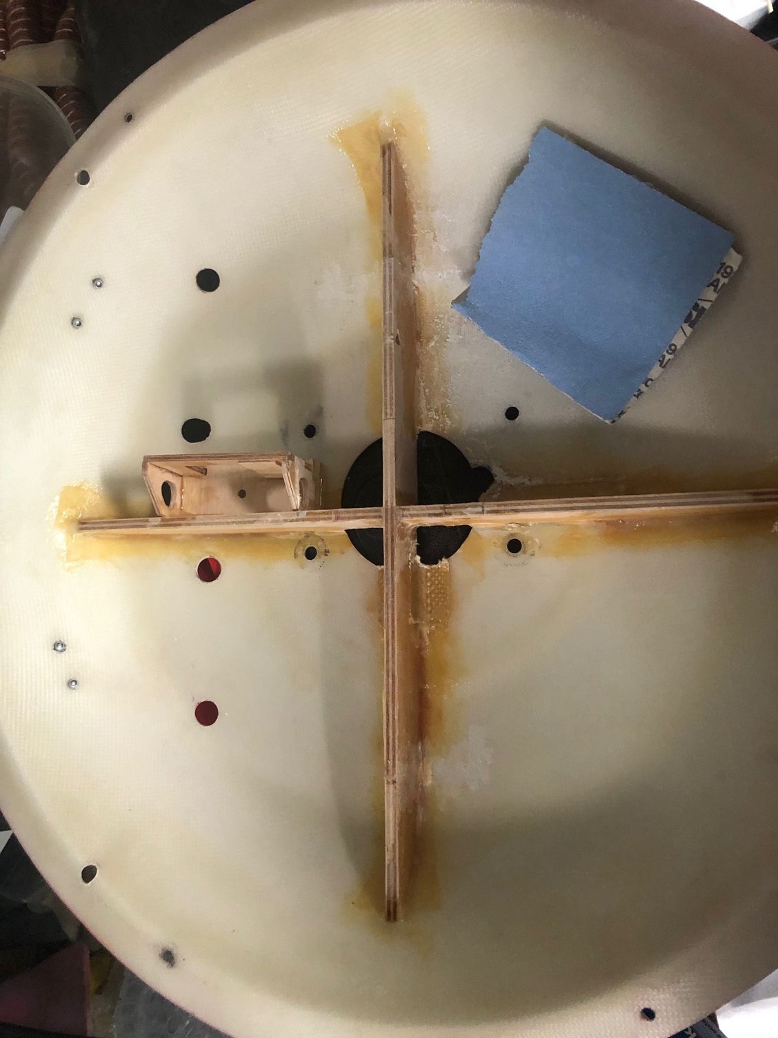

We had some good progress today. Worked on the removing the 3W extension from the dome. Also from the back of the dome removed the deck for the ignition box and probably an ignition battery pack.
Here is the 3W extension mount removed from the dome
So this is the product so far with most of the dome cleaned up. Will decided about painting when the layout is done for the Moki
Here is the back of the dome of the what was installed to accomodate the 3W.
Here is with everything removed except the servo tray, which I am to use where it is positioned now, if not it will be relocated
These are all the parts that were removed from the dome.
to fit the Moki.

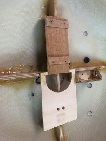

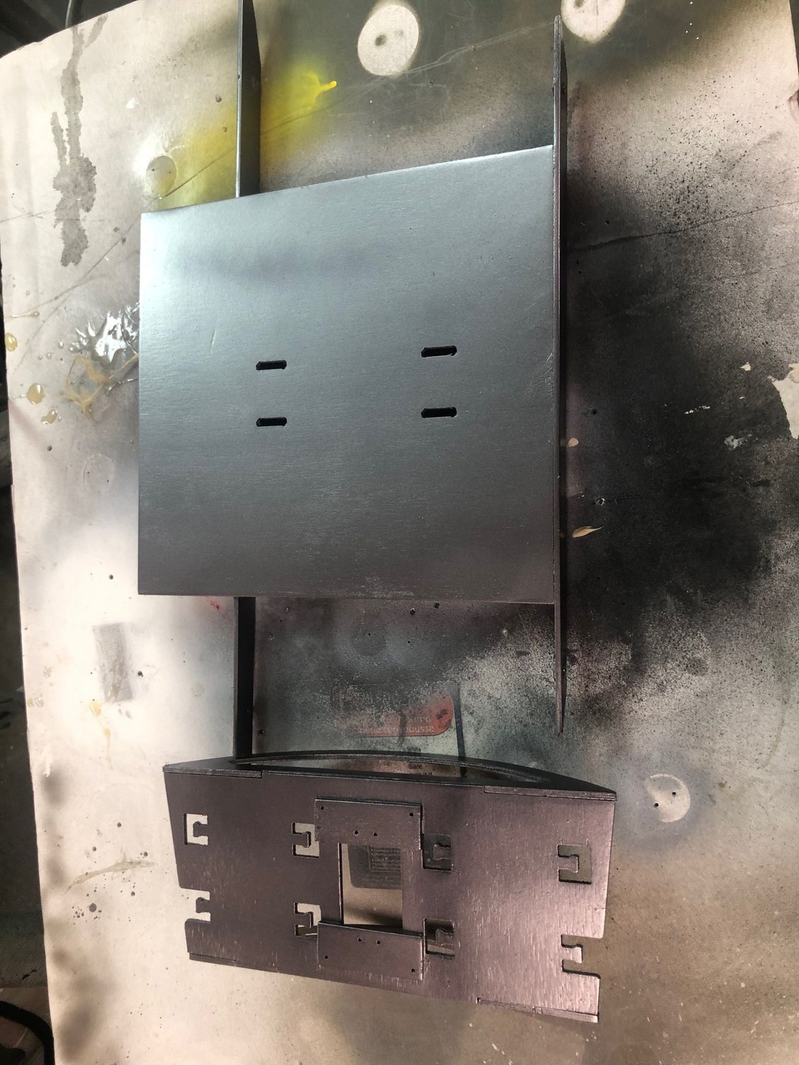

The other part of the morning and early afternoon was spent working on prepping for the rudder servo tray and the forward fuel tank tray.
Overhead shot of the rudder servo tray. It has been tacked together with CA and then full fillets of hysol are run down the inner seam.
Old 04-18-2020, 07:04 PM

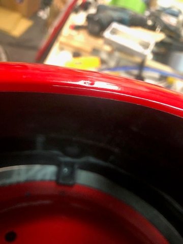

Once the items were all removed from the dome, I pulled out Richard's cowl that he had done a lot of work on, complete with decals. In taking an initial look with cowl over top of the dome, in the pictures I am loading, you will see where it has been painted, and Richard's traditional way having fastening tabs that are accessible from back of the cowl have already been installed. This saving me a lot of work, having to add this feature myself. Hope you will be able to see some of the details as it get's fairly dark inside.
Good looking signature GB cowl.
Hope you can make out the cowl sitting over top of the dome with one of the fasteners of looking in line for where it needs to be.
Here is another one that is a bit fuzzy, but hope you get the general idea. I can take another set if others want to get a better detail.

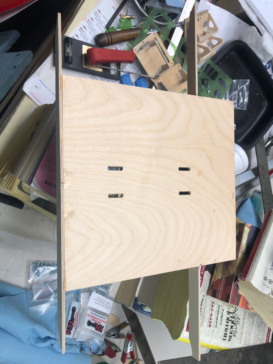

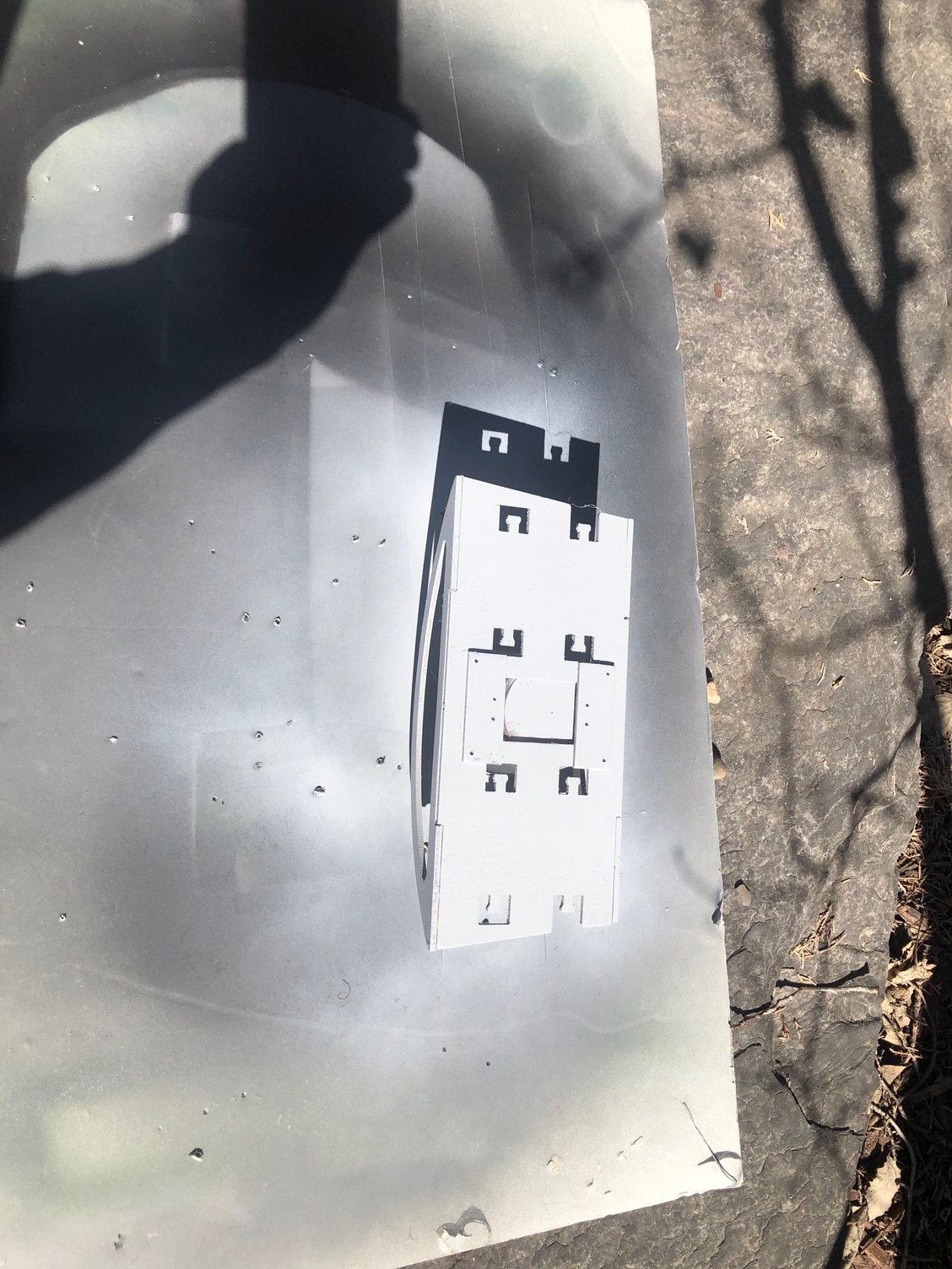

Well we were back at it again today. Worked on the rudder equipment tray and the fuel tray. Both were sanded primed and painted and now ready for what goes on them.
It was great day outside, so it was idea painting conditions for doing this work today.

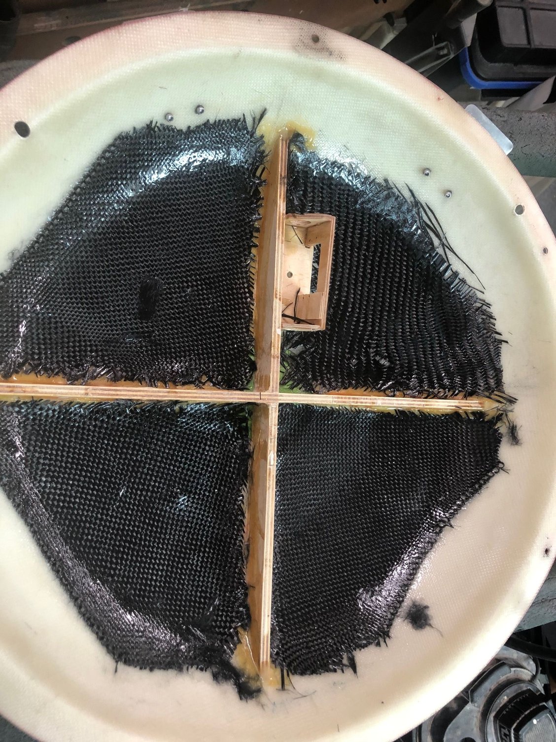

Also did a little reinforcement of the dome that will need some blocks on the inside that will aid in the fasteners not moving around when or pulling through the dome.
So I laid down 4 carbon fibre triangles and laminated with 20 minute epoxy and thinned with isopropyl.
So this is what she looks like unfinished.
Rudder tray with primer.
Both trays with the finish coat on.
Sanding inside dome.
Carbon fibre applied and waiting to be cured by tomorrow.
Thats all for now folks.

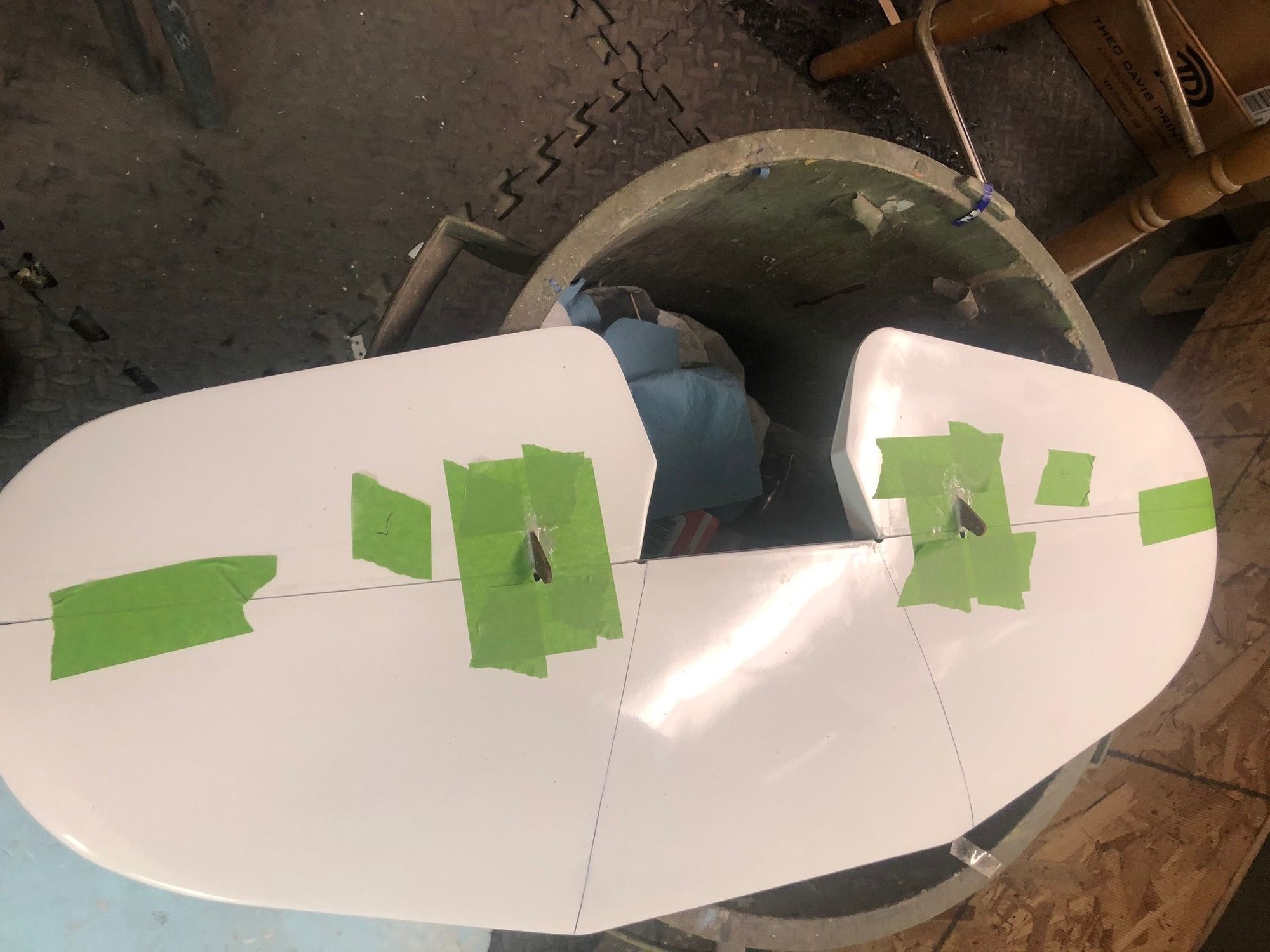

So prepped and glued the elevator horns in place on the stab. The next thing to do was bring the Su 26 home from storage so I can do a transplant of the Moki.

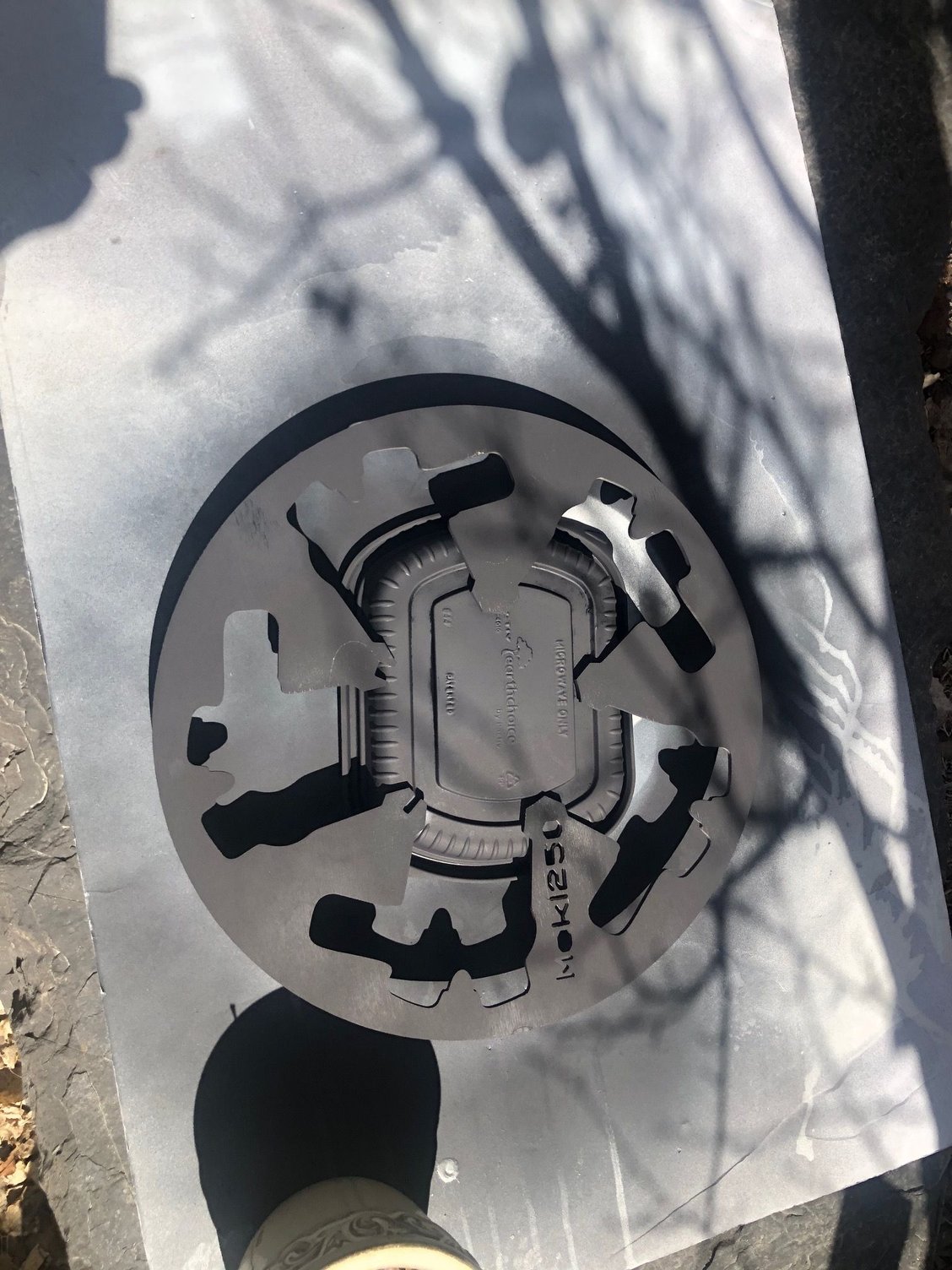

The engine baffle was sanded and was painted with black manifold paint, so that is ready to go now.

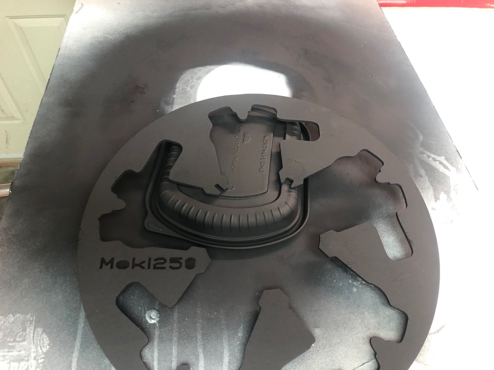

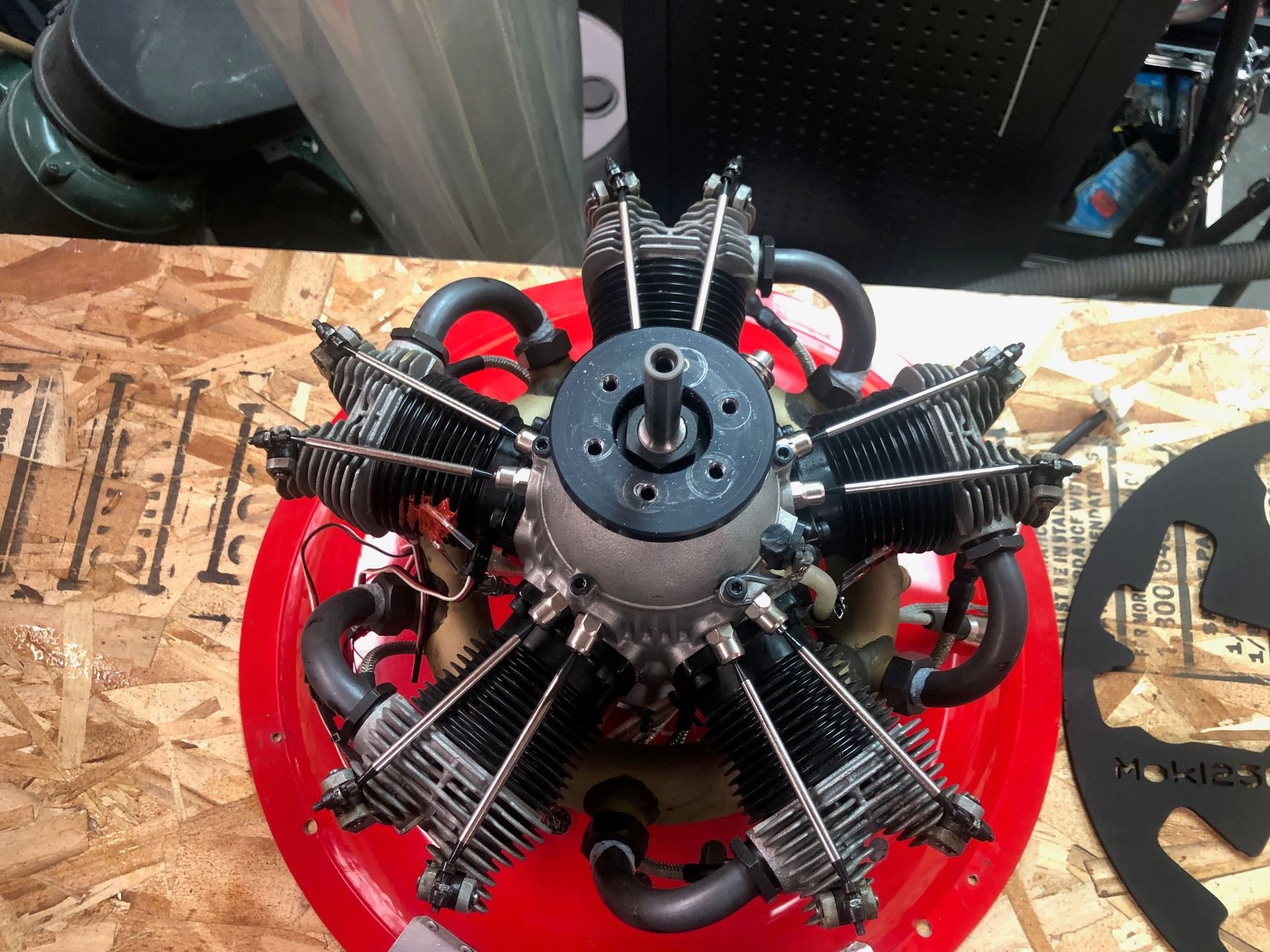

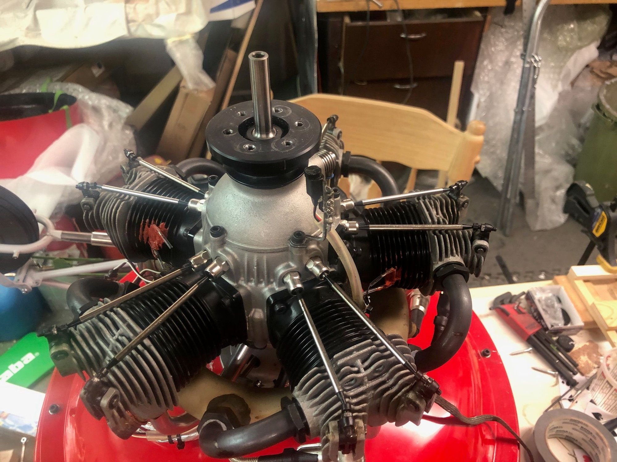

I put the blind nuts in the fuse for the motor dome so that is ready to go. In dry fitting the Moki on the dome, I decided to make a 1/8" aluminum ring that will sit between the engine mount and the dome, to make a good hard surface. Also as I was trying to line things up properly on the dome for the motor, I decided to do the manual recommendation of setting the fuselage on the tail to make sure everything is lining up well. I set the tail on some 1" blue high density foam and have a ratcheting tie down system that is looped to my building bench which seems to make the fuselage fairly steady.
Now with the fuselage set up with the dome installed, the Moki sitting on the dome and the cowl blocked so that it is equal distant around the dome, I seem to be getting a good idea, on how it will work out. The only part about this that is, it's a little funny having to climb up on a step stool to eye everything out, but not the first time I have had to do this airplane construction.
So the way things are lined up right now, the one support ply that is glued into the back of the dome is right in the way of the carburetor flow and mounting bolts, so I am cutting that out partially for now so that I can get the bolt holes prepped and drilled. Once I drill this and am happy with it, I will put new supports in for the dome integrity and some sort of plywood backing for the fasteners at the back of dome.
Pictures of this work.
Baffle getting one coat, two coats, three coats done.
Elevator horns glued in and drying.
Think that will work.
Baffle is dry and ready once the motor and cowl are finalized.
Moki on the dome for the first time.
Looks like the right engine for this plane I think.
Aluminum 1/8" ring to add.

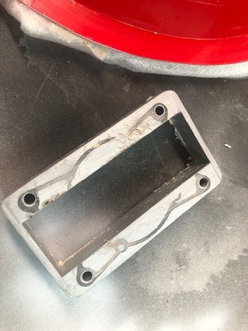

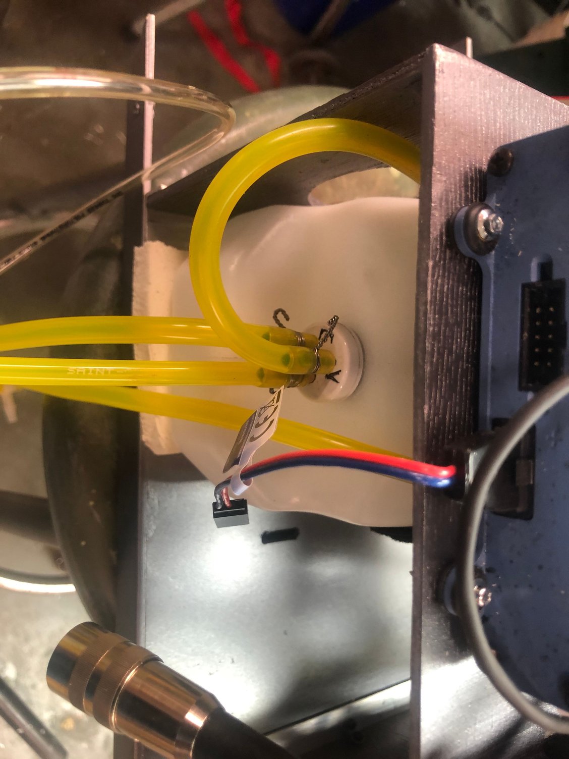

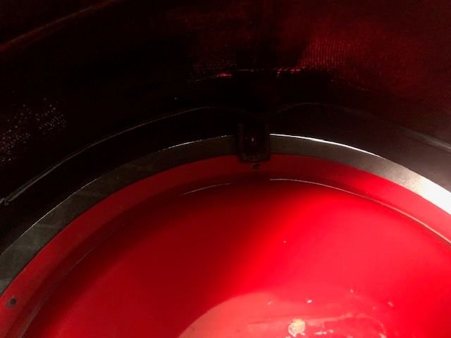

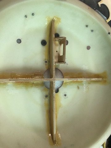

Well update from the last post. As the original supports for the dome interfered with the engine mounts of the Moki, I removed the other one and replaced that one with two others as the reinforcement will be wider apart now because of where the engine mounts go. So the new supports are made of 1/4" ply and are glued in with hysol and milled fibre to make a very substantial joint.
Next needed to get the servos mounts in position for controlling the choke and throttle. These seemed to mount best where they bridged over top of my newly installed dome supports. With the choke servo, to get the proper geometry, I needed the mount to be installed about 45 degrees to the supports.
So the next thing on the list was installing the mounting for the cowl. Looked like this should be done before the baffle, so that all would line up properly. I am using Richards suggested method, of using the fasteners for securing cowl from behind. Good suggestion Richard, as I think this is so much easier then coming from the front. The cowl tabs were made from 1/4" ply and are fastened to the dome with 4mm cowl bolts plus I have some fine #2 counter sunk self tapping screws to secure from the inside of the dome. Seems quit solid at this point. Toying with adding some hysol to these tabs where they contact the dome as well. Will see.
Drilled a hole with my step up bit for the microphone connector for the ignition of the engine which will also be used for the grounding strap of the motor. I have some large grommets for certain installations, so this will added to bush the hole for the integrity of the insulation on the cable.
Other than drilling a hole for the fuel line and that may be it for the dome. I was thinking about dressing up the dome a bit by filling some past installation holes that are not being used with the filling compound of " icing " and giving it a quick shot of PPG Omni base coat/clear coat. What is great here is that the paint code for the Gee Bee red and I think the white too is the same as my Composite Art Tutor, which I already have pretty good paint match with. So will see what I have time for. But before that we need to get the baffle in place that will be installed permanently into the cowl, so that when the cowl is removed everything comes out together.
Here's a few pictures of what was done this time.
Here are the new supports tacked in place with hysol and awaiting a full glue fillet.
Her is a shot from overhead with the cowl tabs positioned into place, before putting on the cowl for the upteened time lining things up.
Servos pushrods and trays are all in place here and seemed to be working well.
In this photo you will also see where I have added 1/4" backing for the 5mm fasteners. Don't want that big Moki shaking around up front.

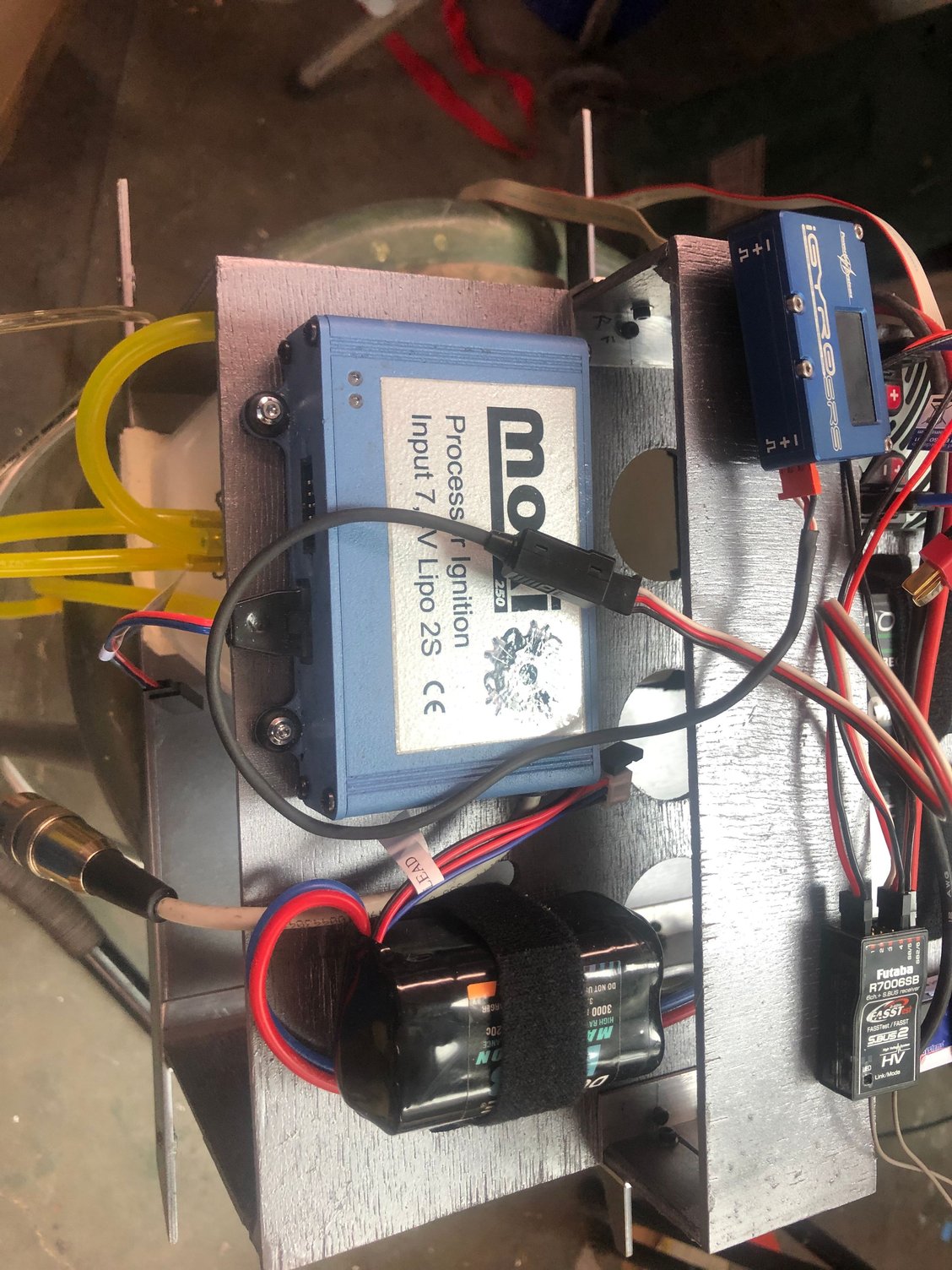

Since reading this thread for about the 4th time, people have been all over the map on gyros with the GB. My basis for using the gyro is for the longevity of the airframe. I will take any flaming for not being a purist about having lighting speed rudder inputs. I know how to use a rudder, I just could be a little faster with my application and from reports I have read the inputs that are needed can be quit abrupt and evasive at times. Who knows that my story and I am sticking with it.
Also spent some time making up servo extensions and installing them in the fuse today.
Next plan on prepping for the wind screen, cockpit area and pilot.
Here's some pics.
Equipment tray preliminary layout.
More components less the fuel pump for now.
Some wiring started.
