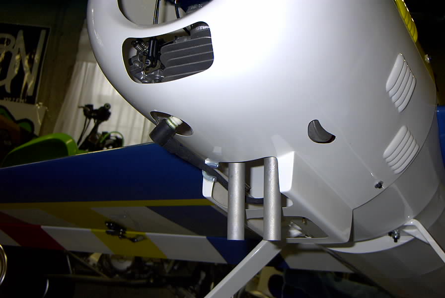

Does anyone have a picture of how they cut their cowling for a slimline pitts muffler ?

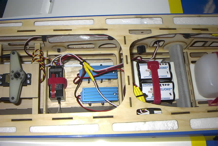

I going to search but just in case does anyone have pics of how the mounted thier Rx and batteries. I'm trying to figure the best way to secure them to the plane. THanks

All depends on how you're balancing. With a stock muffler and the gas tank on the wing tube/CG... here's where my battery is for now. I made a tray with 2 positions available with velcro straps. The tray is glued to the balsa pipe tunnel, just in front of the tank. (right where the cowl and canopy meet.)

ORIGINAL: CHassan
ORIGINAL: flyingcrazy
Old 05-13-2005, 10:49 PM

Thanks for the picture !!!!!!!!! Very nice set up it LOOKS-A-GOOD ! Mine is getting their not much left to do got to get a recever. Money is tight because I just bought a 2.6 comp. YAK ready to fly! IM IN YAK HEAVEN .
