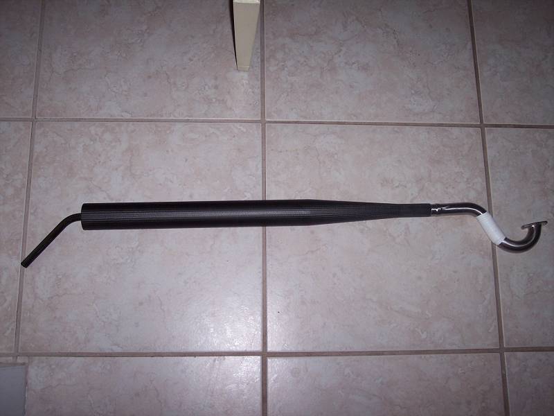

Just got my Ecomposites 50-55cc pipe today. Nice workmanship.
Scale shows 4 1/4 ounces for each the DA 25 MM drop header and also for the Pipe, throw in 3/4 oz for coupler and a mount and it will be close to a 10 oz total pipe setup in my book. I may have to trim the header back an inch or so for my setup.....waiting on an engine and weekend at this point.

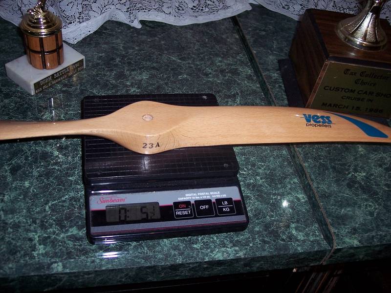

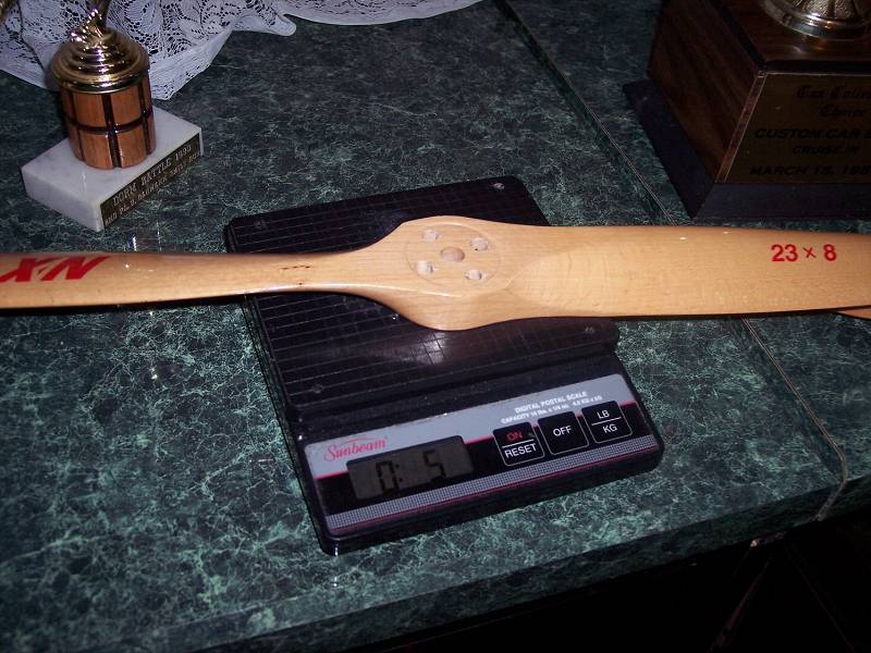

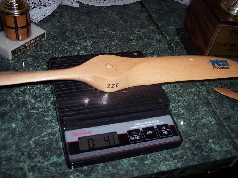

Prop choices... I hope the 60's on pipe rip the snot out of the 23A- maybe even reach out further.
BTW the guys at DA said that the 22C seems to put out the same as the 23A as far as thrust goes.
