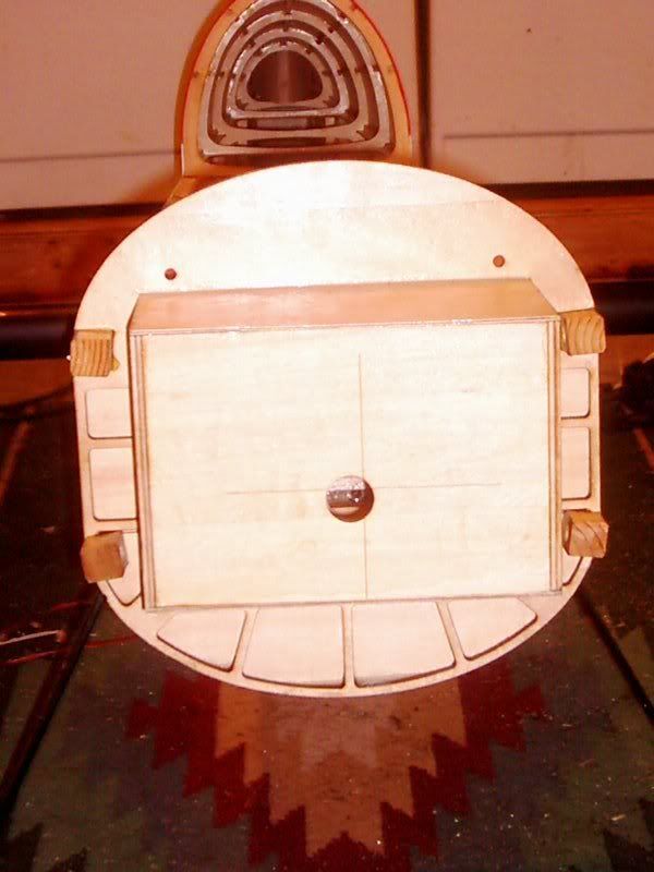

Ok,
I fell into one of these POS Lanier Yak 94" planes. A friend in need sold it to me cheap, with a DA-85 , 8711 servos, Smart-fly , all the crappy hardware changed out ofr Dubro and H9, Jr matchbox on the 4 aileron servos.
He too , tried the Pull pull and abandoned it for a single 8711 on the rudder in the back of the fuse.
I think it is a POS. A throw-away plane for sure. I dislike slab-side Yak wannabes. But, since it is an expendable airframe, I will thrash it totally. Even put smoke in it to help with the early death of it.
It needs an air exit hole in the back, the fuse is pressurizing during flight, and blowing the canopy seams.
Let me restart, I bought it crashed, Rudder counter balance broken off and left elevator counter balance cracked, canopy slightly creased, cowl nicked and CF Mezjlik prop broken .
I beefed the firewall, fixed the rudder and elevator. Re-maidened in 20mph winds last Sunday, with a calm wind flight that evening. It flies great, at 19lb 12oz, it is a rocket on the DA-85 and slimline muffler.
Still , it is a POS slab side Yak wannabe. LOL. But cheap means you can disrespect it, thoroughly.
Now, mine was CG'd slightly behind the 7 1/8 mark , the rearmost CG the manual. Still forward of the center of the tube. It needed 2 click (4 increments) of up elevator trim on my 9303.
My friend was a tail heavy 3D plane nutso. So when I saw that it was this far back , I was worried. But, still , it WAS in front of the center of the tube, so what the hell. It was fine.
I actually stood over the plane with a 1lb lead ignot ready to strap it to the firewall, but was talked out of it , all of us gasser guys looking at it, and saying "what the hell, if it crashes it will be easier to take the equipment out of it!!" LOL.

I quess I feel the way I do about it, because of the slab side fuse, non socketed wings, and the fact someone called it a Yak.
Value priced , yes. I am glad I didn't pay full price. Well, I never would have.
So, irregardless of my dislikes, maybe a few weeks of flying it will make me "Slab Blind".
I mean come-on.....plastic blind nuts holding the elevators, same on the canopy, but that is lighter duty. Cowl blocks that are not flush with the fuse, making it "pinch" when tightnened....is it like that on yours?? Geometery that allows the rudder linkage to hit the elevators at max 3D down elevator?? Loose wing bolts....have you noticed how loosey goosey the threads are? You better drill those Anti-rotation pins, and clevis at least the back ones....unless you trust the wing bolts. Don't forget to check the Anti-rotation pins to make sure they are glued in well...LOL.
Did ANYONE notice the lack of bracing on the firewall?? Anyone? Put any 80cc class motor there without bracing it, and you will have a bad day ,eventually.
The original owner , a modeler for a few years, even noticed the poor quality pin hinges , chucked them and used Robarts. The Chinese ones will get sloppy , so sloppy it is scary, after a season. Look at one compared to a Robart. The pin is what wears and fails.
I don;t like the fact that, if they used a commonly available rear mounted carb motor to design this plane....why did they not close off the fuse from the carb? or at least provide an air exit hole to open up at the rear to de-pressurize the fuse? You better open yours up in back....bad things have been known to happen without proper ventilation. There is NOWHERE for the pressure to leave the cowl....except into your fuse or around your exhaust holes. Nice tight fitting cowl, though. LOL.
Oh yeah, don't forget to seal the wood inside from oil or gas blowback. I am at least going to put a screen in mine, so no loose bits gets sucked into the carb.
All this aside , yeah it is worth 400 bucks...not ever the original price. Want to see what a 700 plane looks like.....go look at an EF. Don't get me wrong, you can't compare coal to diamonds, but with time and muscle you can turn coal into one....I think.
So, if I had to rate this plane....I would say it is a good cheap solid starting point, after applying known gasser modeling tenets to it, throwing the hardware as from the plane as possible, it will last a few seasons. It rates a high 6 to low 7....not really a POS....OK.
But SLAB Sides.....man, it is going to take a long time for me to warm up to it.....Yaks are supposed to round. So, lets call it Yak-54ish.... 'cus it is close , but no cigar.

Thanks Doppel, I may have come off the wrong way on my first post, sorry.
I got a couple of flights in this evening in-between students and maidens of the thier aircraft.
I stand corrected, in the respect that , it flies very well. Neutral, no bad habits.
But, now that I have flown it relatively calm conditions, and the motor is starting to get closer to tuned, I am questioning the CG.
As I stated before, I am at 7 and 1/4 inches from the leading edge, a full 1/8 inch rearward of the rearmost recommended CG. It required up trim, and slightly dives on inverted.
I have not checked the wing incidence and relationship of my thrust line to same. So I can't make a qualified judgement yet. But , it flew so well at this cg , when I expected it to be tail heavy, that I now have more questions than answers.
7 and 1/4 inches puts the CG just forward of the center of the tube. Hmmm.....good thing I got talked out of throwing that 1lb weight on the firewall...LOL.
Time to get out the incidence meter and add to the data. I would caution anyone who would try to fly this bird at the most forward of the recommended spec. It would be very nose heavy, OK if you know about it before takeoff and are ready for some major trim . But, still use caution.
I am going space out the cowl blocks more, and find a creative way to bleed the pressure from the fuse. I would imagine that some of the guys that felt trim seal their wing roots might even make it worse and blow the covering off somewhere.
Take a good look and tell me where the pressure is going,,,,right into the fuse if you have a carb hole. I thought about cutting the louvre holes on the sides of the cowl, also. At any rate, something has to be done, IMO.
What wheels are you guys using??...the KAVANS that my friend put on it just squish flat, and one even rolled out of its pinch hub.
Ok, for now, it stays in the "at the ready" position in the van. I will call this one my Value Packed Yak....hey ,that ryhmes.

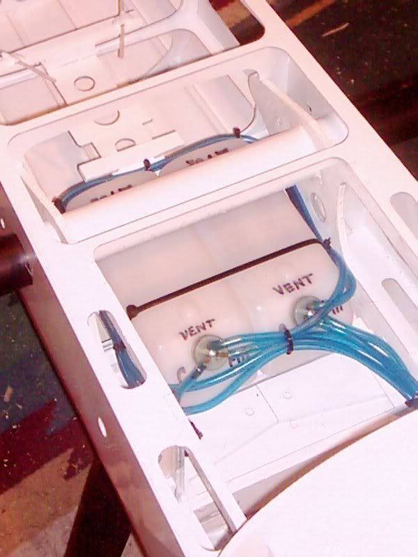

Hey Bosshossv8 ,
I am not sure how large the carb hole is in your firewall, but the stock one in mine is only about 1" .
By the time I pass my fuel line, smoke line, fuel vent line, smoke vent line, and any wires through the hole is should be at least half full.

As far as I am on mine is, I made a nice tray for the gas and smoke tanks.
They are mounted right under the wing tube.
Two 24 oz. tanks

No standoffs on the DA-85, use a plywood spacer. Mine came with standoffs and I have to change them to a ply spacer. THe standoffs reportedly can twist the case, or contribute to it.
That really is'nt much of a carb hole. The DA-85 carb would not fit throught it. Mine carb needles are right at the edge of the firewall with the carb into the box about a 1/4 inch.
Of course, I dont know the recommended spec distance.
My canopy just about blew off, tonite. I was 1/2 throttle flat spinning it upright. When I came down, canopy was blown out in one place, again, it looked like fuse had bowed and broke a bit by the canopy screw holes, almost pulling one through. And the top of canopy wood was cracked .
I am just going open up some of the back of the fuse, for peace of mind.
I need very very little rudder, maybe 11 deg (quess) for 90deg KE at mid throttle, a hint of reverse aileron. I am going to go farther back on the CG. Farther than 7.25 inches. Maybe to mid-tube exactly or slight behind center of tube.
I Gooped my KAVANS to the hubs and they are fine in the grass now.

Listen , one other thing about this bird and the 85. Absolutely everything is being shake tested on this yak from the wheel pants (plastic blind nuts) to every joint on the nose. And The 85 is WAY overpowered for this bird. IMO.
A smoother twin would be the ticket. Not neccesarily a 100, a smaller one would be fine.
I am running a Menz 26 x10 and I think the 85 would have a softer power curve or more manageable thrust with the Mejzlik 27x10 TH or thin series peops. This full chord Menz just bites so hard that slow speed throttle resolution is very very touchy(tight). Breath on the throttle, and it is moving fast. And I have a pretty good curve dialed in.
The TH prop might widen the slow speed RPM management. IMO. When I can get my hands on one I will try it, and post.
The 85 is an awesome motor and I looking forward to putting it on my scratch built 35% DR-109 after I am done with it on this frame. I would like to fully break in the motor on this bird , these motors get better with age, and then put her on my scratch built baby (DR-109).
Hell, I bet this bird would be fine with RCIGN modded G-62, at least for sport flying. The 85 is just soooooo overkill. And that is fun , too. WOT vertical spinning at full rate, it looks like a top you just pulled the string on.

Did some more on the Yak today.
Still waiting for stuff to come in, plus I am doing another plane project at the same time.
Fuel proofed everything in white.
24oz. fuel and smoke tanks on a custom mount under the wing tube.
Lines done, just need to put Skywriter in and put that line through the fire wall.
Fuel and smoke fillers are in.
Mount for Smartfly and antena tube mount for FASST system.
