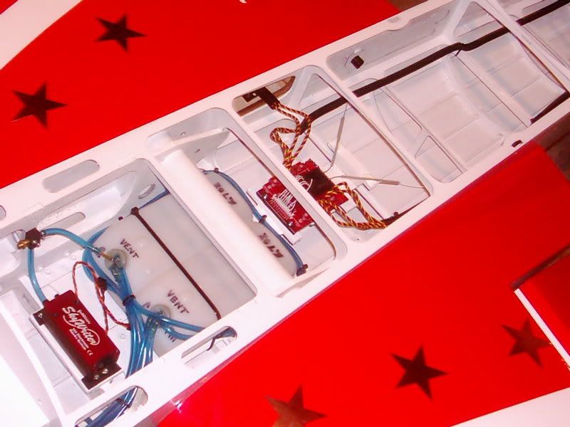

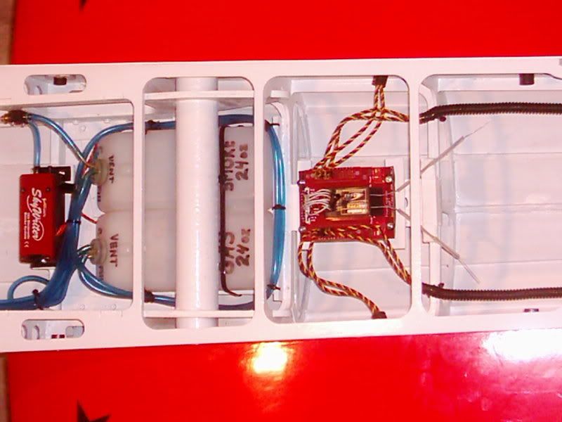

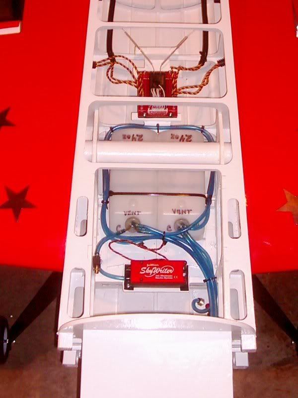

Well, UPS & Fed-Ex showed up today and I have all my goodies.
The only thing now is the DL-100, which I got a Fed-Ex tracking number, so it's on the way.
Tonight I mounted the skywriter smoke pump, the Smartfly power expander, Futaba R617FS FASST RX, wing servos, and the tail servos.
Wing servos are Hitec HS-5645MG, all four in the tail are Hitec HS-5955TG, and all extensions are Hitec heavy duty twisted.
Two batteries for the RX, they are the new Spektrum 6V 2700mah Nimh packs.
Switches are EMS Heavy Duty.
I have not done anything with the batteries and switches till I get the engine.
Once I get the engine mounted, I will play with battery location for balance.
I am trying to figure out where to mount my switches.
I am running four of them, three EMS ( two RX and one ignition ) and a standard for the smoke system battery.
Where do you guys have yours mounted?

Robinhood, man, that looks like an Ivory Palace in that bird. Absolutely gorgeous.
One thing is for sure, if you have any blowback, or smoke oil mishaps , clean up will be a breeze. Wow.
My bird was not initially bult by me, but my one Pin switch is above the wing mid-chord in one of the voids. The ignition switch, a JR HD Charge SW, is mounted on the cowl, again not my choice.
I prefer one switch for the whole plane. One Pin-flag switch , soft reg shutdown.
