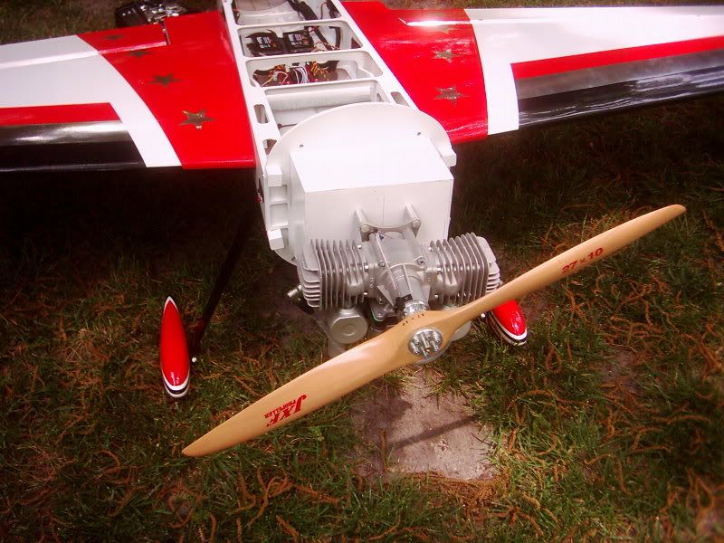

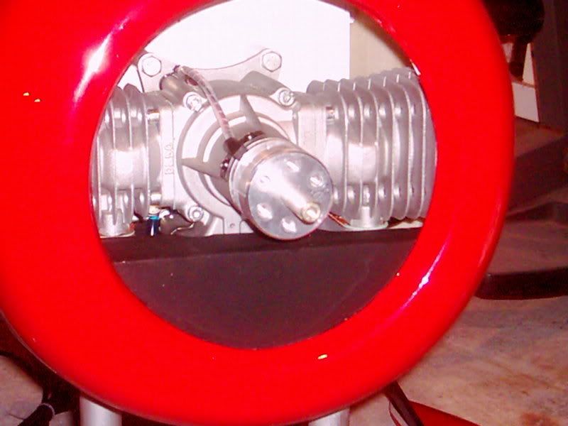

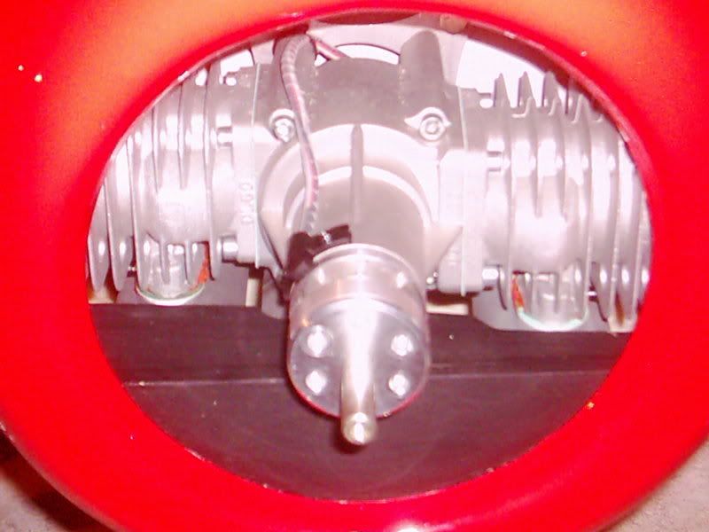

2robinhood
2robinhood's Avatar
Join Date: Aug 2006
Location: Egg Harbor City, NJ
Posts: 760
Default RE: Lanier 94" Yak help
ORIGINAL: RAMMJETT
hy guys been gone for a while flying.to baffle the cowl i just blocked the botton half of the opening in the front of the cowl.and made a decent hole in the bottom .i run the da 100 and on a new motor dont get over 180 .actually i ran with no baffle and had no problem but the guys buged me till i put baffles in. i juess it is a good idea but dont worry about getting to fancy it cools good anyhoo
Can you post a few pictureS of you baffleing? I have mine bottom baffled, but I am haveing a real hard time trying to do something on top, since you can't slip the cowl on over the mufflers with top baffles.
I have a DL-100 in mine.
Here are a few pictures of mine.

Posts: 655
Robinhood, your baffling looks extremely close to mine, .. you must have used the ice bins I mentioned . What did you use to glue them in? I was told by a local guy to use Goop ... and that was the worst advice I've had in a long while. After getting them just like I wanted them, I glued them in .. then next day I tapped on it as a strength test ... and they both just fell right out! Now I have to start all over and re-paint them again before using some other adhesive. What did you use? By the way I made a top half and a bottom half and trimmed them to fit around the fins as you did.

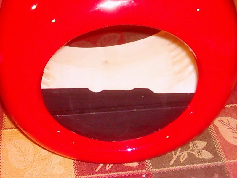

2robinhood
2robinhood's Avatar
Join Date: Aug 2006
Posts: 760
ORIGINAL: Mitsu1
I made mine from 1/4 Balsa and fiberglassed it in the cowl.
I had a top baffle made and it had a removable middle so that I could clear the prop shafts for putting the cowl on, but there was no way to make it work.
I may make a top baffle like the bottom one, slip it through the opening after the cowl is on and have a few bolts going into blind nuts hold it on.
I would hate to see bolt heads on the face of the cowl, but we'll see what I can do.
Maybe i'll just leave the bottom baffle only.
I want to try to get in the air on Saturday.

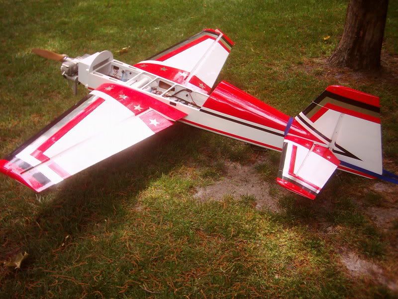

2robinhood
2robinhood's Avatar
Join Date: Aug 2006
Posts: 760
ORIGINAL: Doppelganger
2robinhood. Please tell me exactly what you used to fuel proof your Yak. Also where you bought it. That Yak of yours is beautiful. Will you be able to video your maiden? Just finished hinging mine. Hoe to fly it in a few weeks.
Steve
I used white epoxy spray paint. You can get it anywhere that sells paint.
Just don't go crazy, because you can ad weight easily.
I weighted the can when it was new and again after I was finished.
I did the engine box, inside of fuse, and as far as I could spray inside towards the tail.
When I was finished I had sprayed 7.5 oz of actual weight, but that may have ended up less as the paint dries and cures.
I think the weight gain is worth the fuel protection and the look is awsome.
I have only seen the epoxy paints in black, white, and almond.
I also use black on my other plane.
Yes I plan to video the maiden, if I get it finished for Saturday.
My real close wight is about 26 lbs 4 oz.
Thats with complete smoker system, smartfly, DL-100, two 24 oz. tanks, four batteries ( two 6V RX @ 2700mah, one 6V 1650mah smoke, one 4.8V 2500 mah ignition ), aluminum spinner, HS-5955TG's, HS-5645MG, etc, etc.
I think I could have been around 24 - 25 lbs without the smoke system.
BUT, you gotta have smoke............................................. ............

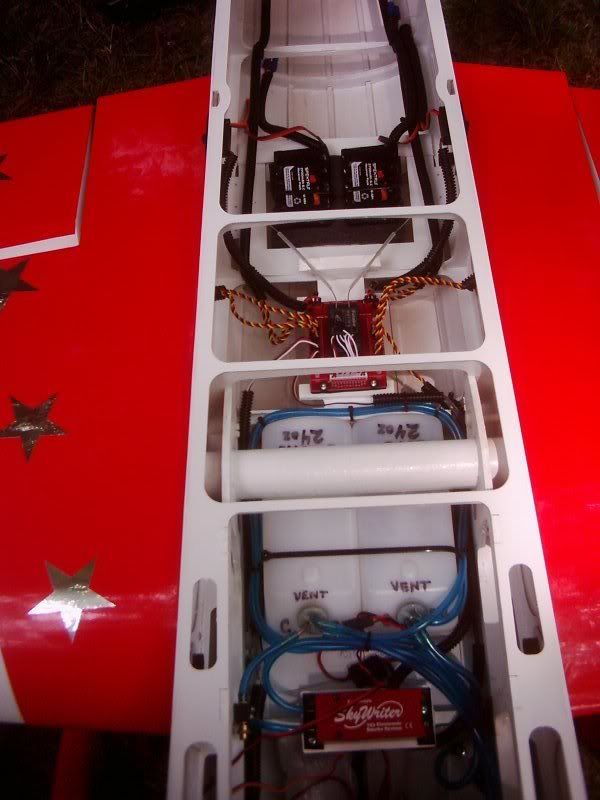

what is the best way to set up the fuel lines. I have seen that some people are wraping the fuel tubing around the tank a couple times? is that needed and why. I also Large Scale Kwik-Fill Fueling Valve is this ok link it directly from the tank to the carb. Some guys have been pinching off the valve that would go to the carb. Is this because they dont trust the valve? Thank!
Old 06-20-2008, 11:42 AM
  #449
aaxiss
aaxiss's Avatar
Join Date: Dec 2006
Location: Orange, CA
Posts: 194
ok .. you can either set up a 2 line tank or a 3 line tank......
2 line tank as follows ..
1st line from tank with klunk on it to a tee, from there one side goes to engine and one to fuel dot. not sure about your kwic filler thing . if it has 2 lines going to it then you may not need a tee.
2nd line in a 2 line tank is vent line. tube just inside neck of tank to highest point in tank to vent overflow. vent line should exit though bottom of plane somewhere in front of the gear just behind the cowl. Wrap this line around fuel tank above fuel level to keep fuel from siphoning out if you tip plane forward and also on long downlines.
3 line tank..
1 st line from main klunk to engine
2nd line from secondary klunk or brass tubing to low spot in tank to facilitate fueling and defueling. this line to fuel dot.
3rd line is vent line same as above
hope this helps
